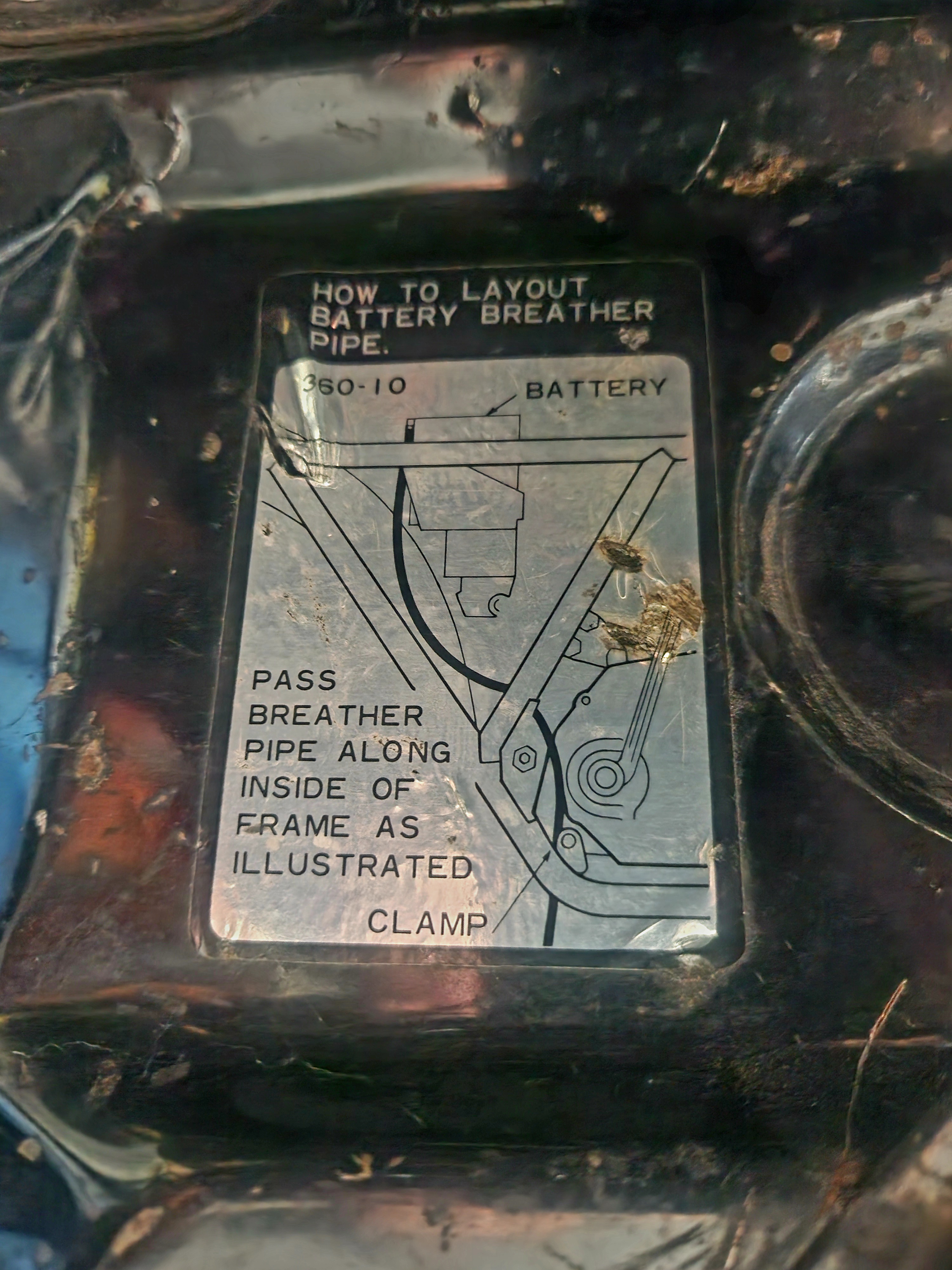

Lifted up the seat and noticed this. Of all the seats I looked at online to buy. I never saw this sticker.
It tells you how to route the battery breather tube.

The sticker on the seat pan was common on most motorcycles in the lead acid battery days. A nice find for a restoration as every original sticker counts as does the original seat pan and upholstery.
