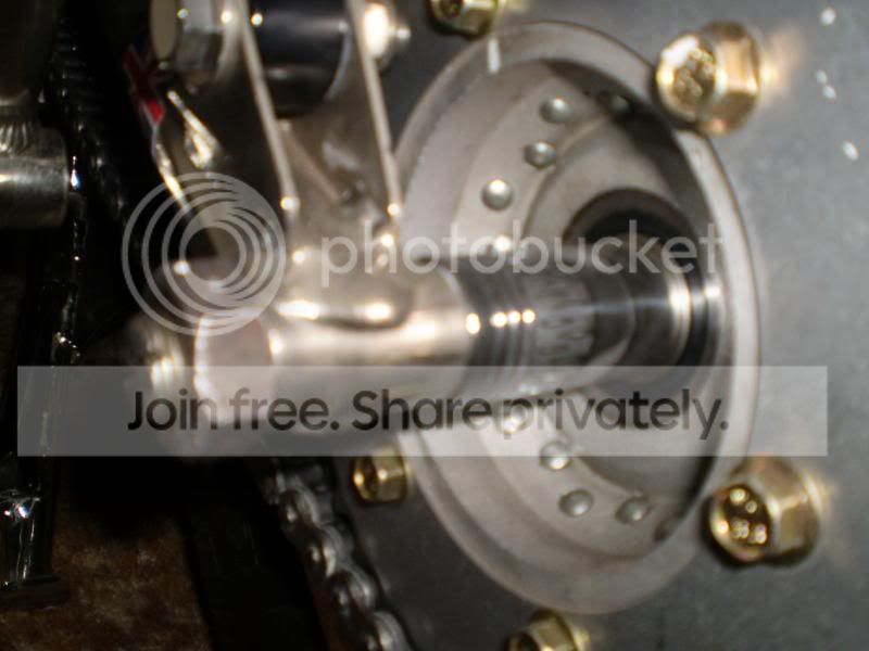

The hubs look like Talon hubs, but could be wrong, they wee popular back in the late seventies / eighties for custom builds in the UK, assuming that's where they were sourced from.

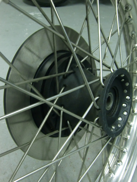

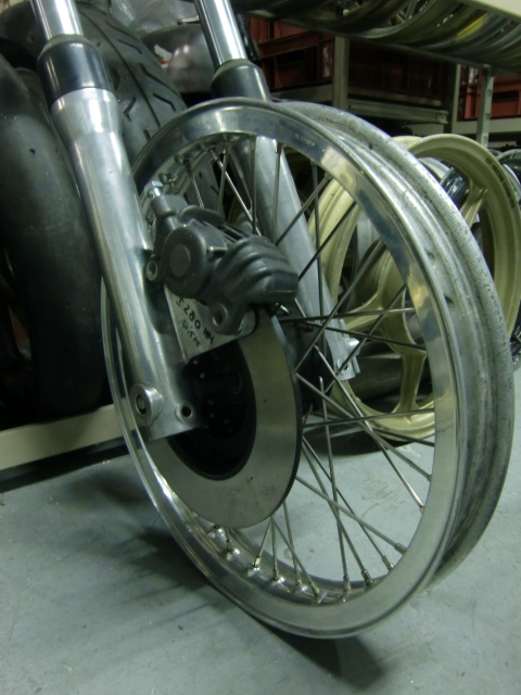

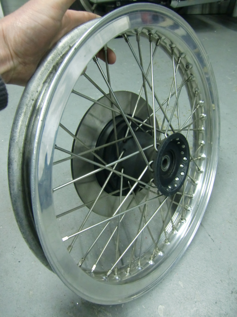

I do have some original parts, shoot some photo's for you for a better view on them. Front hub is like the rear with single mounting flange, this front hub looks to be magnesium, they are also made in aloy like the rear hub. they are also m a. Forks are 38mm Betor.
Seen this ?: http://home.base.be/racinjan1204/rickman/rickman_home.htm Parts for sale + info on rickman cr
Rear wheel:
front wheel:
front end:
This is an extremely cool project. I never realized that they make a longer version of the steel tank/glass cover. I have a setup like this myself with the shorter tank and 2-up seat that I acquired for a CB750 project. I am doing a recreation of the Rickman CR but with my own twist and lots of one-off parts. I have been posting pretty heavily over on the SOHC 4 Honda forum, and will be moving my thread over here soon.
I look forward to more updates!!
Rear wheel:
Oh wow... I don't suppose that rear wheel is for sale, is it??? If only the front were a dual disc.... beautiful hubs. And rims. I wonder if the bolt pattern for the rear rotor is the same as the one I have here on this rear Morris mag?
