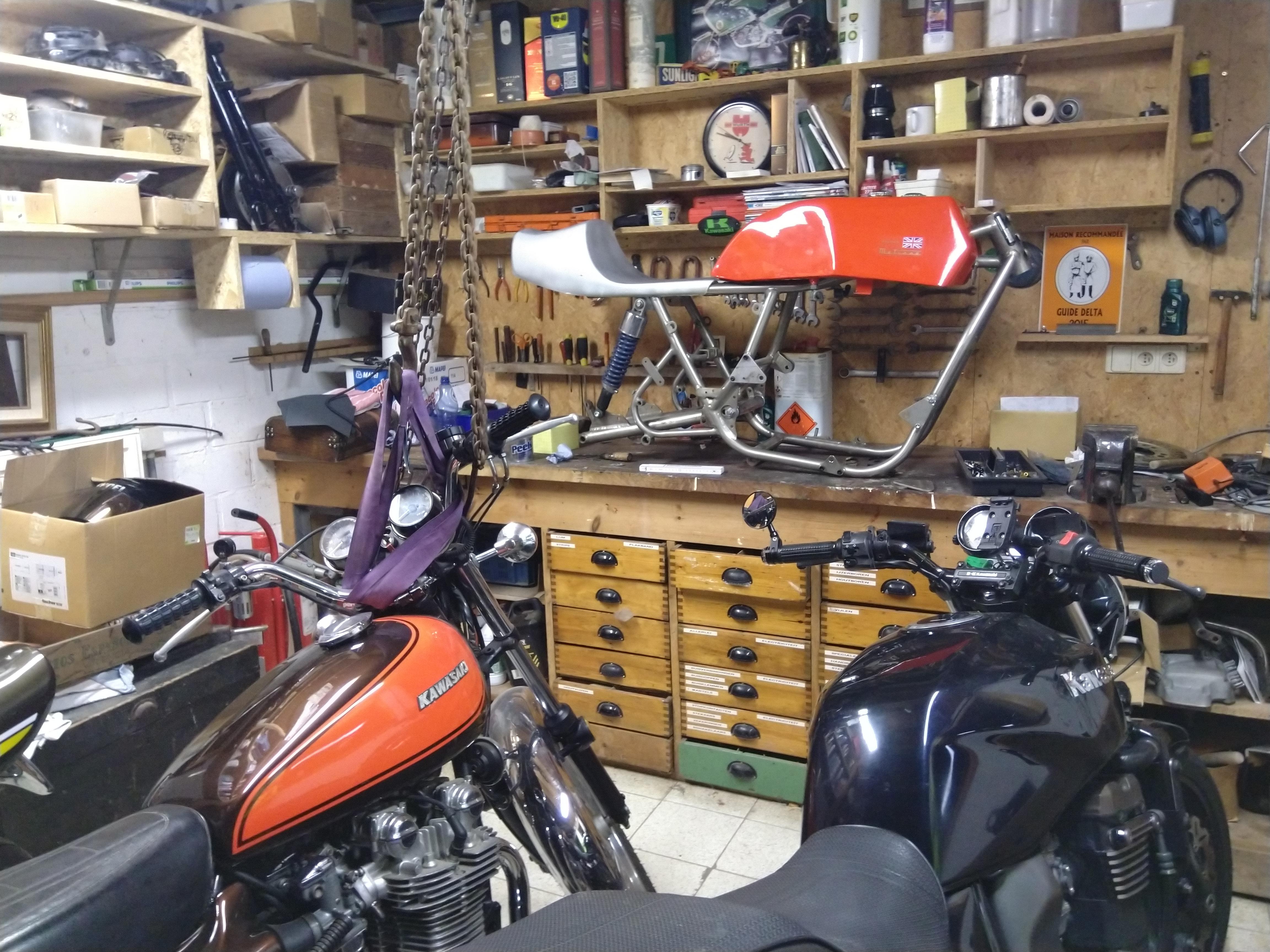

hi chuck,
i m reading this with interest,
am in the proces of about the same as you do but with a kawasaki engine
what length are the shocks you use?
in the front i'm going for a zrx750 fork and the wheels will be spoked with alu rims
thanks
Nice lookin' Ricky on the bench!
I had 2 sets of high end 360mm shocks to use on the Rickman, slightly shorter may be a little more advised with concerns to chain tension (swingarm angle), but I was trying to reduce rake and trail as much as possible, as the frame is designed for a very short fork with very large offset in the triples, and wasn't exactly a really quick steering bike stock even.
