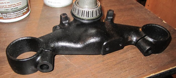

I got hold of some *decent* CB500 forks and ground out the triples then added tapered bearings. The shorter sliders on the CBforks (rather than the looong XS650 pogos) will allow a few inches of travel still so that's good.
Details here: http://swaggeringpagan.blogspot.com/2013/01/devil-in-details-pt1.html
