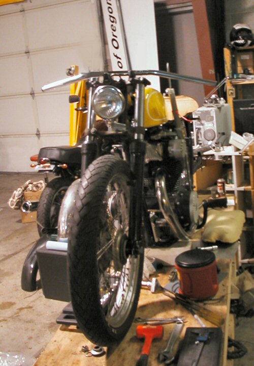

I also got my front end lined up, though at the moment is doesn't look like much, from the $25 XS650:
It's a little tough to visualize as it stands, but the plan is to turn the sliders smooth on the lathe and sandblast them to match the other bits on the bike. I have a nice new alloy 21" hoops and fresh stainless spokes for the hub. I have a plan for the caliper mount that I learned from Tony Foale that's more of a performance mod system but will lend a little visual excitement to the front end.....but that's for later.
