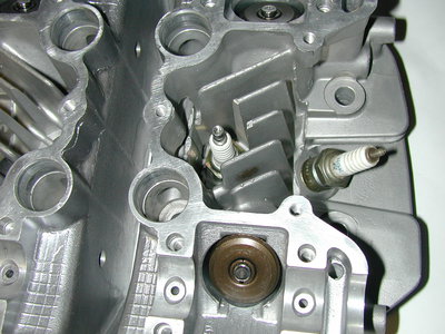

Work is progressing with the twin plug head conversions - the jig is made [ machine shop ]. I am debating whether to use 10mm or 14mm fo the second plug. Either way the conversions I've seen done so far have left the thread exposed where it follows into the combustion chamber contour - in my view risking a local hot spot .... especially with NOS / Turbo !

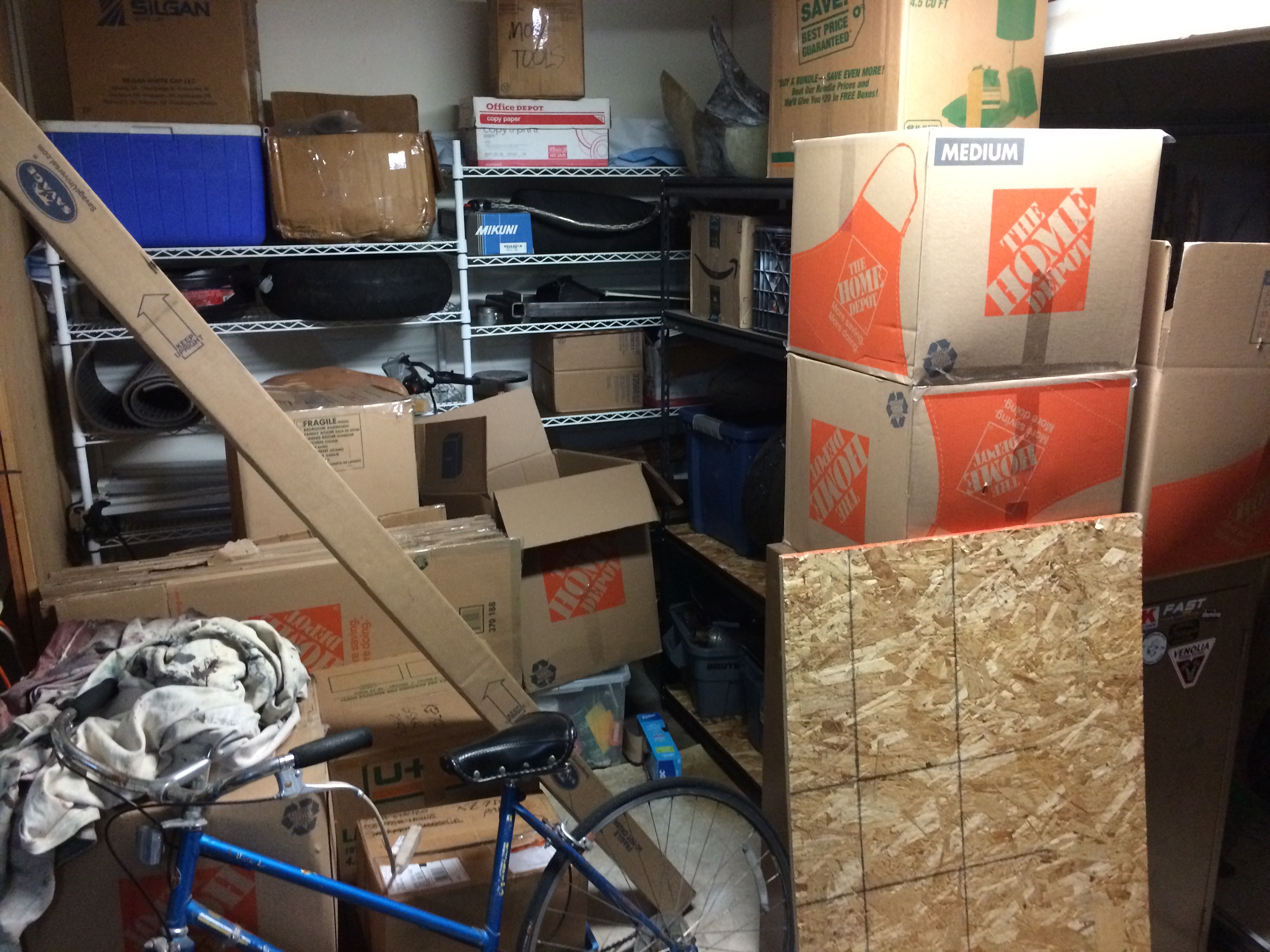

Man you keep getting me at the worst times. I just moved at the beginning of the month to a new two car garage. Everything is still packed up at the moment. Its gonna be a second until I can locate the parts. I do remember that the bolts I did not use from their kit were the shortest ones. hopefully i will have a chance this weekend and dig through my boxes of parts
