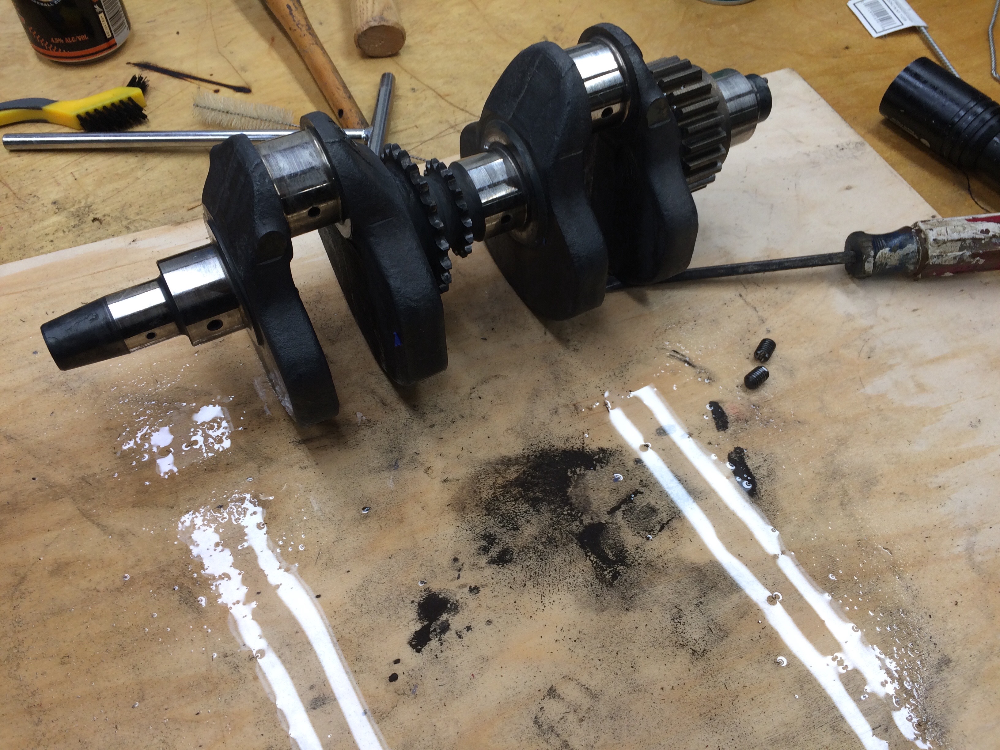

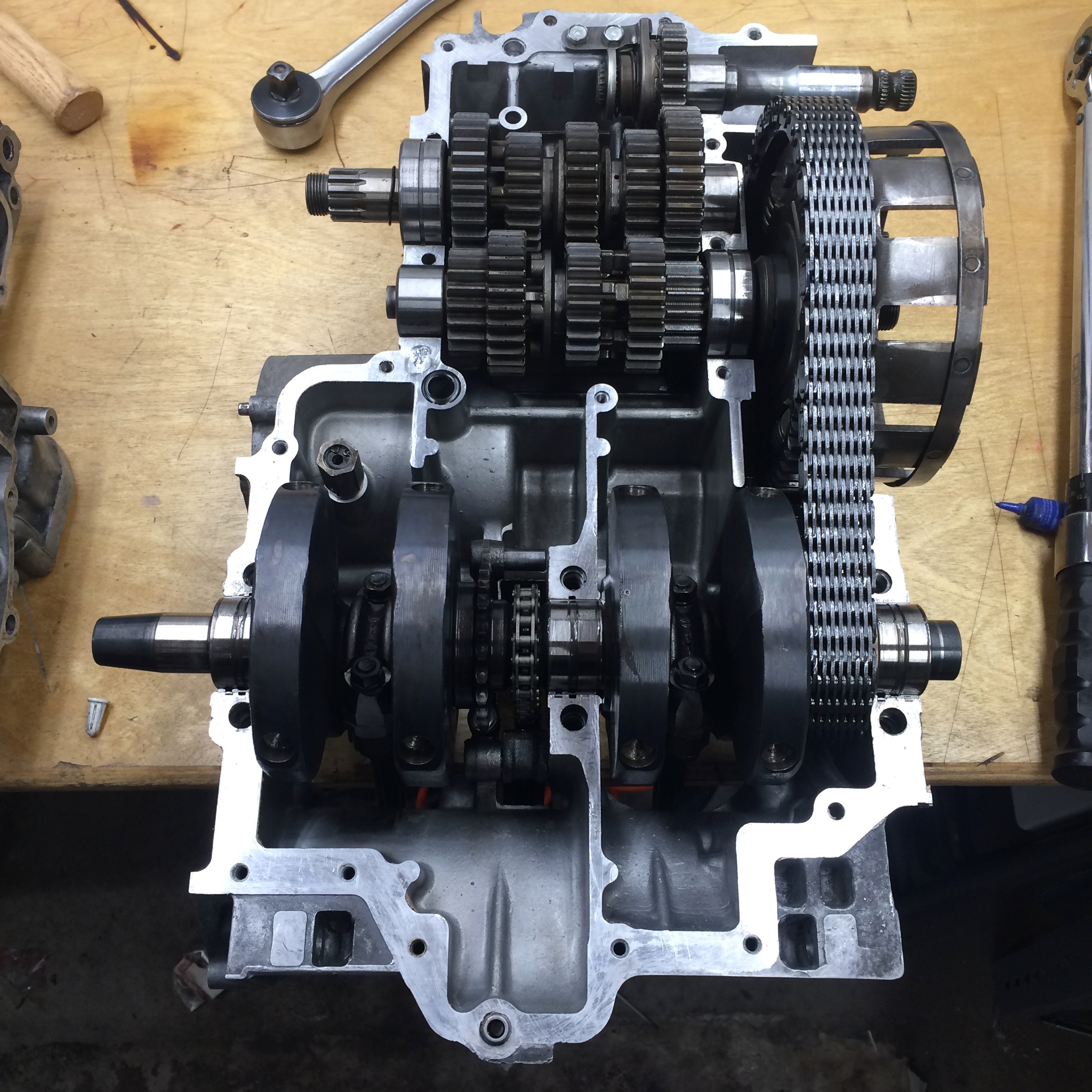

getting a move on this. Engine is going back together! I sent the whole crank/piston assembly out to be balanced, and i thought they would remove the crank oil gallery plugs and clean them but they did not. I cleaned them as well as i could without removing the plugs, then got a nagging feeling and decided to dremel out the plug screws. Im glad I did because all that black shit was in the crank oil gallerys still. I didnt have a good punch to stake the gallery plugs with so my buddy suggested i tack the screws in with silicon bronze. The bottom end is assembled with new bearings, new cam chain. I honed the small end of the connecting rods with a 320grit brush hone to remove the glaze. they haave a nice cross-hatch now. It specfically says in the manual "DO NOT REUSE CONNECTING ROD BOLTS" but after talking to the dudes at Falicon Cranks they said it would be fine. I'm waiting on a buret so I can measure the piston dome of these custom pistons so I can determine the new compression ratio.

Wow so nice and so clean.
That little ball hone is the shit.
I did some searching and wasn't able to come up w one for my 400f about 2".
Flex hone has pretty much any size you could need. i did a quick search and loads of 2" brush hones showed up on amazon

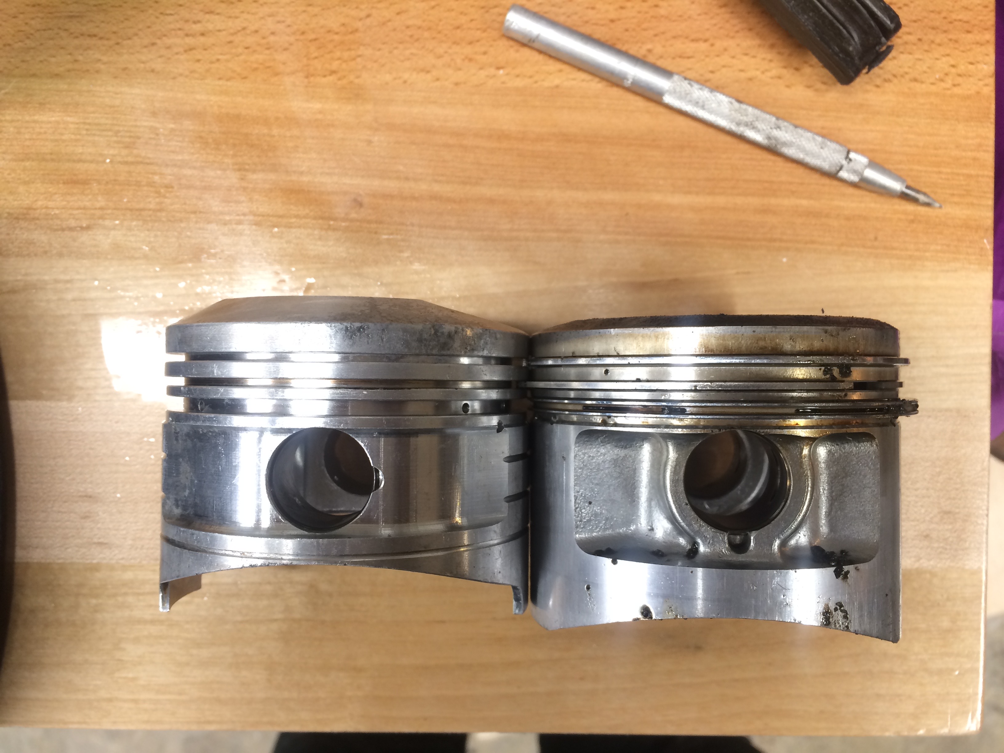

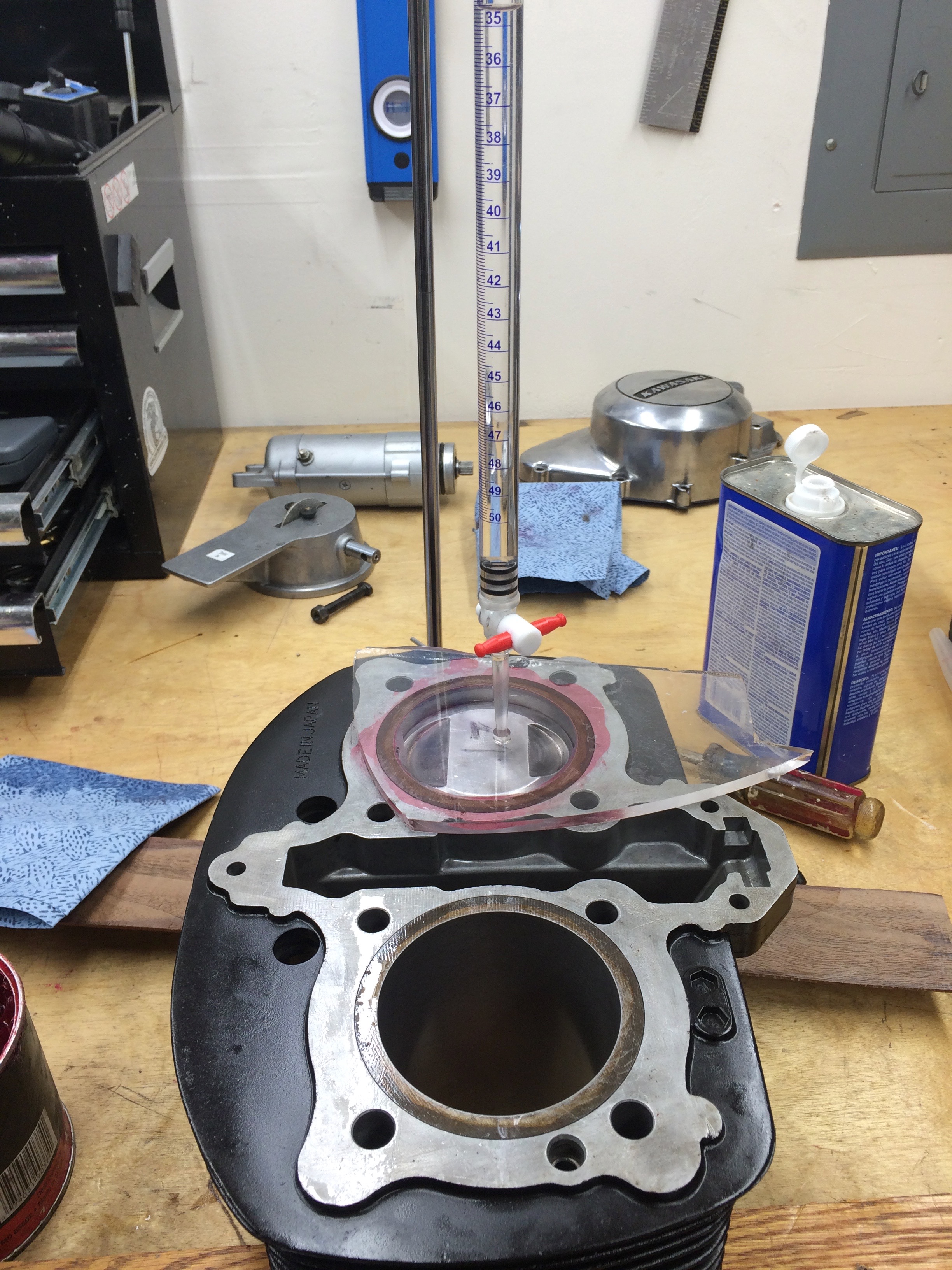

I assembled the new pistons, and did a dry install of the top end. I now have all the figures to calculate compression ratio. I also stuck clay on the pistons to see how much room i have. I have a few questions for the engine gurus on here.
The combustion chambers were not exactly the same size, one was 53.9cc and the other was 53.2cc. stock is supposed to be 50.9-52.1 I had a valve job done so I'm assuming that is why its bigger. Is it worth the trouble of trying to make them the same?
Assuming 53.9cc for the combustion chamber I am at about 8.9/1 compression ratio. I would like to be closer to 10.25/1. There is about 0.090" clearance from the piston to the combustion chamber, so there is ample room to deck the head.
if the combustion chamber were a cylinder I would have to remove about .060" to get the combustion chamber small enough, but its hemi-spherical so even more would need to be removed to hit the mark. That seems like a lot to remove off the head. If I remove .040" it will be pretty much cutting into the cooling fins. At .080" the intake valve would get hit.
My new pistons have a squish band on them I'm wondering if I should instead fill in the combustion chamber and machine it back to give the head a proper squish band, this would not only help me reach my combustion chamber size goal, but a proper squish band will make the engine more efficient, with a "bath-tub" style combustion chamber. Or should I just deck as much off the head as possible? I could also deck the cylinders to bring the piston to zero deck height. That is much easier at this point since the head is assembled.
Thoughts?

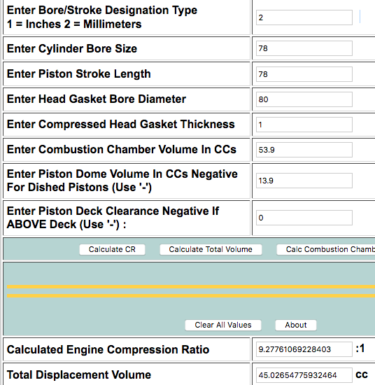

I double checked all my measurements and I realized when I measured the deck height I forgot to torque the cylinders down, so I measured incorrectly. The pistons are actually at zero deck height. Updated numbers are below, now at 9.27/1. This is better, but still makes it a ways to go.
Just to clarify the squish gap is currently .090" I think i would be removing .050-.060" from the head. the stock combustion chamber has no squish band but the new piston does.

My calculations are what ever it takes to remove 4.7cc.
372.7cc + 45cc = 417.7cc / 45cc = 9.28/1
372.7cc = 40.3cc = 413 / 40.3 = 10.248/1
What is the diameter of the chamber at the deck surface?
And at .050 below the deck?
You could also fill the chamber with 54.2cc {40.3 + 13.9} and measure the depth.
thanks for that. Ive never done anything like this before so sometimes I need a kick in the brain.
Its tough to estimate because the chamber is not round. Its about 77mm front to back and 80mm side to side. Average that and say the combustion diameter is 78.5. At .050" below deck its about 76mm so using that to calculate the area of a truncated cone should mean removing .050" from the deck height should reduce the combustion chamber about 5.9cc. If i decked it at .040" that would reduce the combustion chamber (in theory) about 4.7cc
That still makes me worried about the squish because there is such a huge gap there. I was reading that ideal squish should be in the .030-.035" range. is that correct? it's currently at about .090" so squish will be a little over .050" after the .040" deck. Does it make sense to do .050" deck and then open up the combustion chamber a bit so the squish is closer to ideal? I don't think I can safely remove more than .050" with out getting too close to the intake valve. As it is decking it will cut into the valve seat.

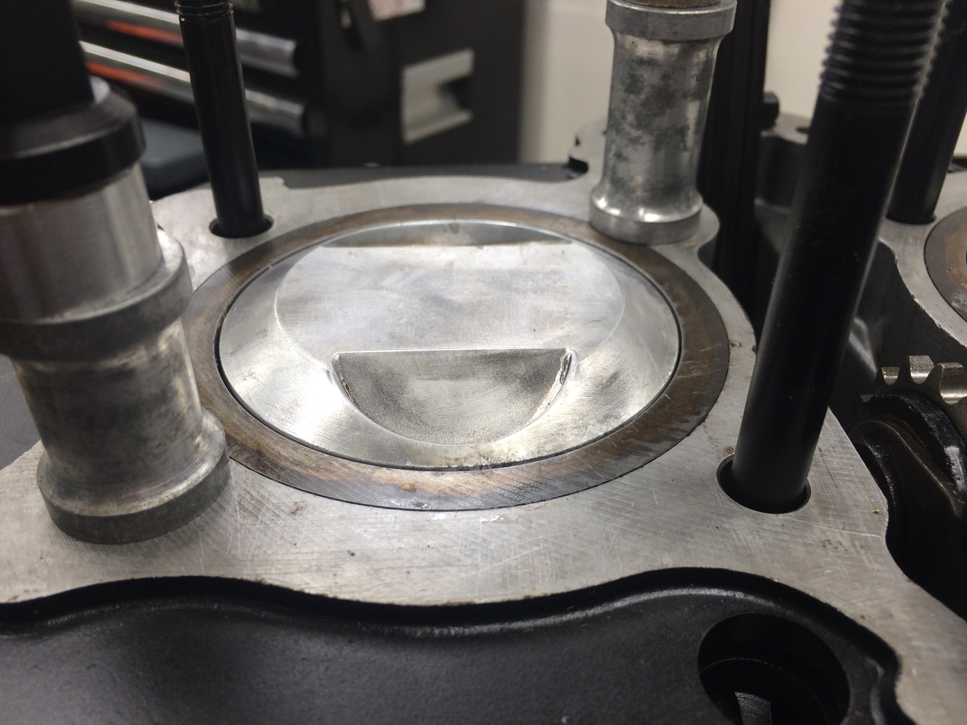

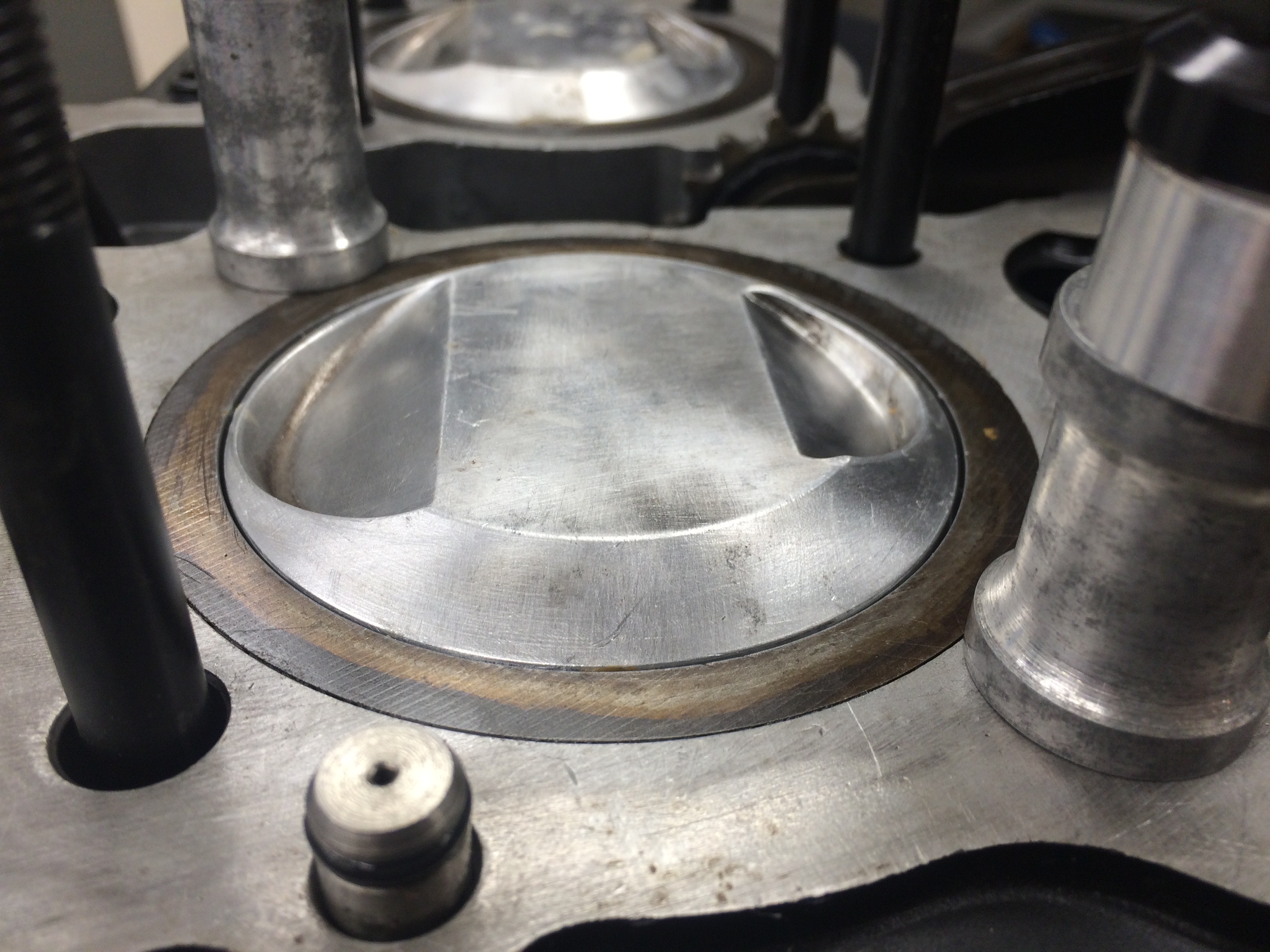

That intake valve looks awfully close to the edge of the chamber.
If it were me , I would see if the head would bolt down flat without
a gasket. If that checked out I would know clearance anywhere in the
chamber is at least the thickness of the gasket. Then I'd reclay both
pistons on both sides and over the valve reliefs. It's better to measure
twice [or more] and cut once. The thickness of the clay will give a good
visual reference to what can be done.

I double checked with clay. it seems like it will work. the intake valve will be close but I think it will fit. I dropped the head off today to take .050" off. Fingers crossed!
