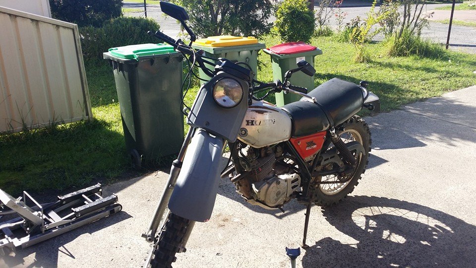

So I picked up a '79 and a '81 XL250S for a song and a dance, and both of them need a bit of work. Deepwaterimports bought the one that needs the most work from me and left me with this technologically advanced work of motorcycling mystery.
At this point it's purpose is to become road registered ASAP and then I'll resume work on my CB900, and progress will slow on this.

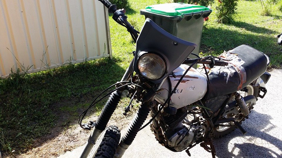

Ultimately though it will be completed as a home built tracker, with as little professional assistance as possible. So far I've gotten most of the way converting it to 12 volt (although there are some electrical difficulties as detailed in another thread
http://www.dotheton.com/forum/index.php?topic=60043.msg679972#msg679972
Awkward moment when you realise the front headlight surround is on upside-down, whoops!!!

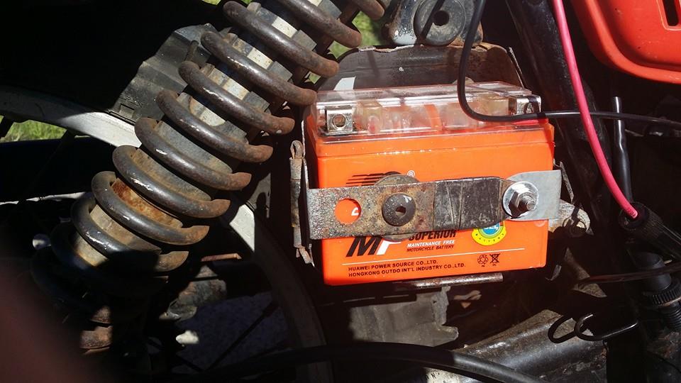

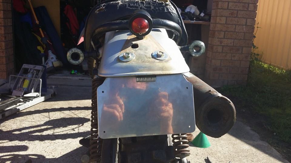

Just got her back after a quick bit of work completed by Adam at Rebel Restorers up here on the central coast - just rewelded the bracket on the exhaust so that it actually lined up with the bracket on the frame, and made a slightly larger battery box to fit the 12V battery. Unfortunately on the way home the screws that hold the little terminals on the battery in rattled loose (they were not tightened) and are now MIA - I'll have to find some replacement items.

progress! After some wiring wizardry (i.e. Fuck you headlight you can have hard wired power, little bitch) all the electrics, except for the horn (which I will not hard wire to power lol) are working!!
I even wired up a little numberplate light :) Also see here some of the metal work completed by Rebel Restorers in the way of a larger battery box and a numberplate bracket. I did ask them for cheap and nasty as much as possible so they may not look fantastic but they do the job :)

My bike is missing the battery box, tail light and plate bracket, I like what you did with yours. May have to attempt something similar.
