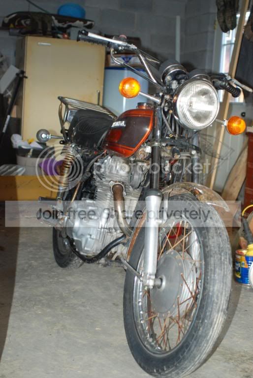

This is the start of my project. The first phase will be to make some changes and hopefully ride the thing this summer. Then, next winter I'll take er down to bare bones and make it like new again. I should have a few more funds and more time next year. So right now I don't consider this a very big project. I'm currently looking for a new tank and a cafe seat. Also, I would like some clip ons. I'm not going to run mufflers. I plan to weld some extension pipes and they'll be wrapped with fiberglass. I also need to order some head light ears, but first I need a new headlight bucket. Things are going to go slow for a while. I probably won't do too much until after the first of the year. This will be my first attempt at photos.

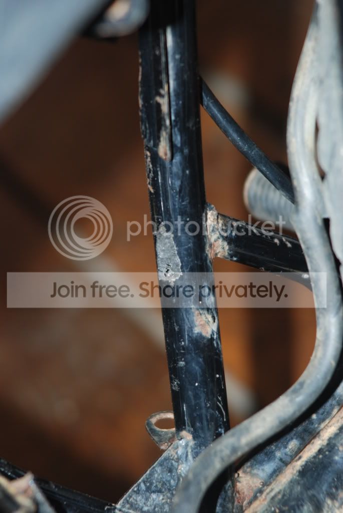

Well, this is my first F-up. I cut into the frame. LOL... I'm pretty good at closing holes however.

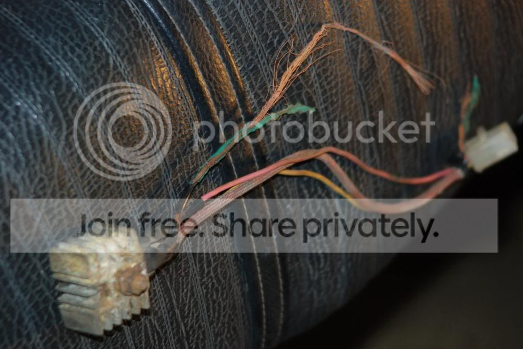

And here is a bit of molestation by the PO. Thank god he didn't have the bike too long! This is the only bit of wiring he fixed that I can find. everything else is still in the factory loom.
