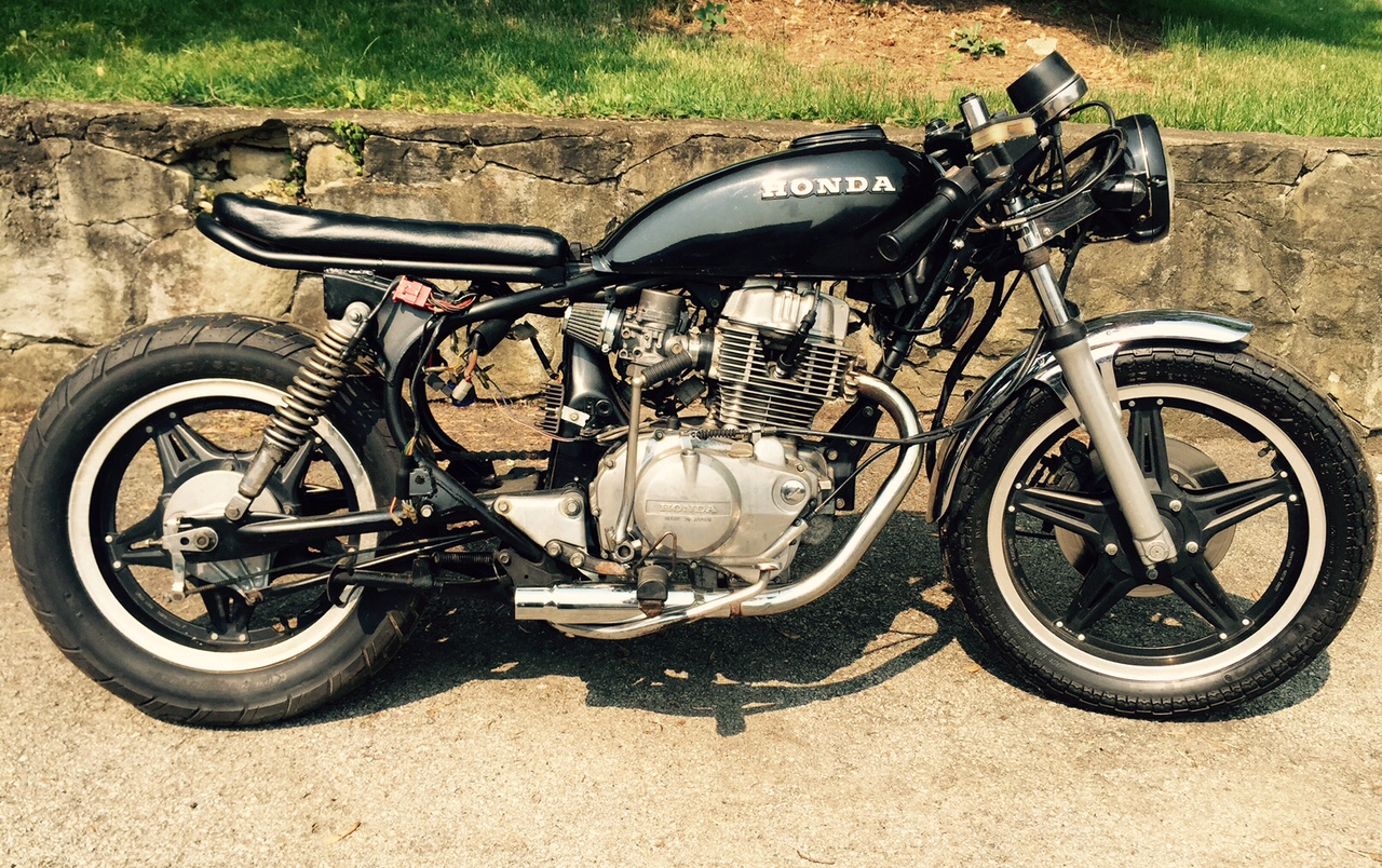

Hey, my first time posting.. my first bike build, it's an 82 cm450c. Only a few things left to do- a few frame tabs to cut off, installing a kicker this winter... bought this and an 81 cm400c on craigslist for $300 each. Got the 400 running and laid it down, hit a mailbox the 3rd time out.
Off work for 4 weeks, I took the 450 down to the frame and sprayed it. Picked up the wheels for $30 each at a salvage yard. Rebuilt the carbs, added pod filters- runs a little lean but pretty well. 2 into 1 exhaust from ebay and emgo handlebars. Rebuilt the front caliper, replaced brake and throttle cables. Found a pretty cool headlight bucket too.
The seat is an airtech cb750 from craigslist, the tank is a junkyard 750 supersport.
$20 spray can paint job that looks like it cost at least $35!
Couple more photos: http://www.flickr.com/photos/travistetzlaff/sets/72157627477053973/with/6113345282/

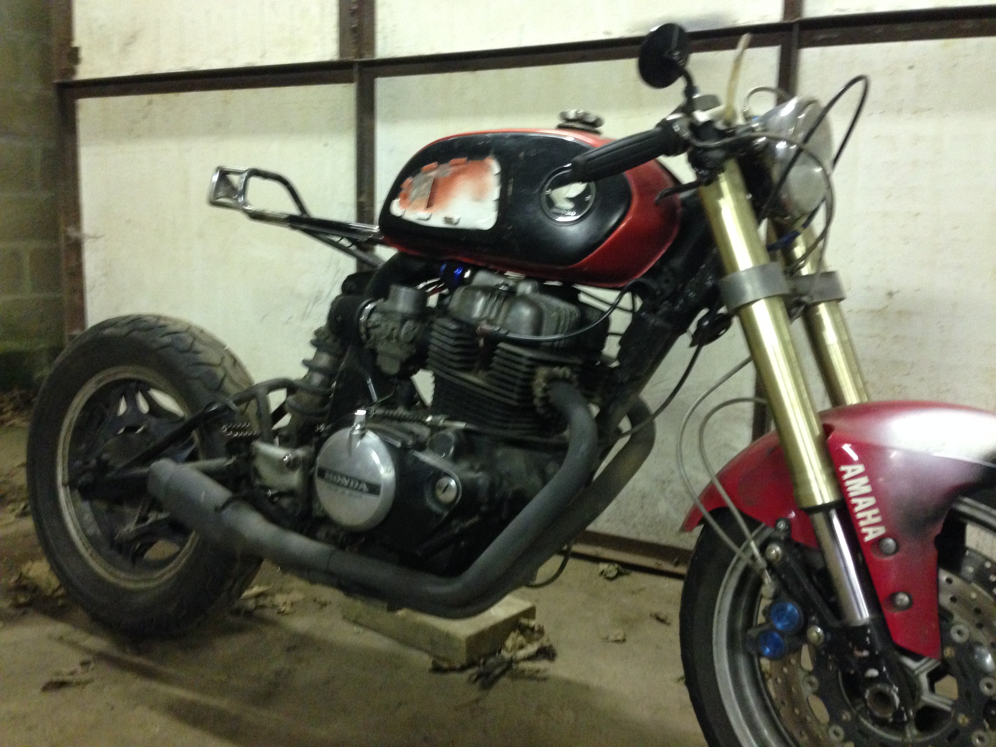

Some of the many stages of my build...

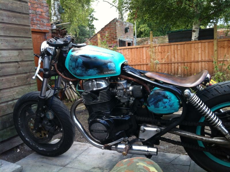

Last December I purchased cb450 nighthawk, its not really a CM400 but its close enough.
Its now close to the finished result, and i will post again when its completely done.
