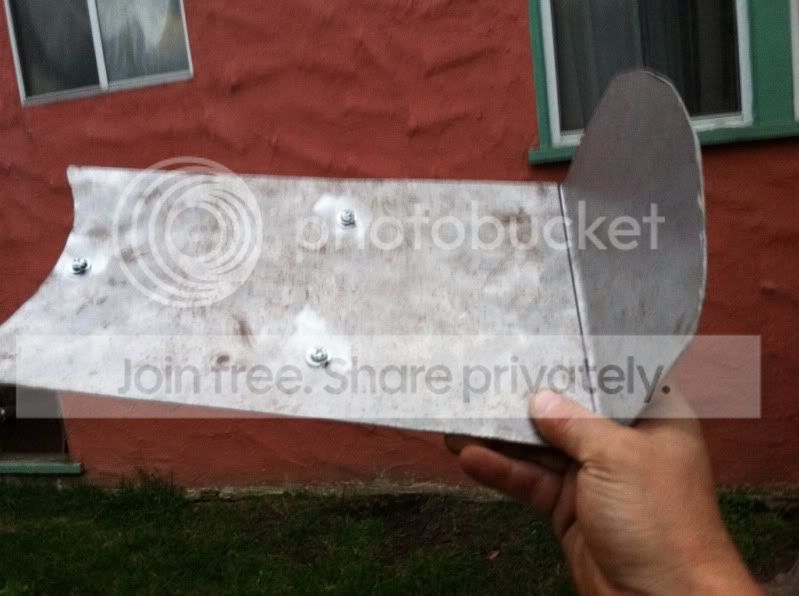

Did a little work over the last few days. Pulled the rubber off the stock pegs. Took an angle grinder to the metal underneath and shaped it up a little...drilled and tapped some holes for chrome socket caps...painted them...and here you go! Well...I ran out of socket caps so I couldn't complete them...but I really like them!
Then I went to work on mounting the tail section to the frame...

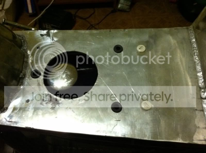

...and then mounting the seat pan to the tail section.
Just needs some foam and leather...

I will adhere the foam to the top of the seat pan here...right over top of the screw heads and wrap the whole thing in nice quilted leather.
The seat pan has metal drywall mollies thru it that "pop" into the rubber grommets in the tail section under it. See the three mollies?
Then those three mollies line up to the three black rubber grommets in the tail section.
Then the seat pan "pops" in to hold it down on top. So it easily "pops" on and off for oil tank access and tail section removal.

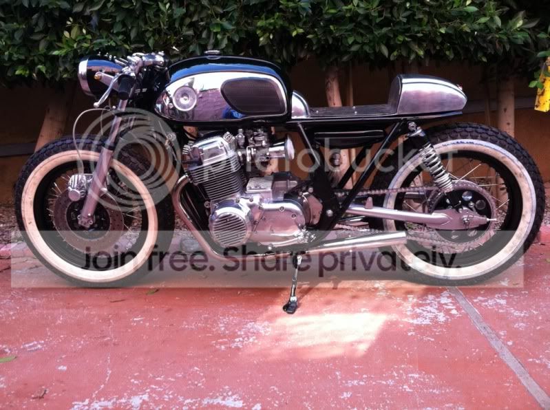

Ran the fuel lines/filters...kept them discrete instead of the big ugly glass filters. I like this better.
Then I put on the exhaust. Still need to put the hangers on the back end of the muffler, tho.

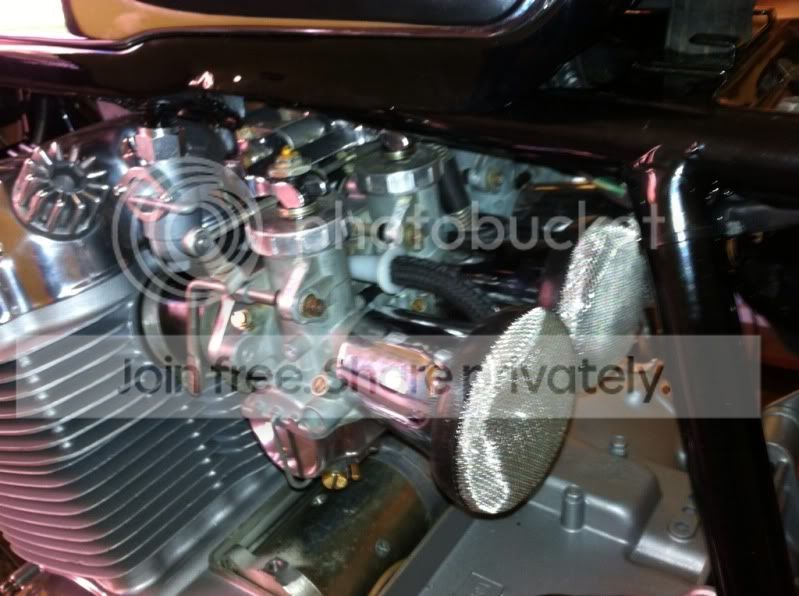

I did get her running!! First try, too!! ...but the carbs need work. Video, coming soon!!

here is my second try at firing her up. after a decent carb clean and new jets...it's muuuch better. still needs work though.
Re: SoCal Mut-N-Chop CB750
Dude! Sounds nice and throaty... so awesome. Congrats!

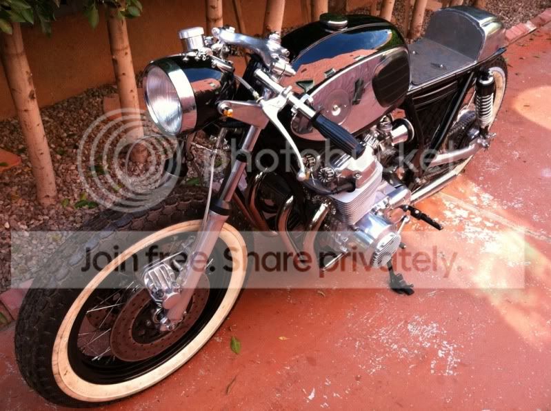

So my gas tank had a bubble in the paint and I had to send it back. And now the painter is holding it ransom for more money. So...the thing isn't on the road yet. UGGGGGHHHH!!
Anyway...in the meantime...the seat is getting upholstery and I am installing a few finishing touches...
Exhaust hangers
Headlight screen
love this build. going to borrow a few ideas from you. been wondering what tank to get and poof right in your build is what I wanted What is it off of exactly? good luck with the painter :(
Love the bike man! Great work. I too want to know the year and model of the tank
Looks awesome! The only thing that gets me are those super long brake lines-stick out like a sore thumb as clean as the rest of bike is.
