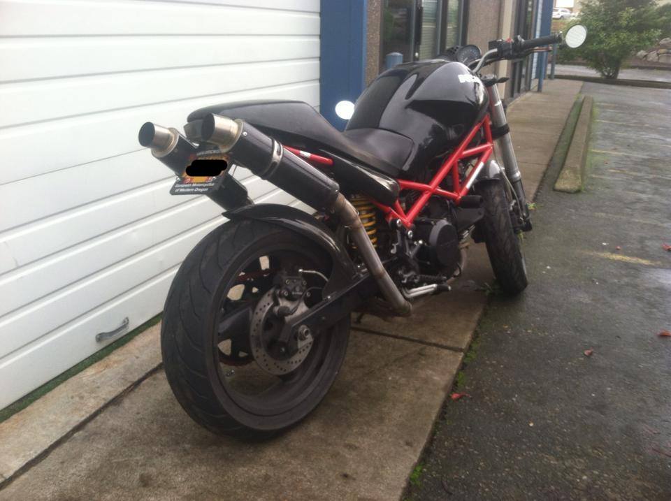

Are those the DanMoto ones? They're a ton lighter than stock, but pretty noisy. All the roar of the Termis, but they don't get quite the same bass. I stretched mine out and that definitely helped.
Here's mine as it sits.
Yea, those are the Dan Moto. I have read very mixed reviews. Did you have to do any ECU tuning after instal?
