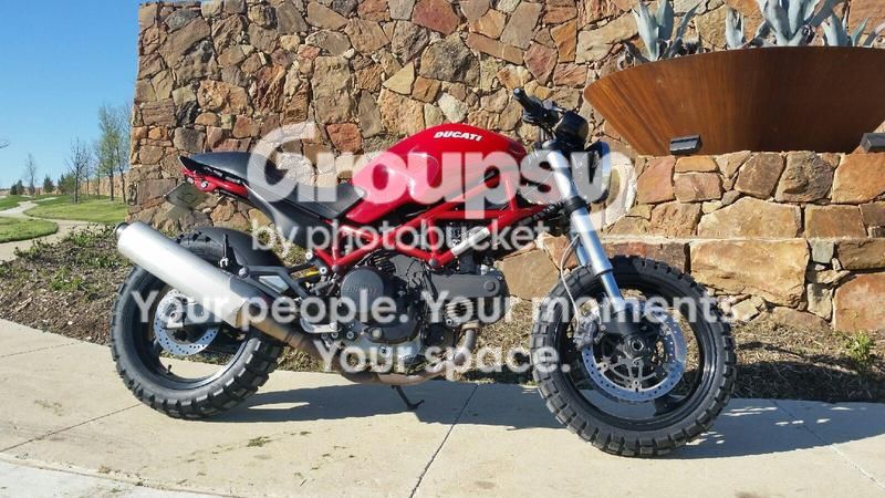

Got the bike back yesterday.
I still have to figure out the front fender. I think it is one of the key design elements of the stock bike. I'm not sure if I'm gonna run it or not. I suppose if the bike ever leaves pavement I'll want it on there. Aaaaand with those tires, why would I stay on the pavement?
That front tire will carry a lot of debris that will fling up onto the under side and out in front of you to run into... fenders were never invented for there cool factor. Course you can run roost guards and keep the duck bill down all the time :o
Trust me, as someone who rides an enduro everyday, you want a front fender with those tires. Mud or not, it's coming back at you. They're really good at throwing stuff high in the air too, plus at everyone around you.
I added the front fender back on. We were certain that it wouldn't clear the tires. Turns out, it fits fine with no modification.
I went ahead and pulled the trigger on the "tracker" bars, some Oury BMX grips and some cheap adjustable levers.
Here is the side shot. I need to roll the bars back a few degrees. Still up in the air about the exhaust. Also, not sure I really like the side covers.
