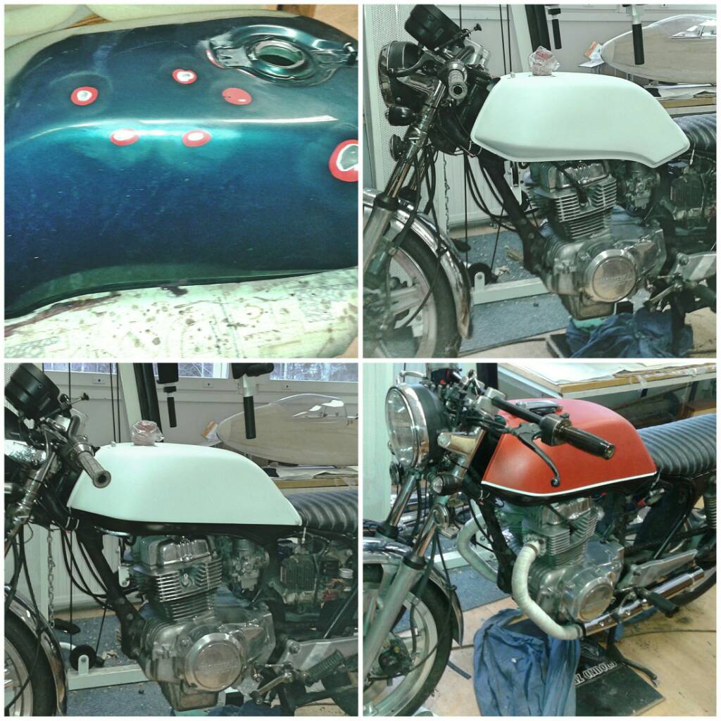

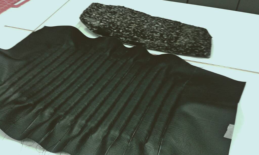

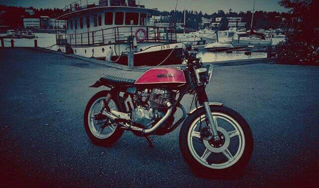

Anyways here is some footage from the past. Painting, making the seat, pics from last summer ect.

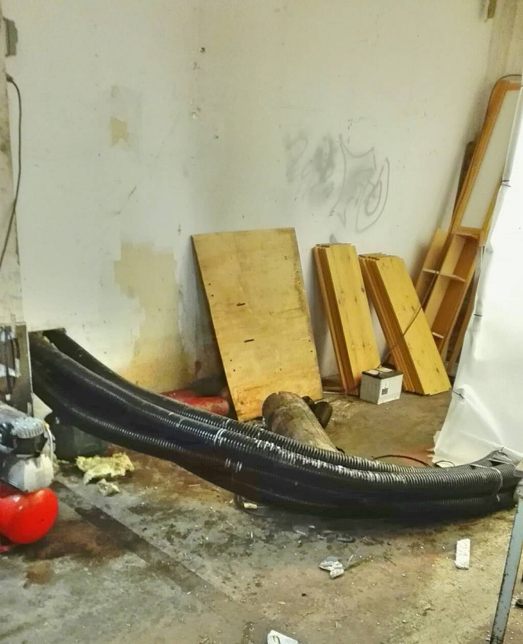

Today I was building a painting booth in my garage hall. I used metal pipe to body and covered it with tarp.
Booth is attached to back wall by hinges so its possible to lift the booth up with winch. Thats because I dont need the booth all the time so its very practical if I can winch it up if I need the space for car ect.

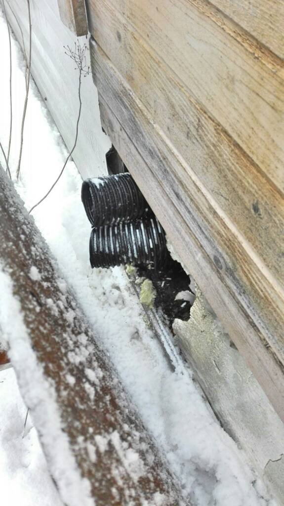

Also I thought to make some kind of ventilation to the booth so painting chemicals moves out. I put few pipes to make kind of flue from the booth to outside of hall.
The booth isnt ready yet, still need the winch and some kind of fan to ventilation so gasses moves out.

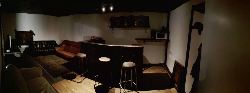

Something about place Im working in. It is half of a big hall, in small shipyard. The hall is built for a ship, but now there is wall which separates the hall in two smaller section.
Hall is pretty big, garage room is something around 120m2 so there is plenty on room to rock. There is balcony built for a "inspiration" room in hall. Hope Im able to add "panorama" pictures here

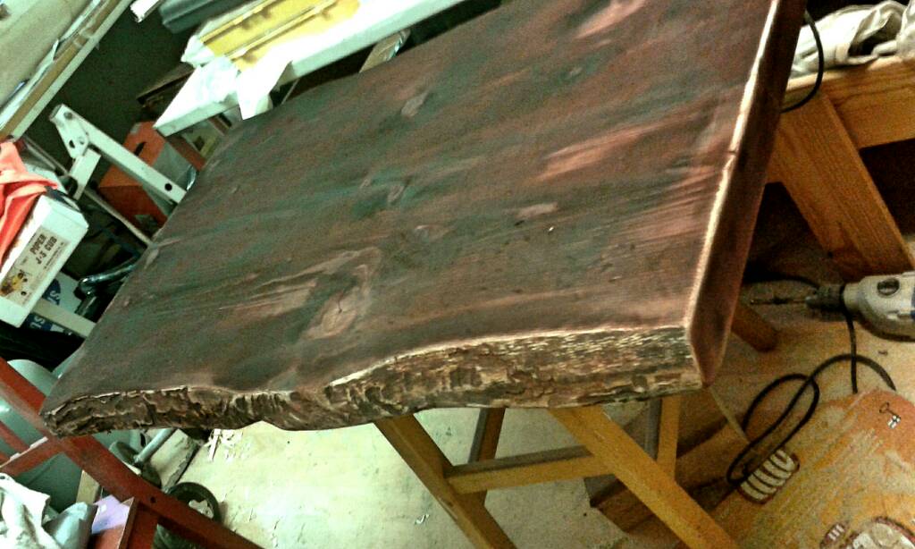

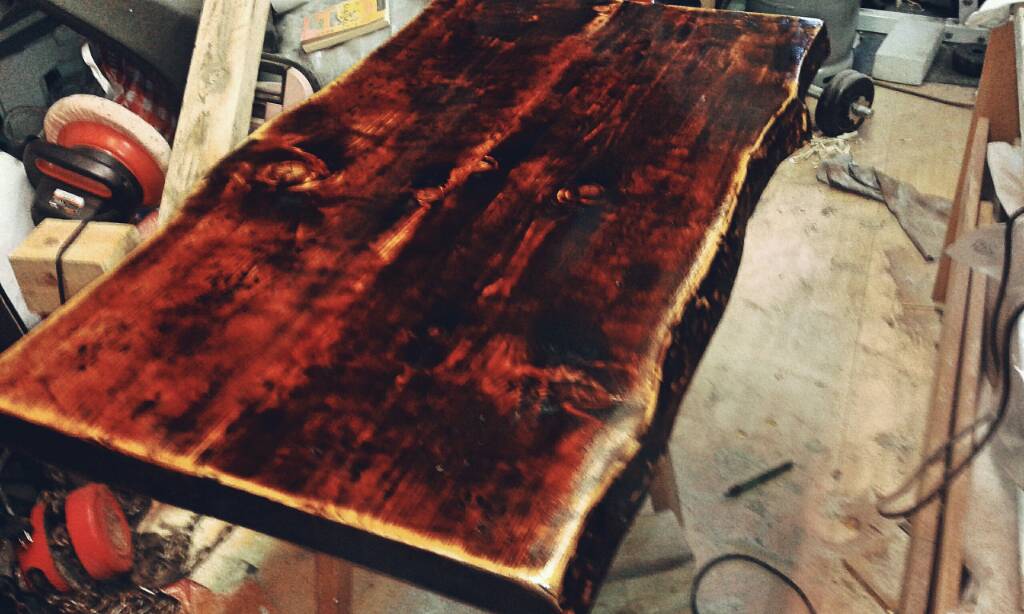

I told Ive worked on some wood stuff and joinery kind of things. Few months ago I did a coffee table. I got the the idea when I found long and thick waned plank and I thought is just nice for making a table top. The deck was pretty massive i guess 2" thick so also legs had to be. Legs are made of 4" x 4" lumber, and skirt/frame is 2" x 2" lumber. Table is stained with "dark mahogany" and varnished. Im annoyed I havent more pics of working progress Deck stained, deck stained and varnished, and finished table.

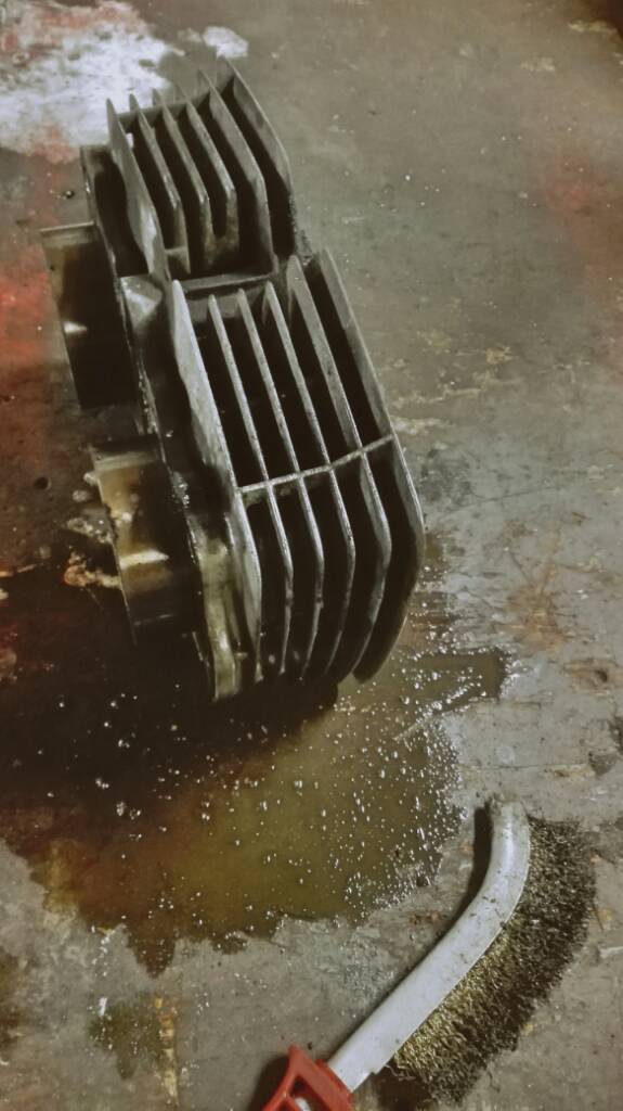

Today I was cleaning and painting my bikes engine. I thought to paint it black, cause it would be easier to "maintain" smart looking. It would oxidice too fast if i polished it only. Painted body and swing too. Also polished engine sides a little bit.

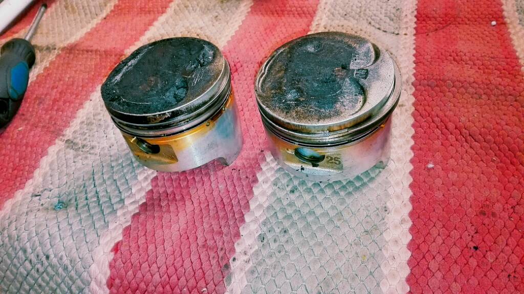

I drop few tears today. Bikes last owner had to be some kind of retard. Well, I measure a piston of the bike a while ago and ordered new pistons. I got the pistons few days back and today I quick fitted the piston to the cylinder. The cylinder was loose..? I fitted to another cylinder, it was good. So last owner has only replaced one piston and drilled one cylinder to bigger!? I measured old pistons again so yes. One 70.5mm another 71mm.

Old pistons.

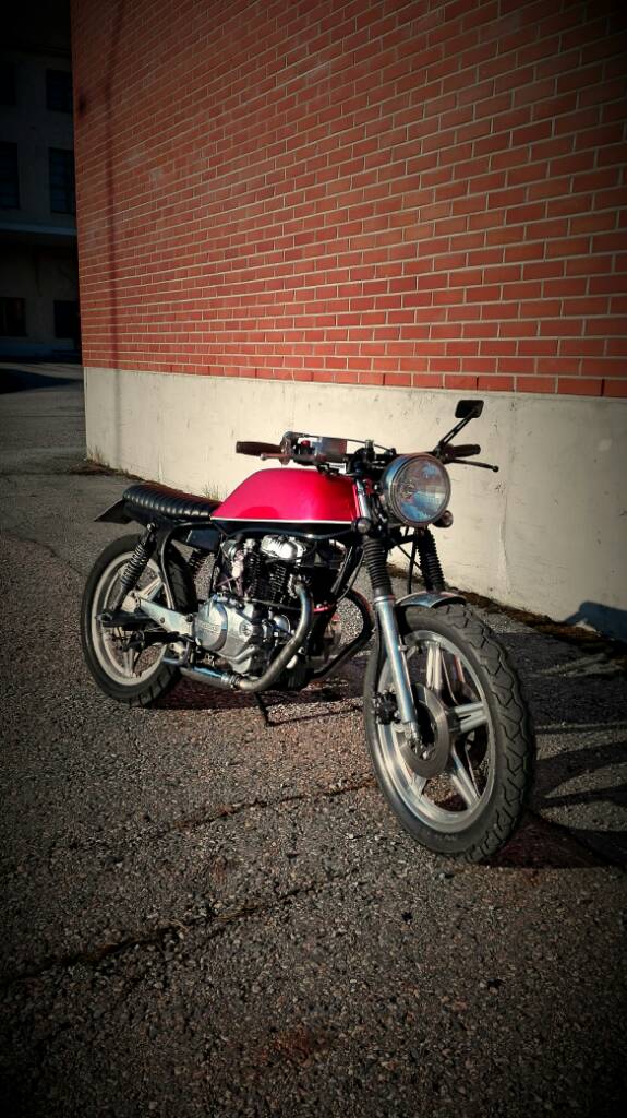

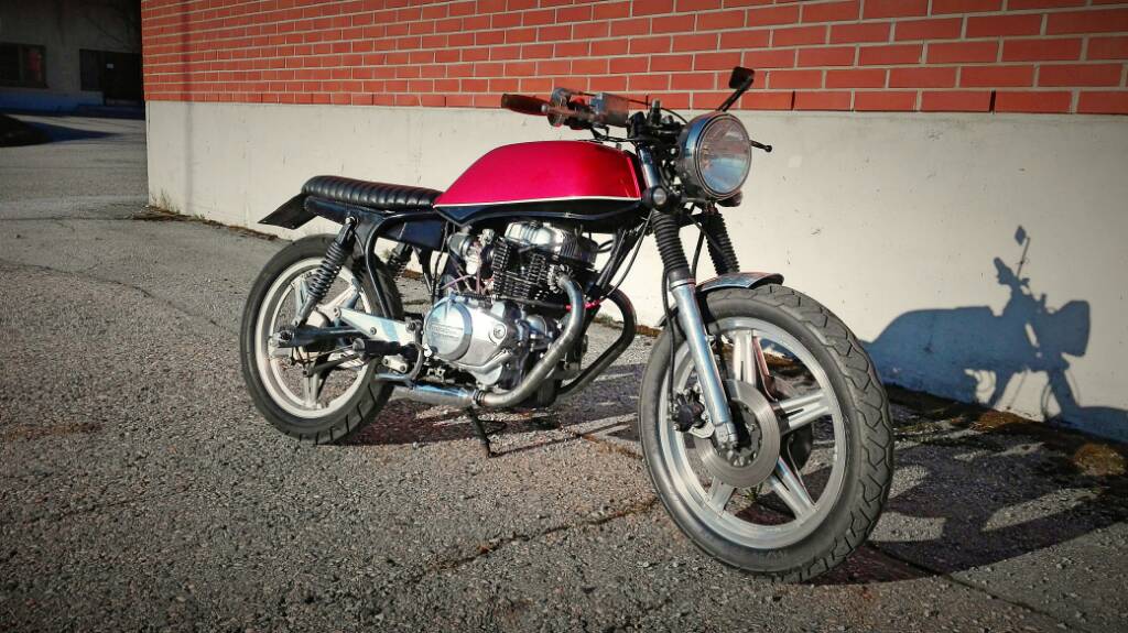

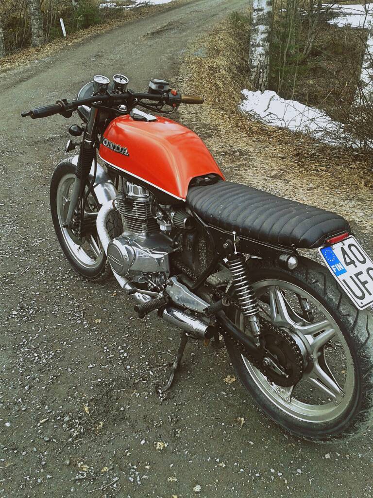

Well, sadly I havent been very active lately. I got my bike assemblied and it is kind of ready to ride now. Here is some pics i took today.

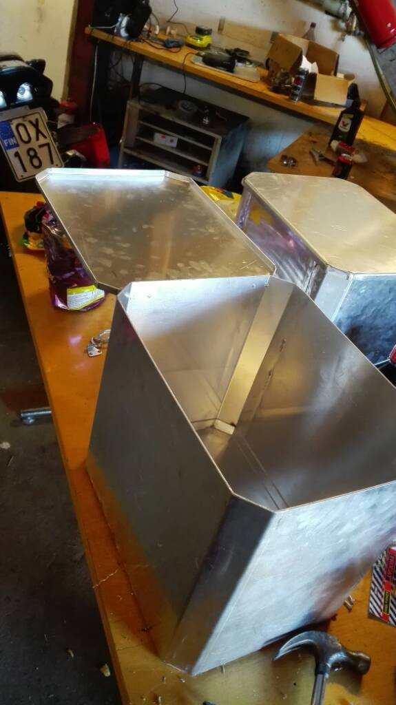

I had a small sheetmetal work project at school. Assignment was to make something from sheet metal. My group decided to make aluminium side panniers. Made from 2mm aluminium sheet, cutted with plasmacutter, bended with cnc bend press and welded with tig.
