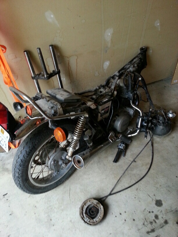

Got a piece of junk 1981 yamaha sr250 that I decided to play around with. I couldn't decide on a paint scheme so I chose the boring route and went all white. I will be posting progress pictures of the build.

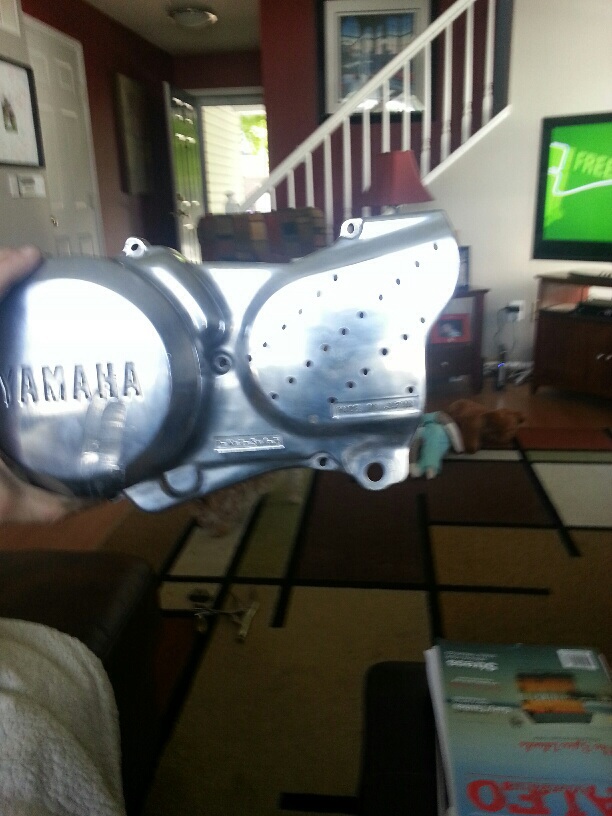

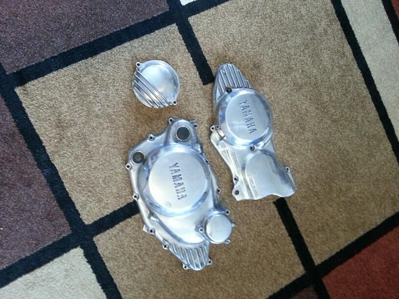

Before and after polishing

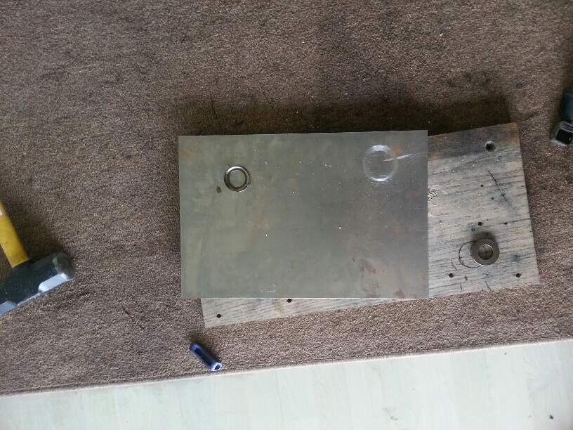

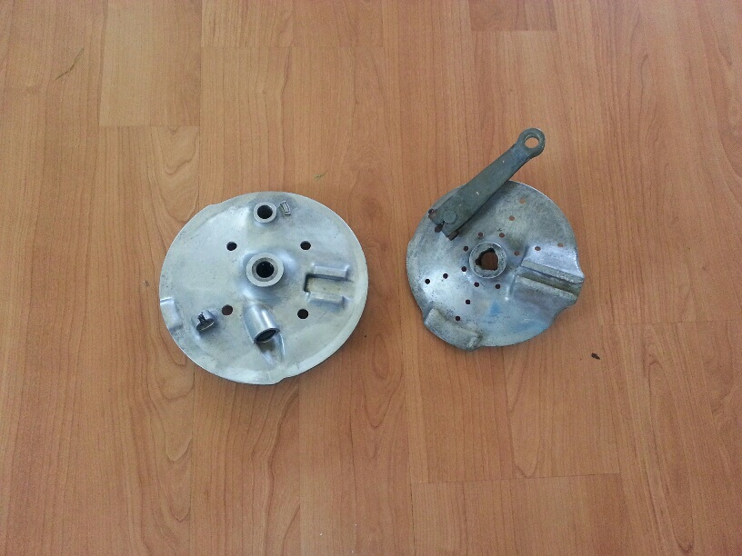

Holes drilled in the cover and the front and rear brakes

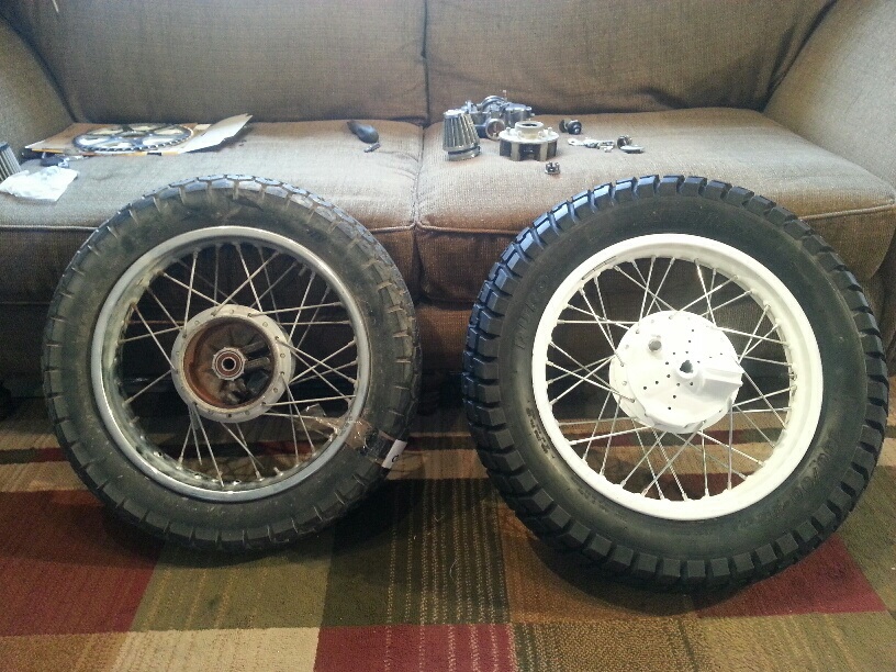

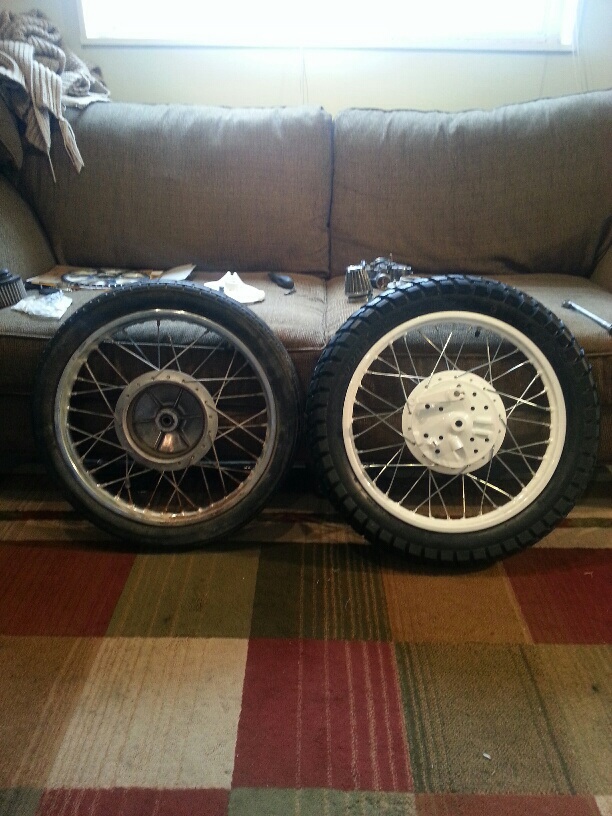

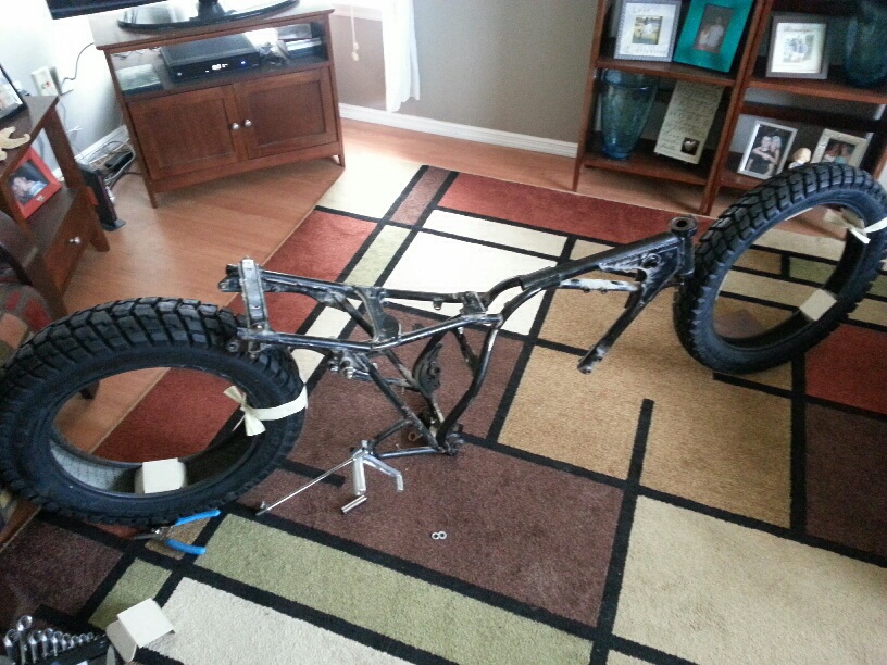

Using Duro HF904 dual sport tires.
Front 18x4.1 and rear 130/90-16

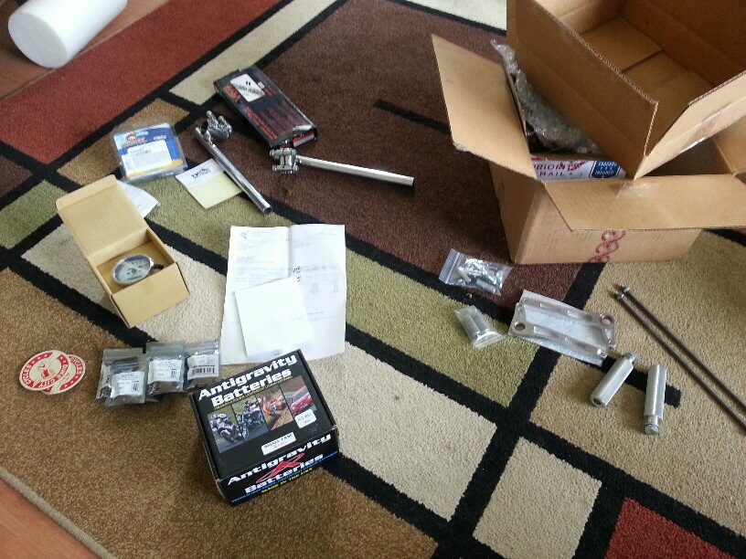

New parts from dime city cycles

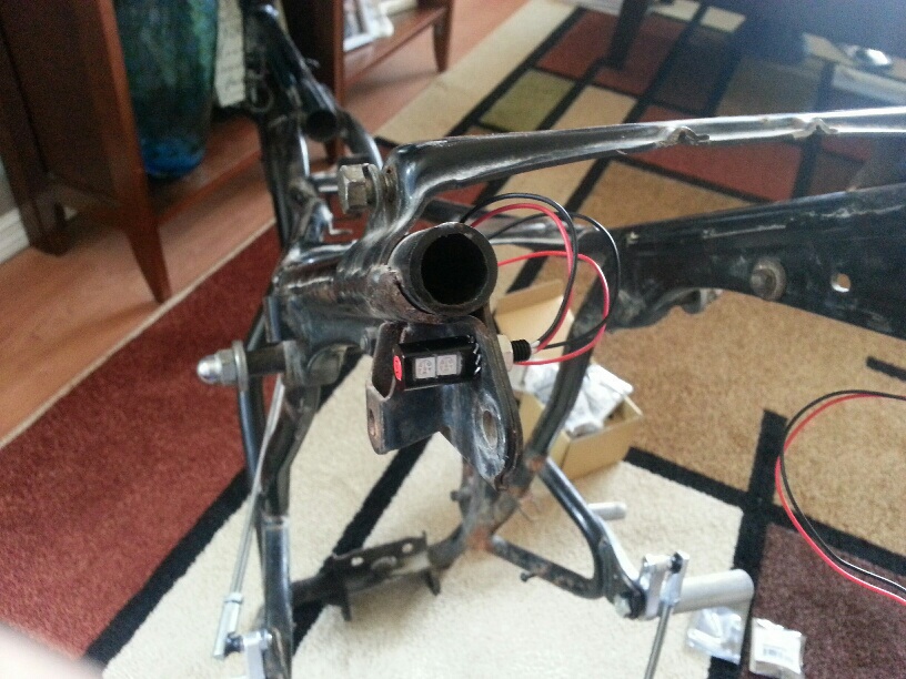

Mini LED turn signals. Extremely bright for the size

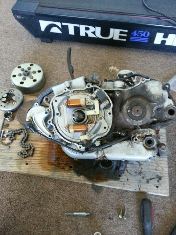

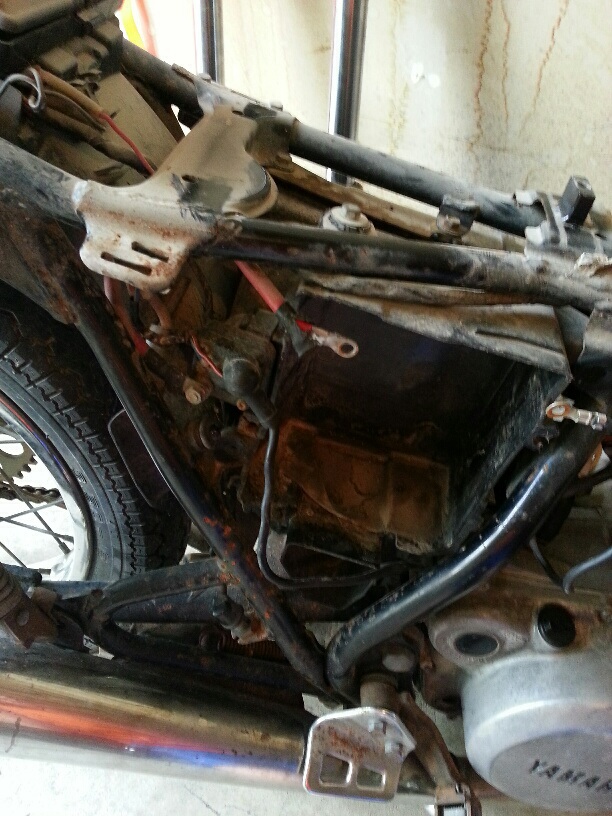

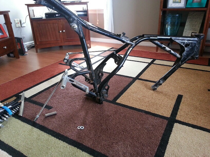

Case splitting and cleaning

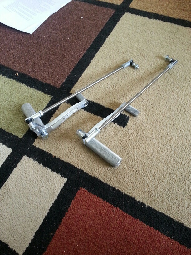

Decided to add a kick starter to the sr250. Found all the parts needed

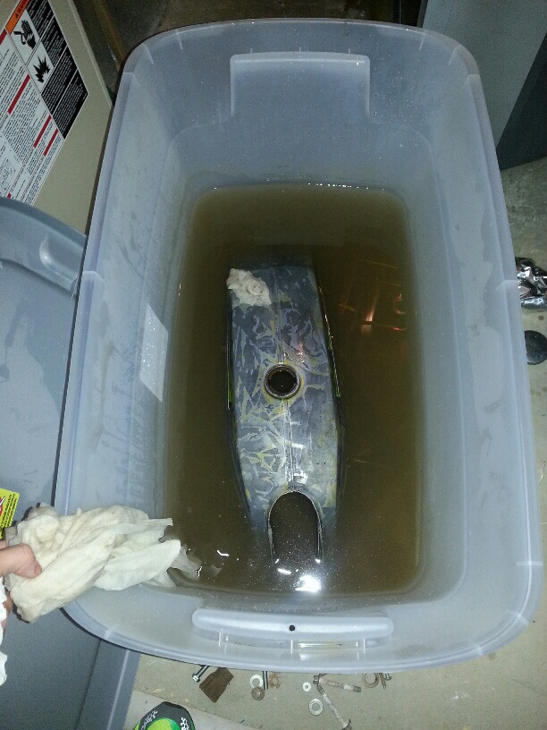

Found a rare 1971 suzuki t125 stinger fuel tank. Little rusty so I am soaking it in vinegar and then using Caswell sealer

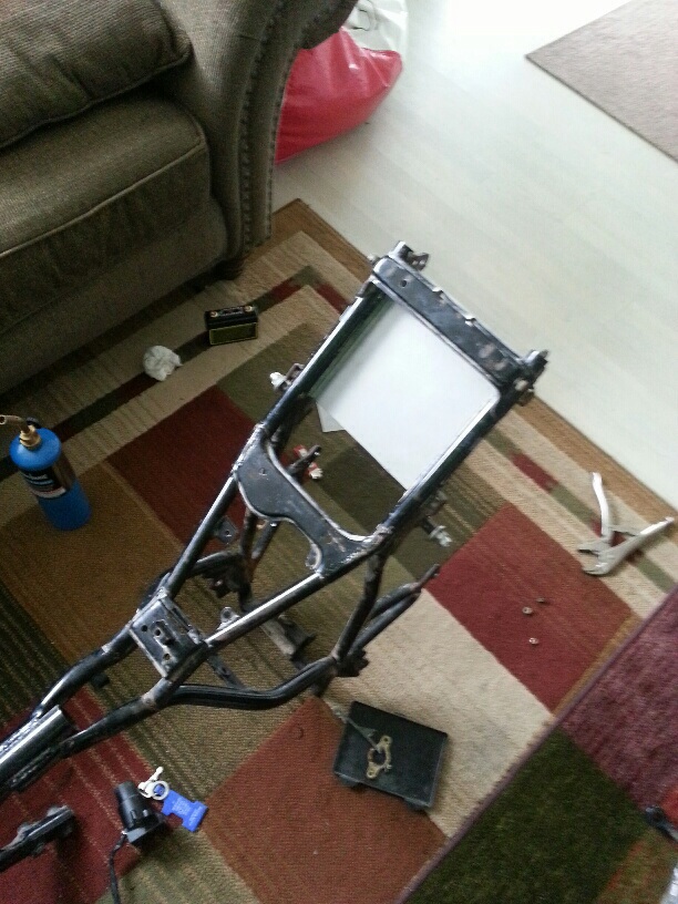

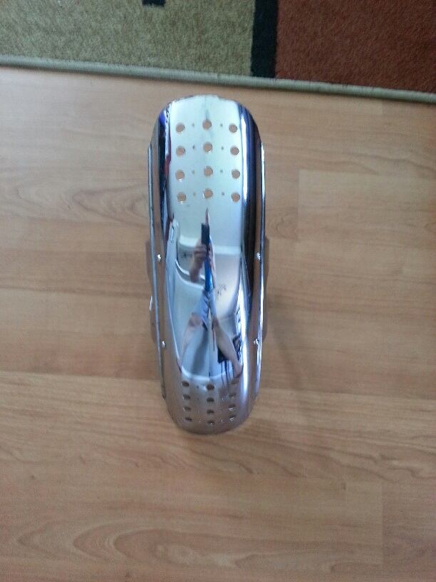

Chopped the fenders

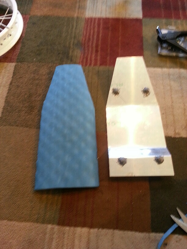

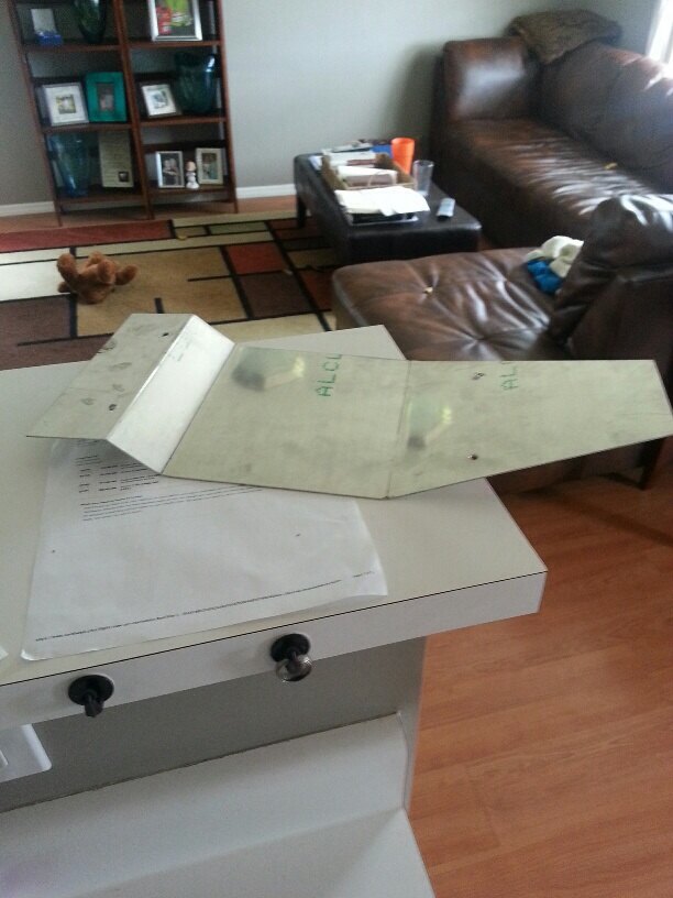

Seat pan made

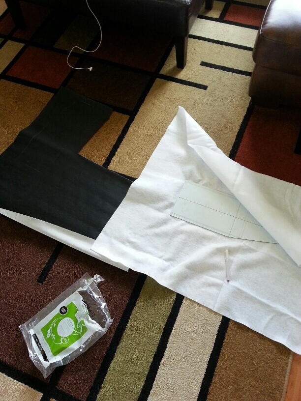

Using an old yoga mat for the padding. I'm also attempting to sew my first seat

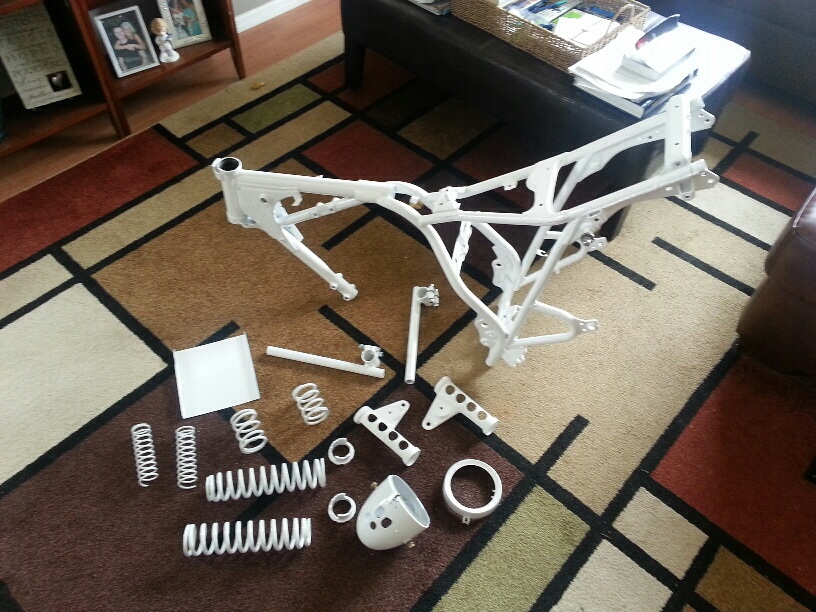

everything painted white

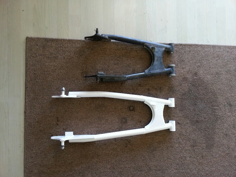

I found an extra sr250 swingarm and decided to extend it 6 inches. Here's a comparison of the original vs the extended

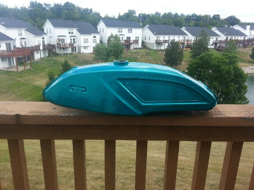

An extra suzuki t125 tank I had. Wanted to see a different color on it

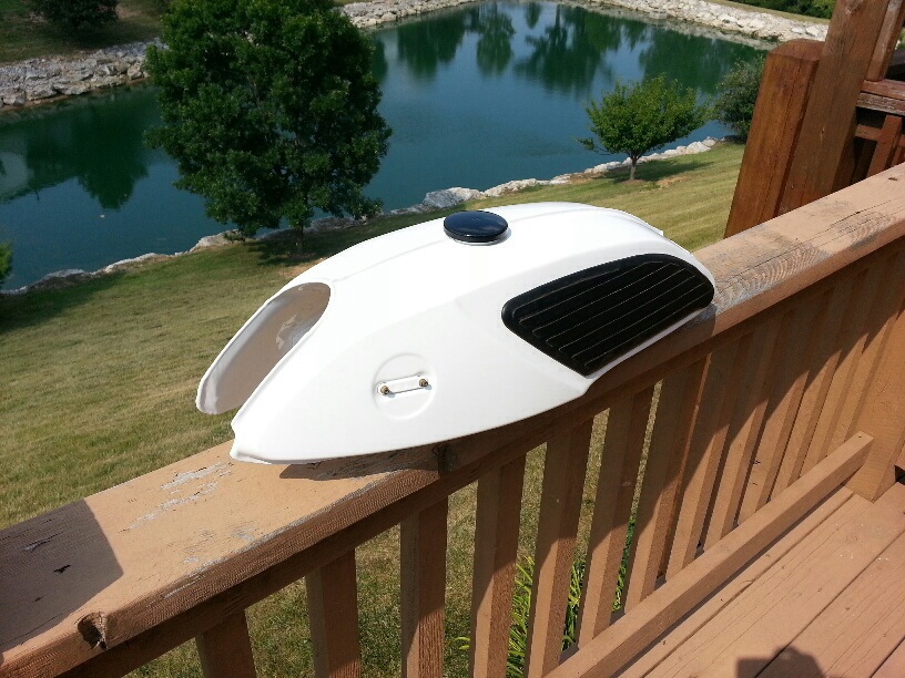

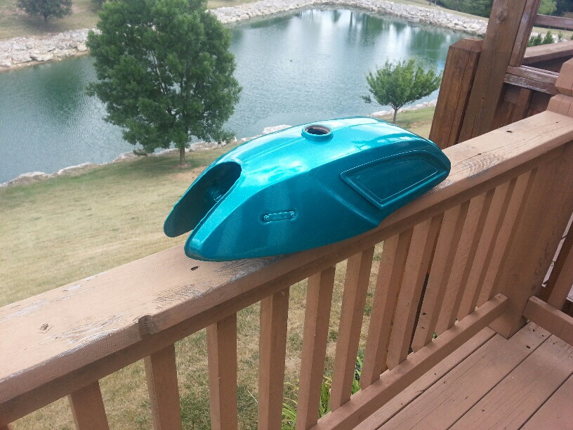

Tank finished

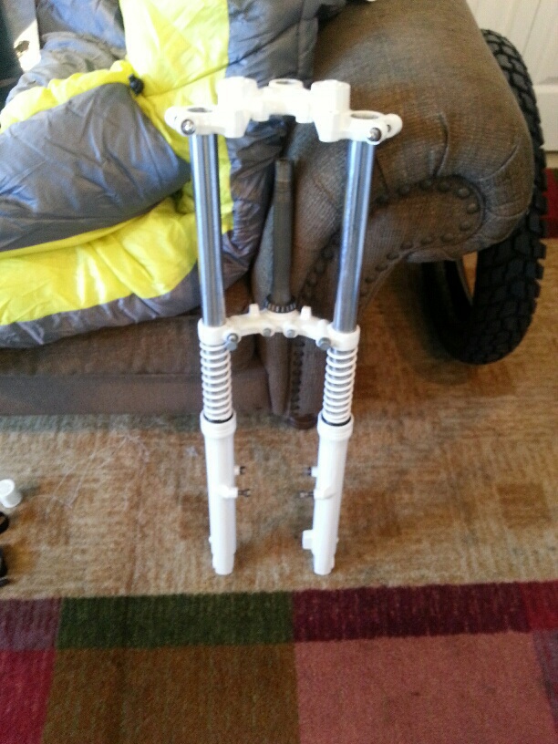

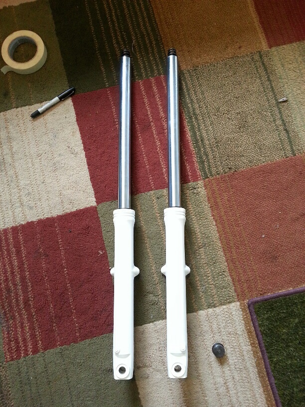

Rebuilt the forks with new seals and also added an external spring to help stiffen the front up

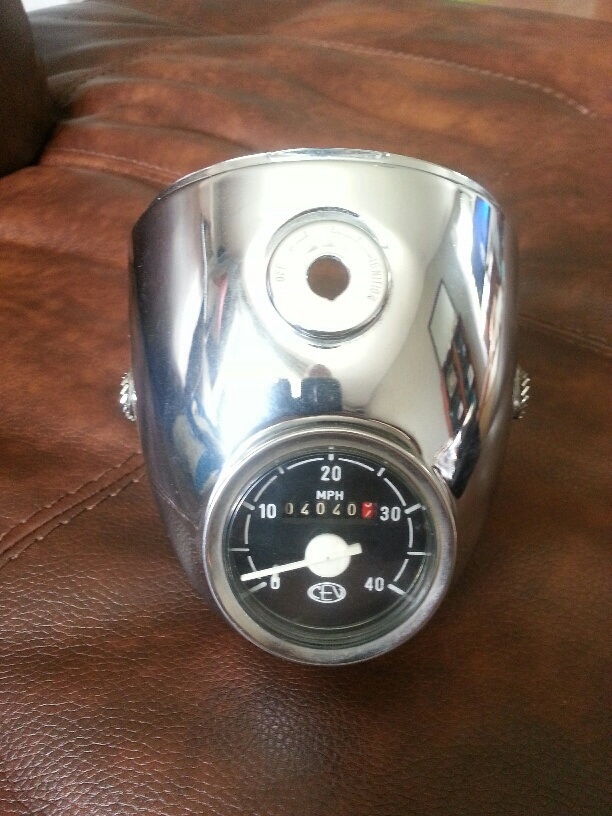

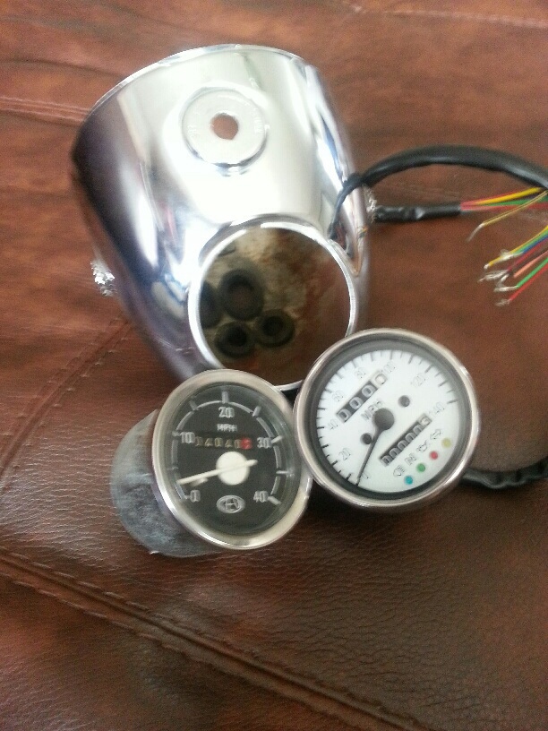

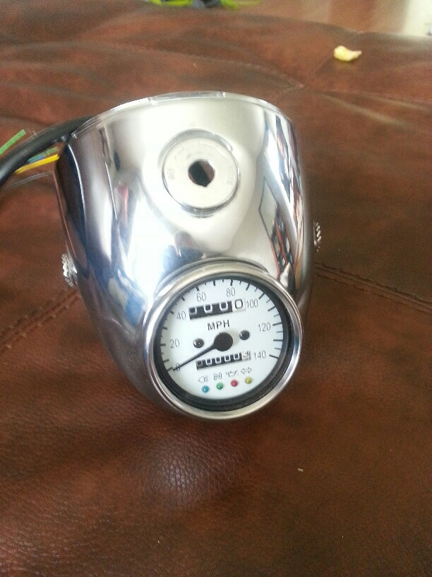

Found an old 1960s headlight with speedo. The mini speedo from dime city cycles fits perfectly.

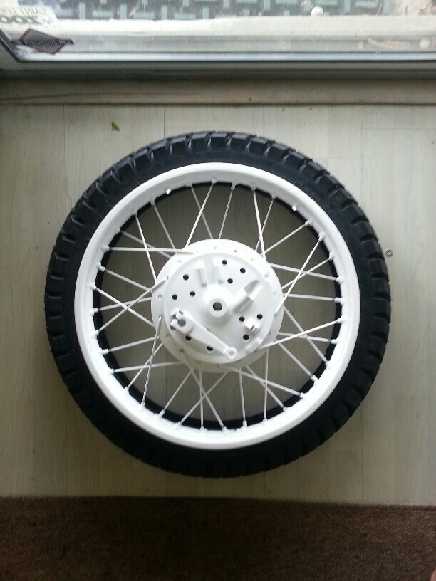

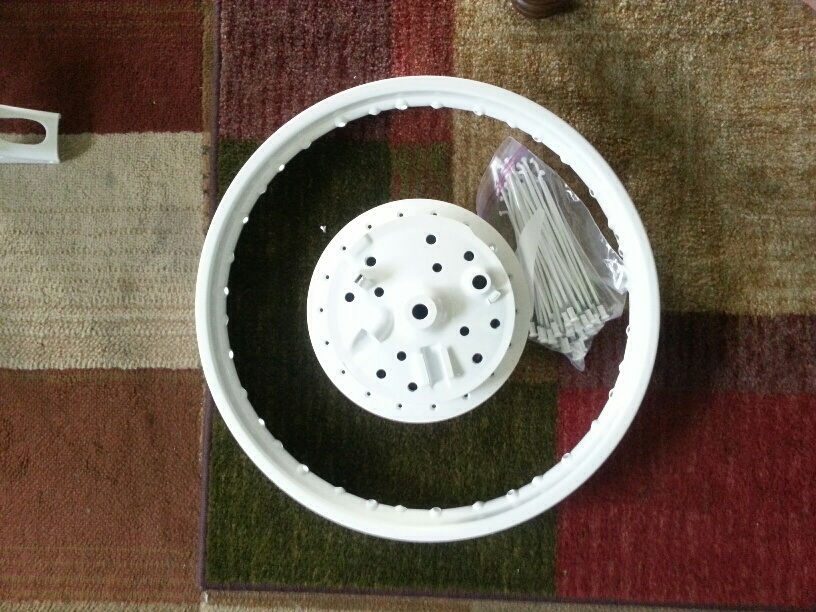

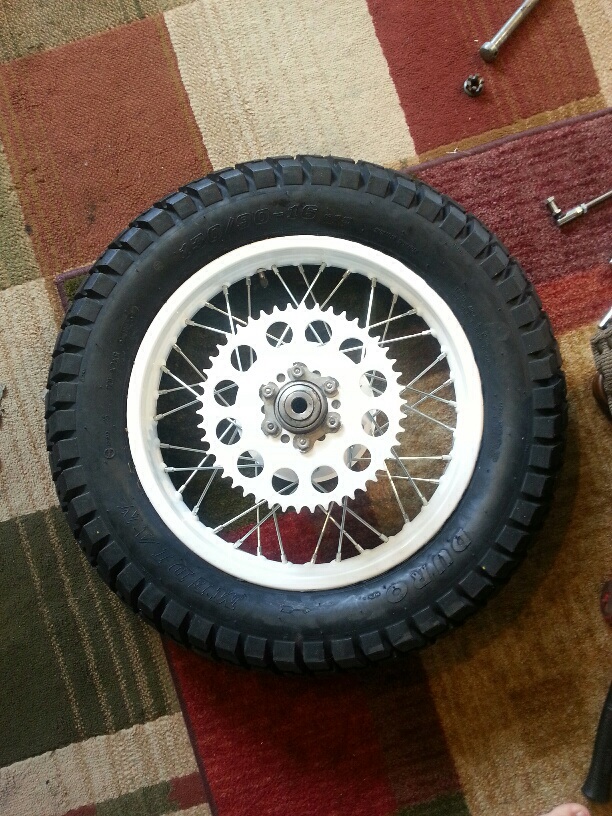

Laced up the wheels which was a pain in the a$$
