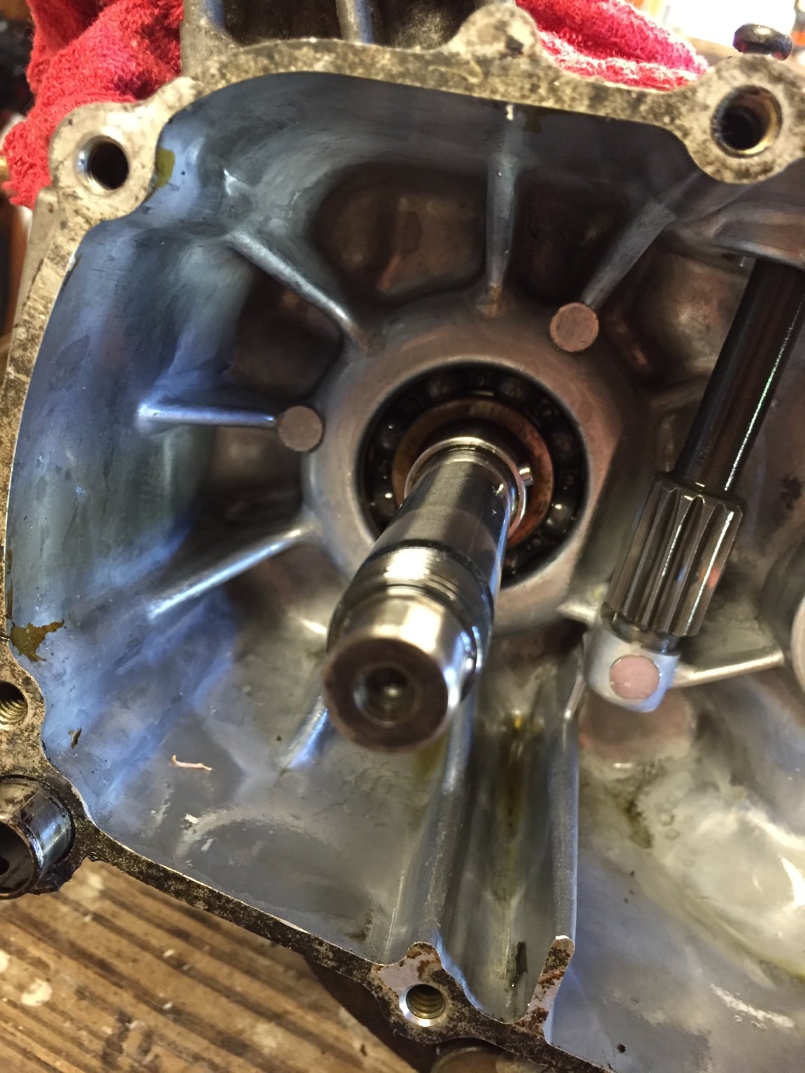

I'm a dummy. The crank seal on this side is behind the bearing, which requires removing frank the crank to access, which I am not getting involved in. The crank seal I bought is for the OTHER side, which is outside of the bearing behind the flywheel and advance mechanism.
I am assuming since the flywheel side seal is dry on the outside and there was a buncha dirt and crap in there that it's the suspect. So once the flywheel puller comes in I'll get that done up and get this silly thing back together.

While I have the flywheel and stator off, I got to the crank seal under there and replaced it. The rubber grommet that seals off that side of the case had popped right out and it was all full of dirt in there. I put it back in with some hondabond make sure everything stays out.

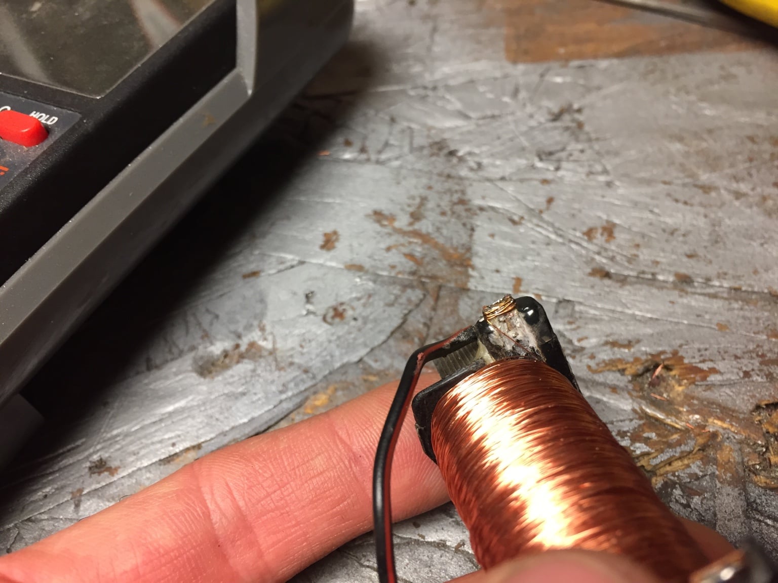

I worked through the electrical to figure out the spark issue, tested all the elements on a running FA50. PEI unit is good, coil works, i swapped/tested everything else but none of the other stuff effects the ignition circuit. Narrowed it down to a faulty primary winding on the stator - had open circuits between the two main leads. So rather than paying $50 for a used stator I decided to DIY it and bought a roll of 34 AWG magnet wire from eBay and went to town.

The resistance value in the manual is 90-110, so I'm quite a bit higher. I'm going to test it out and see how the spark looks. I can always unwind and get it back within range if it doesn't work.
An important bit is to scrape off the insulation before wrapping it on the post. I took about 2" and scraped the insulation with an exacto, wrapped it and put a dab of solder to hold it in place. Then resoldered the wires.
Unwound until I hit spec. Once I soldered the end back on I was just under 110 ohms, right within spec.
A coat of quick set epoxy and she should be insulated and ready to pop back in tomorrow.

Here's a better pic of the winding. Popped it in today and it definitely works, nice blue sparks.
