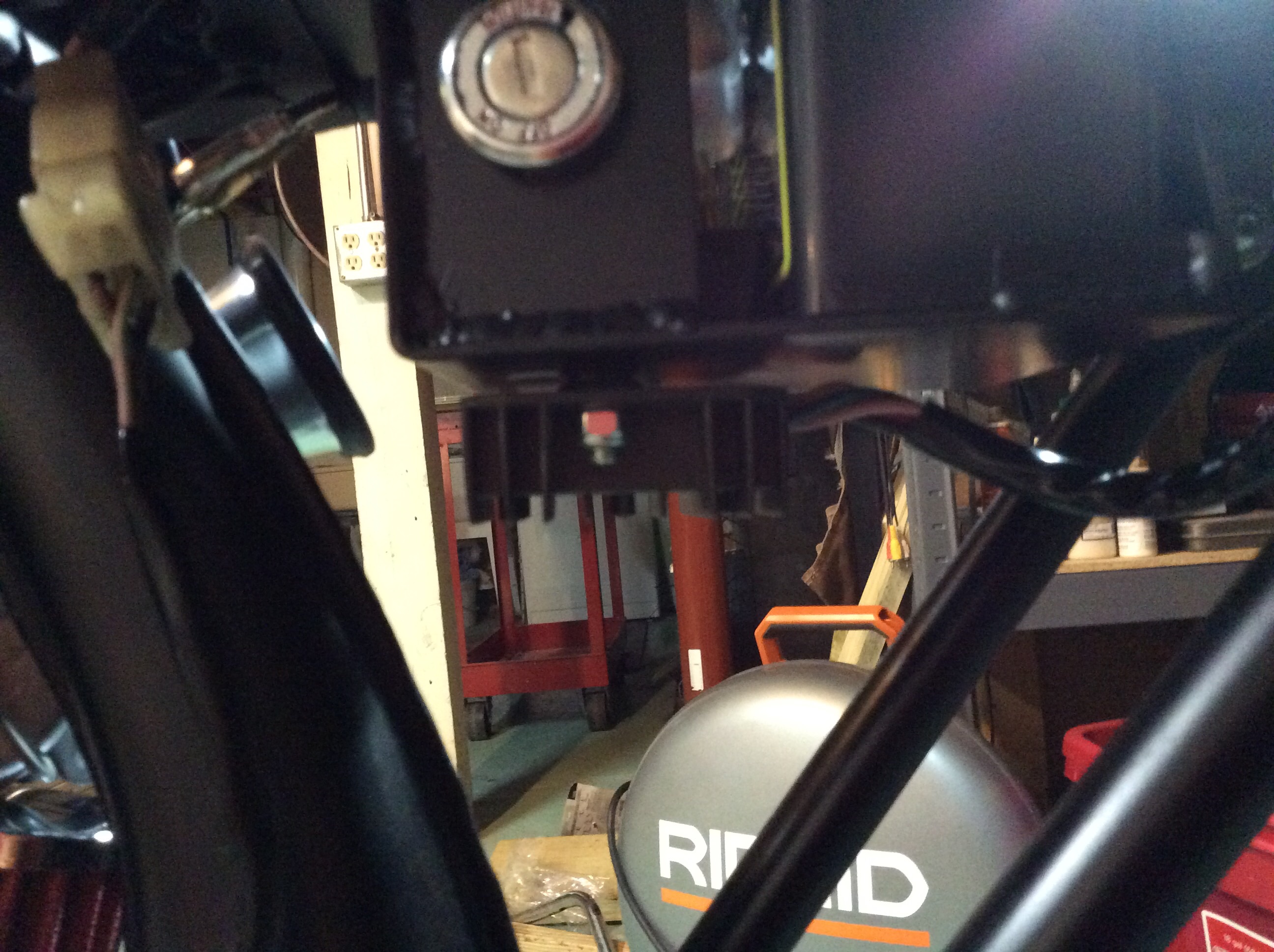

I made a tray for the electrical components to go under the seat on Saturday. I need to figure out how to mount it now and make sure everything can fit inside.
Close up of the welds. Not perfect but better than I thought it would turn out :)
Consider mounting the rectifier /regulator on the underside of the tray. It gives it much better cooling and keep the heat away from the rest of the electrical parts. I mounted it with grommets I cut in half to isolate it from some vibration.

I took 45exmayor's advice and mounted the regulator underneath. I think that will be much better.
