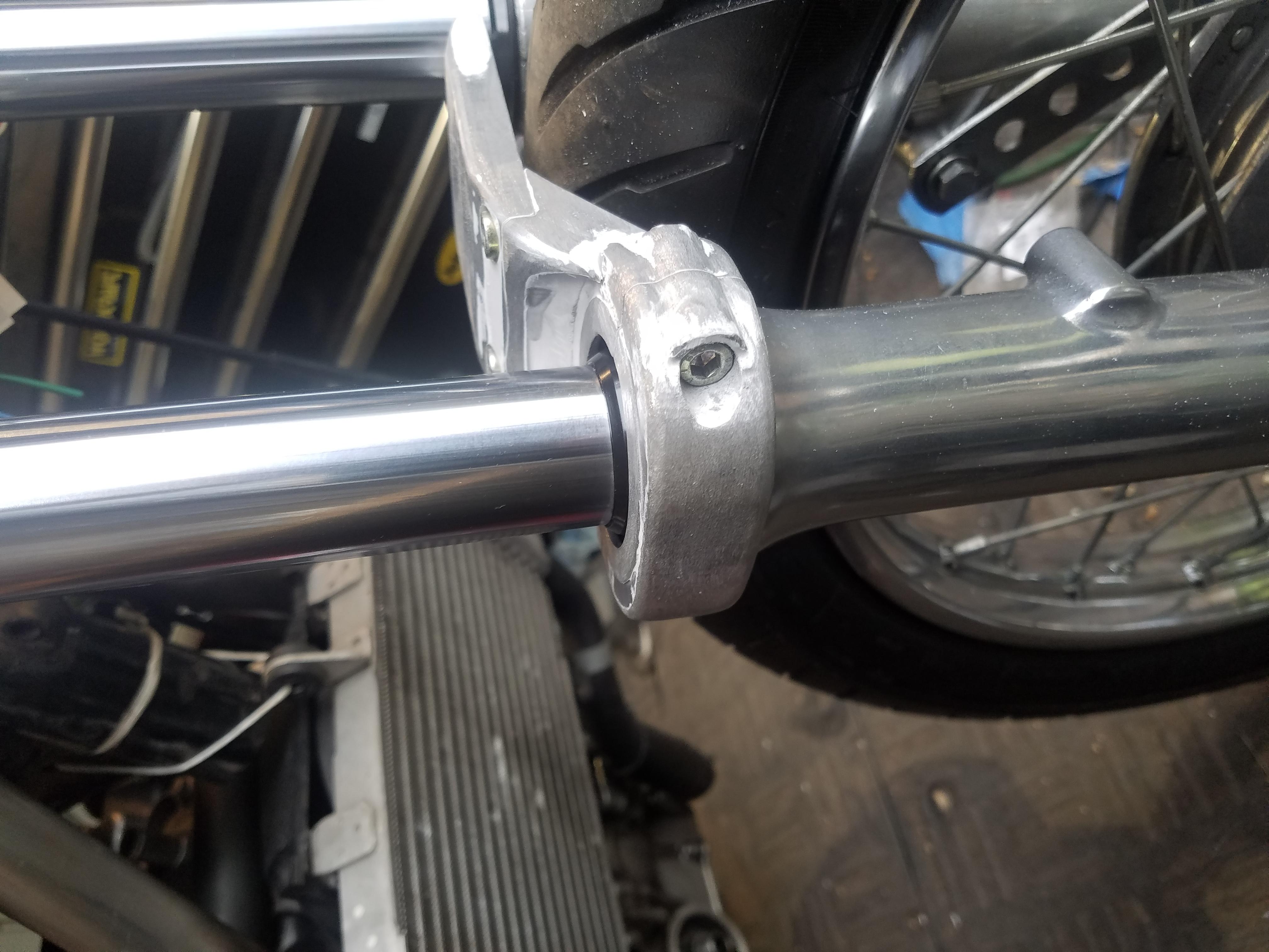

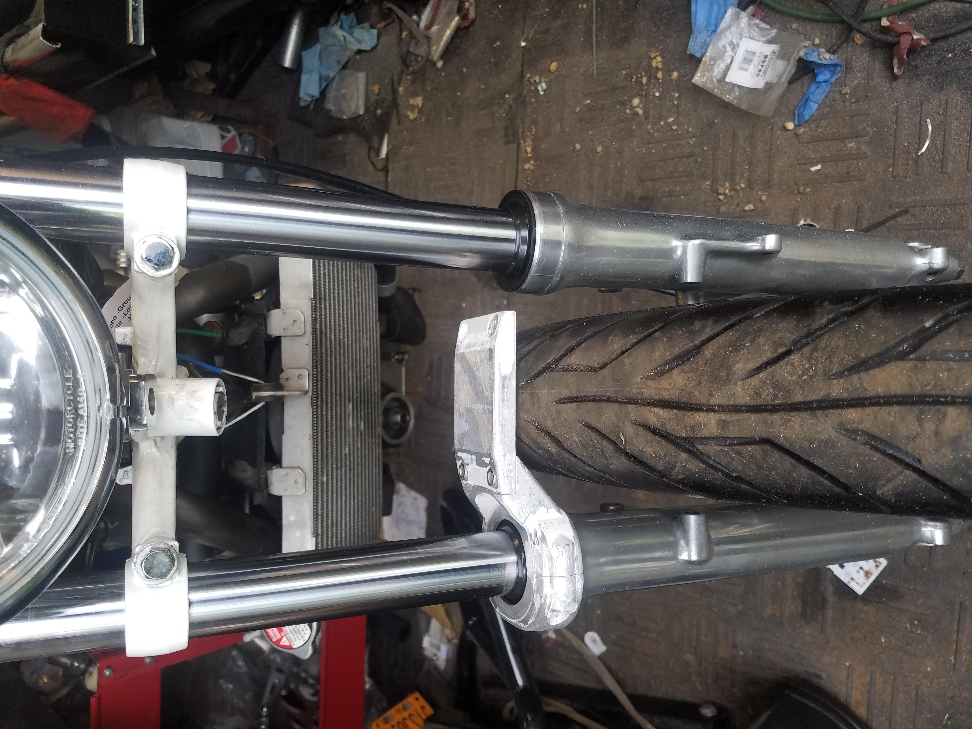

Started reprofiling the fork brace

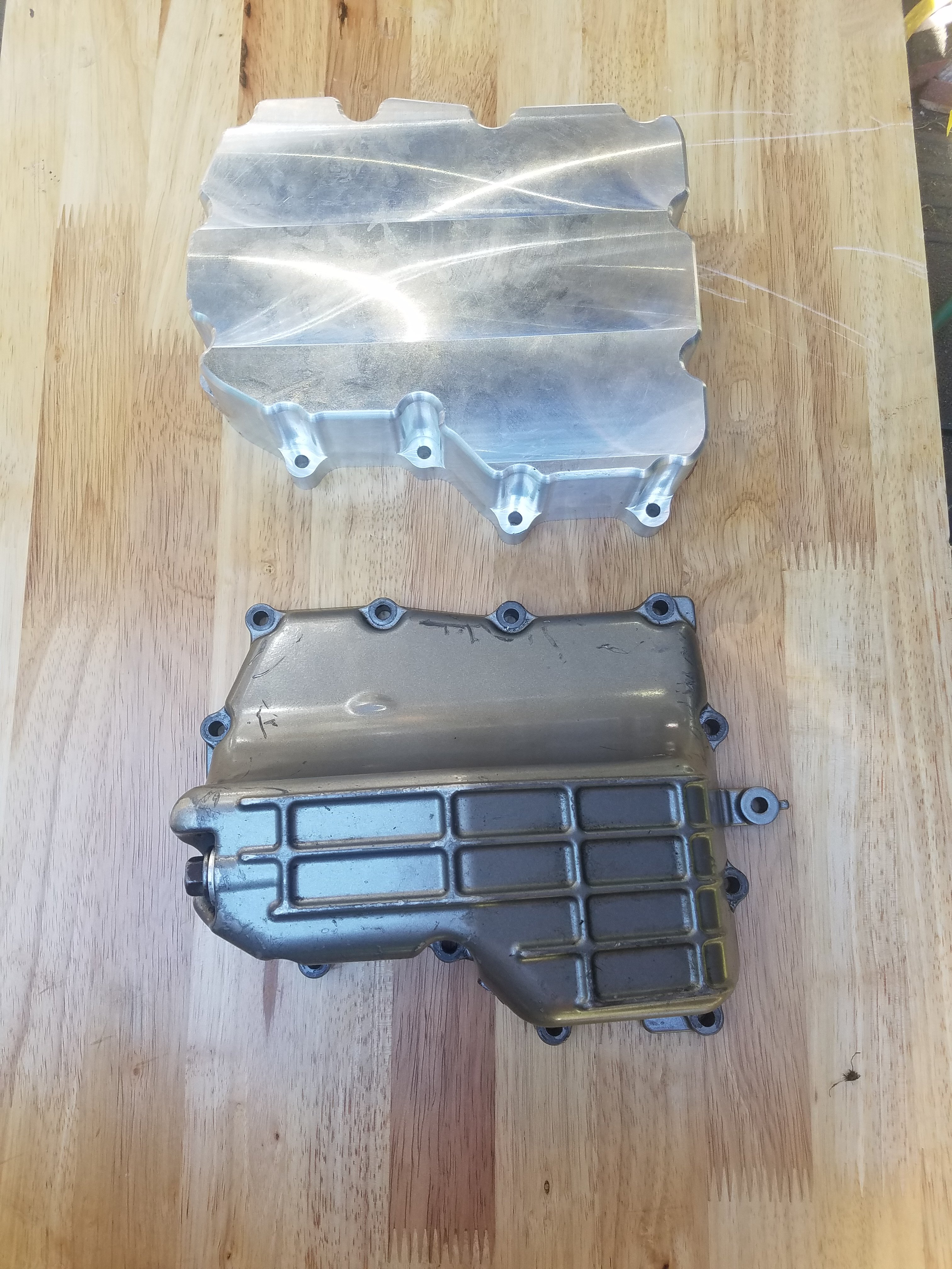

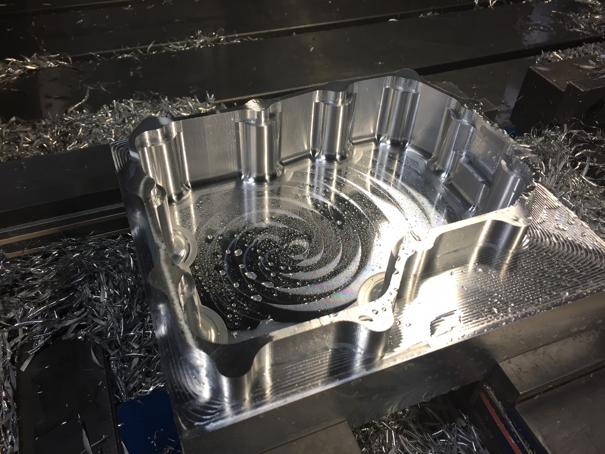

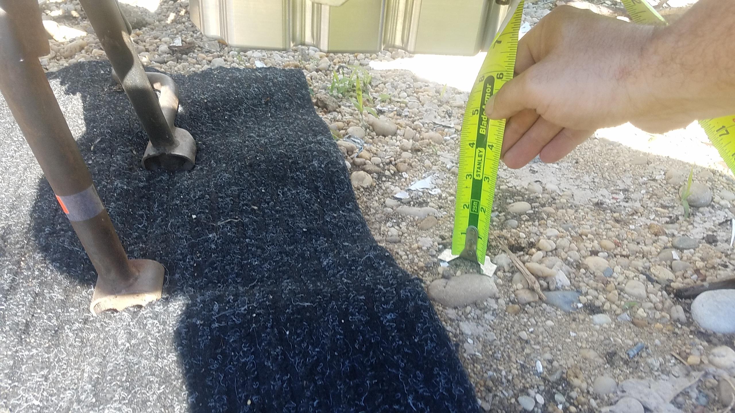

Progress. Got the pan back, and damn it looks good. Over 6 inches ground clearance and holds and same volume. Now the second half of the solution is making a new exhaust, which isn't a real big deal.
