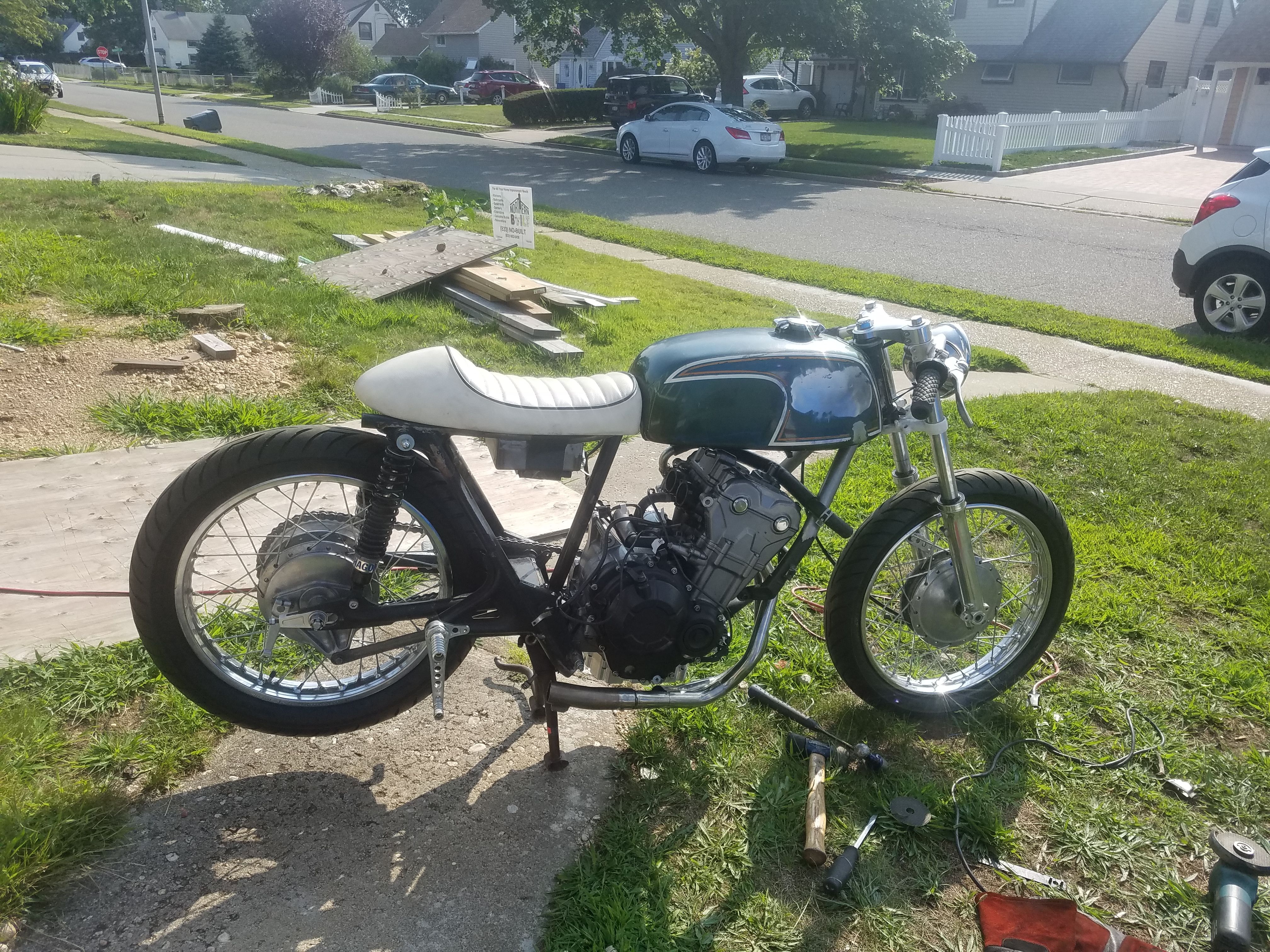

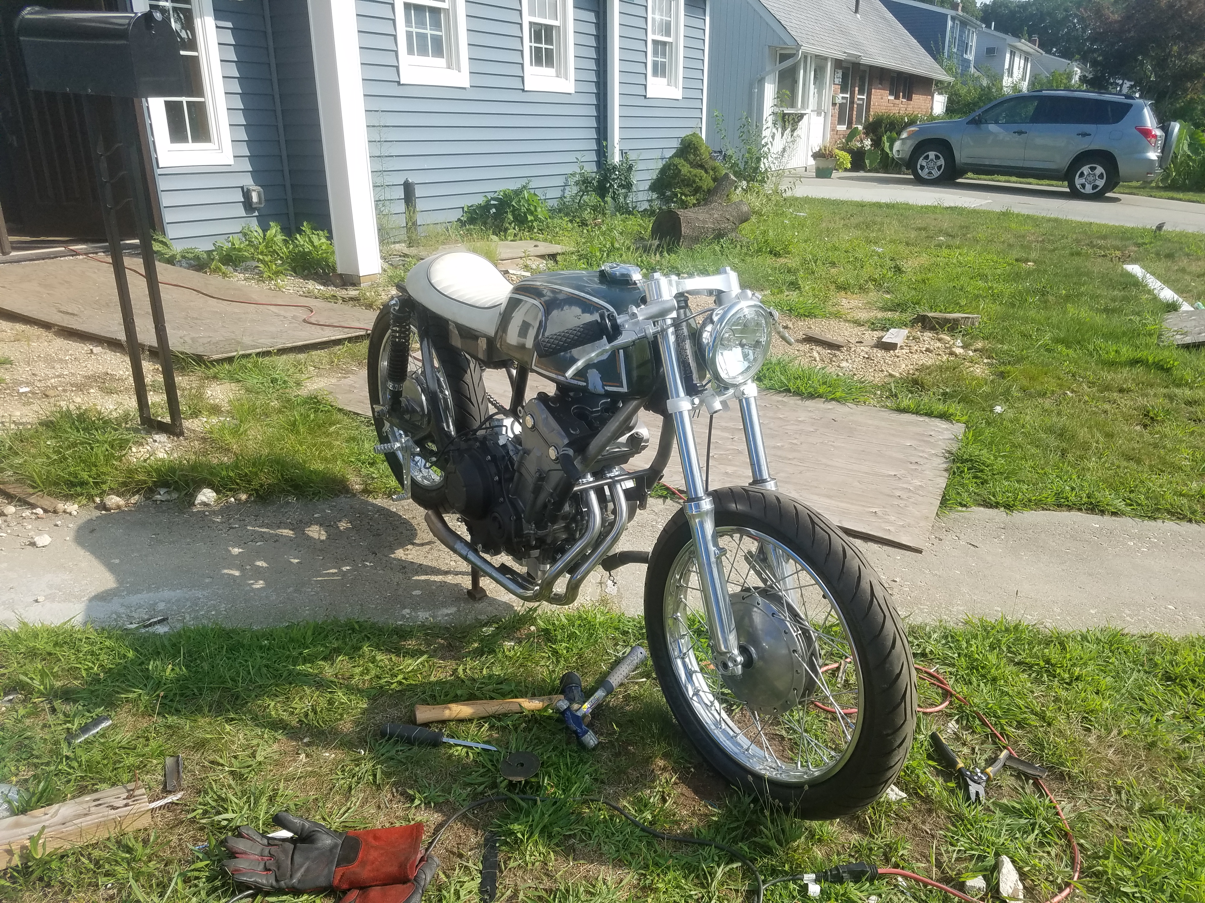

Ill take photos for you, its the factory pump for that motor.
Here it is on the bike

While waiting for the muffler I decided to strip the tank and start body working it. 1 coat of metal filler done, one more to go, then I'll use a glaze for the top coat. Man I forgot how much I like doing bodywork. Just watching all the imperfection go away is awesome. I'm going to fully bodywork the frame as well, really try to make it prettier.
Maybe it's the Ceriani-looking forks or maybe the big spaces in the frame but even though nothing on this bike is Italian, it reminds me of an Italian bike from the early 60's late 50's, very cool.
Thanks man. Those spaces are going to disappear pretty quick once I put the throttle bodies, intake, filters, radiator, and cover for the battery box on. It will still have that simple flowing look, but I wish it could stay like this. And yes that top clamp really looks like a beefier ceriani, and I don't think many people take the time to get every single casting mark out of the forks, makes a tremendous difference. Also a massive pain lol. I'm just excited fab work will be done in a couple more weeks, I started this a year and a half ago!
Factory headers actually look great (as does your collector). When I see 500s on the street they always seem so discolored which really takes away from the shape. Keep up the good work!
