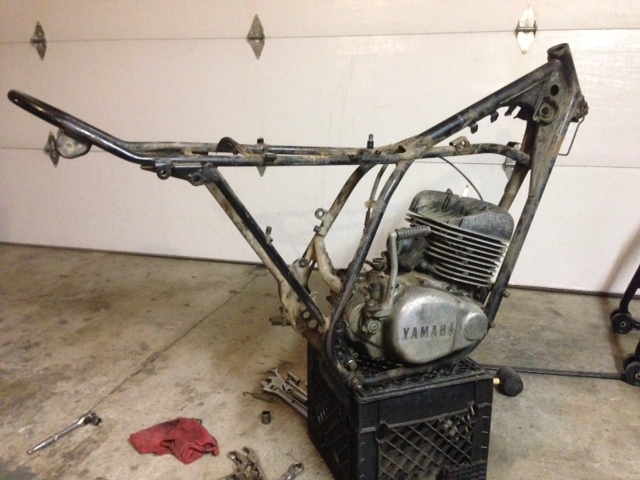

After tuesday evening this is how she sat:

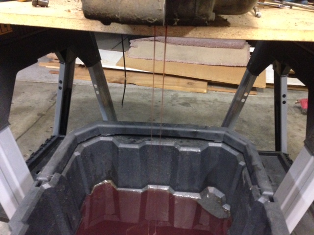

Wednesday night: Frame and swingarm stripped and cleaned. Forks completely disassembled, cleaned, and ready for new seals and oil. Popped the flywheel cover and it looks like this thing was submerged in water at some point. Haven't had a chance to pull it to assess the rust damage. Drained the oil...looks brand spanking new.
