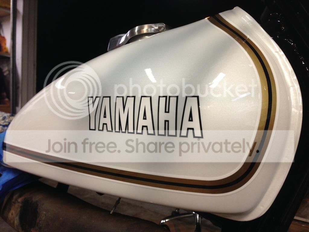

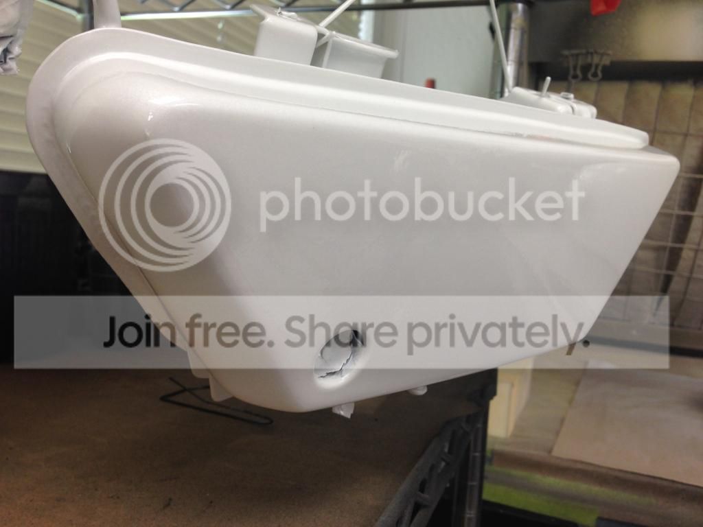

Tank and oil can are painted. Did a white basecoat, then 2 coats of clear with some pearl added. Still waiting on decals before I spray another coat or two of straight clear.

Paint is finally done.

Thanks Floyd. The tank is too damn pretty to use now. Better find another I can take to the track.
