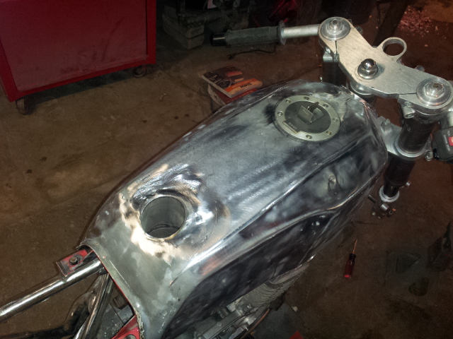

I started to work the dents out on the tank the cross over pipe is broke off ans the key is bent at 90° soooo. I cut a big hole in it for a flush mount fzr cap cap is just sitting there in the pic. I wonder how many rd400 tank im gonna distroy

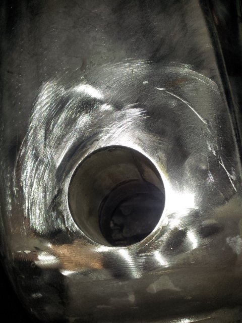

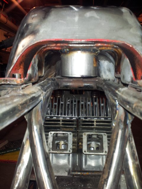

Last night i decided to try to clean the shop. im in the middle of a few seat builds and the clutter was becomming a issue. After i got the worst of it i turned to my rd befor going to bed, a few mins later i had another 2 1/2 hole through the top and bottom. i ran a hunk of exh pipe through the tank cut it to lenght and welded it out. this tube is the begining of my oil tank. i learned a few things from my last tank simple is the key

This cap will be atop the hole when all is said and done and a small box will be underneath for a res the tube it self is around the size of a small tube of spectro. and should mix a little more than a tank of fuel as it sits.

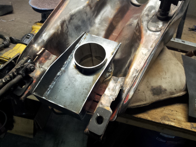

Oil tank work

Not finished yet i still gotta weld out the bottom, the fill cap and a few supports.
