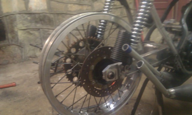

Laced my new wheels i took a chance and bought rd350 front spokes and laced a wide high shoulder 18 off the rear of a old mx250 yamaha. and a xs650 front hub so i could run fzr rotors and the rear is a high shoulder off a xs650 with a yz125 rear hub and spokes if nothing else this bike will stop

Re: Time to make the rd look like it runs haha
If only i had a friend named bigrich that was good a truing wheels ;D
It's easier than it looks. The rear is already in a "truing stand" and all you need is a sharpie. Do concentricity first and side to side wobble second.
Spin the wheel slowly with a sharpie held somewhere convenient to the outer edge and let it touch the rim at the high spots. Loosen the spokes closest to the mark 1/4 turn and tight those opposite to pull the rim gently. When that's close do teh same from the side of the rim.
Try to avoid overtightening and it will get there faster than you think. You do need a decent spoke wrench though.
Yea im not looking foward to it teazer. but ive wanted this wheel set for a long time ive built them in my head several times with diffrrent rear hubs ive had but for one reason or another the yz hub stuck and i finally got off my ass put them together

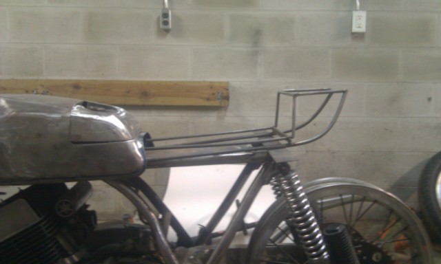

I couldnt keep putting it off so i started on my seat
More
Yep
And this
Bingo
Awesome I really want to build a seat like that. I may give it a try tomorrow. But that is definitely gonna look cool.
As always man nice work and looking from the top down looks great but from the side it looks lil tall or it just me ? Seems like its missing flow from the tank to the tail ? JMTS bud !!!
