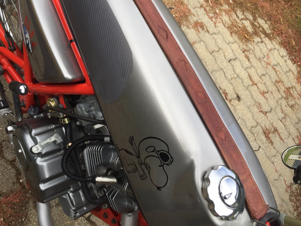

Hi Acethusiasts, Hi Tad,
we talked about putting on some nice piece of leather on the ACE. So I took a belt of mine, and here it is. Brown leather on black ACE (Problem: Now I loose my pants... :D )
Rgds
Kevin
