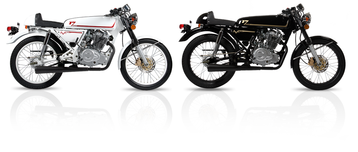

some of those photo shots at moto scoot are for the "swift 250", its the same as the ace in most respects except it has an ohc 250 single engine jammed in there, makes me worry that it has the same brakes as the ACE.
the swift is a USA only bike atm
http://avavelocityworks.com/models/swift-250-specs/
