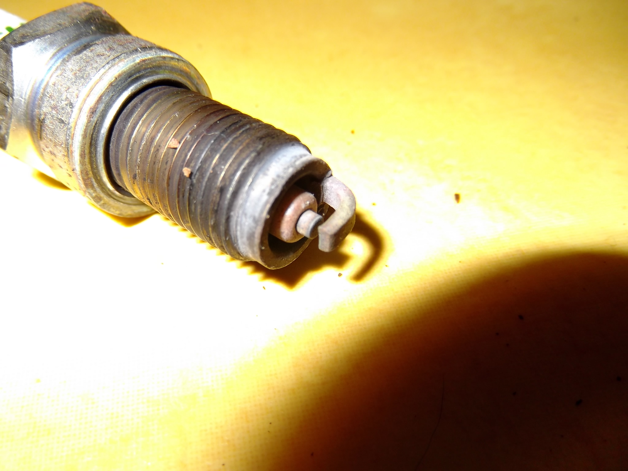

stock plug after 3700km running stock carby and jets but a 38mm header and muffler. not looking too bad , no pitting or burning. the tip and electrode look clean , ad it is running a touch on the lean side, but thats normal for these engines to get past emissions.
