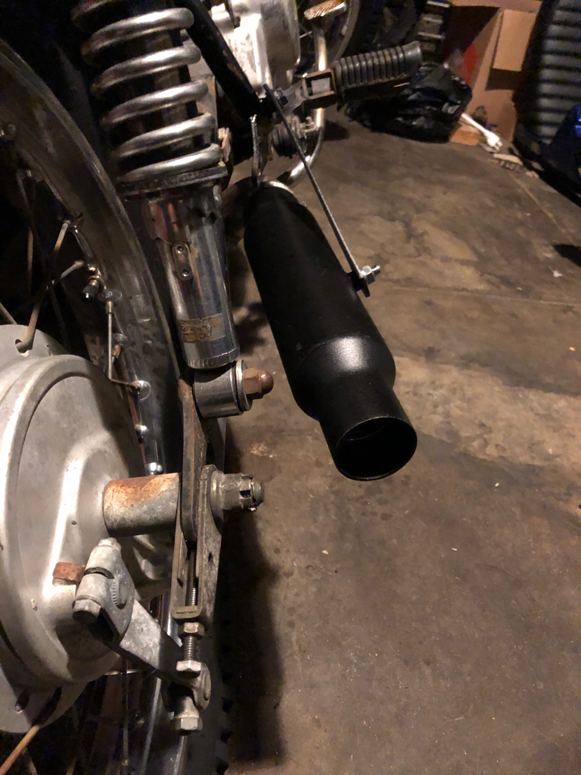

Finally got the muffler attached. My excuse for taking so long is it getting dark early and working too late. Lame excuse but that’s what I’m rolling with.

if you're gonna use a hoseclamp to secure the muffler, I would suggest a "constant-torque" clamp, they are much more heavy duty and usually have a cleaner looking band.
Yeah, that clamp is gonna come off. Thought it might work and had it laying around but noooooope. I’ll look up the one you mentioned, thanks!
I'd also suggest putting the hanger strap behind the muffler. 1) It'll look better. 2) Keep things out of the swing arm more.
Also, if you really want the shortys to work (at least a little), you need to pull the baffle and re-wrap it with some much better packing.
I agree it would look better with the strap behind, but I feel like there was a reason I decided to do it outside... Honestly I think it might've just fit best that way since I ended up welding the pipe at a bit too much of an angle coming back towards the shock :o
It's going to ROAR with that little muffler LOL! You may find yourself doing a little carburetor tuning when you get it on the road...the exhaust and air filter may lean it out too much, especially at full throttle...but that's not insurmountable.
Carb tuning will be fun
So I took a peek at the muffler, mount is on the outside cuz if it was inside it would be way too close to the swing arm for comfort.
