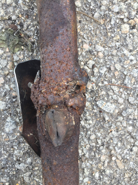

Exhaust showed up!
They're not pretty (check out that huge booger!!) but I think they'll work for now. Once she's running I'll look into cleaning them up and MAYBE doing a 2-1 setup. But getting her running is more important. One of the header clamps is missing so I need to get one, and I only have one crush gasket so another one of those will be ordered as well. Getting closer!
yorkie350 said:
sure it aint a false leg ::) ;D ;D
;D LOL ,it does look a lot like a weird type of 'knee joint',yes? ::) :D
someone's poor attempt at trying to apply weld.. I wouldn't do much better myself as I've never owned a welder or took any lessons but do desire to take lessons.
The weld is pretty funky, but I'm not sure I'd be able to do too much better I've never welded exhaust pipe.

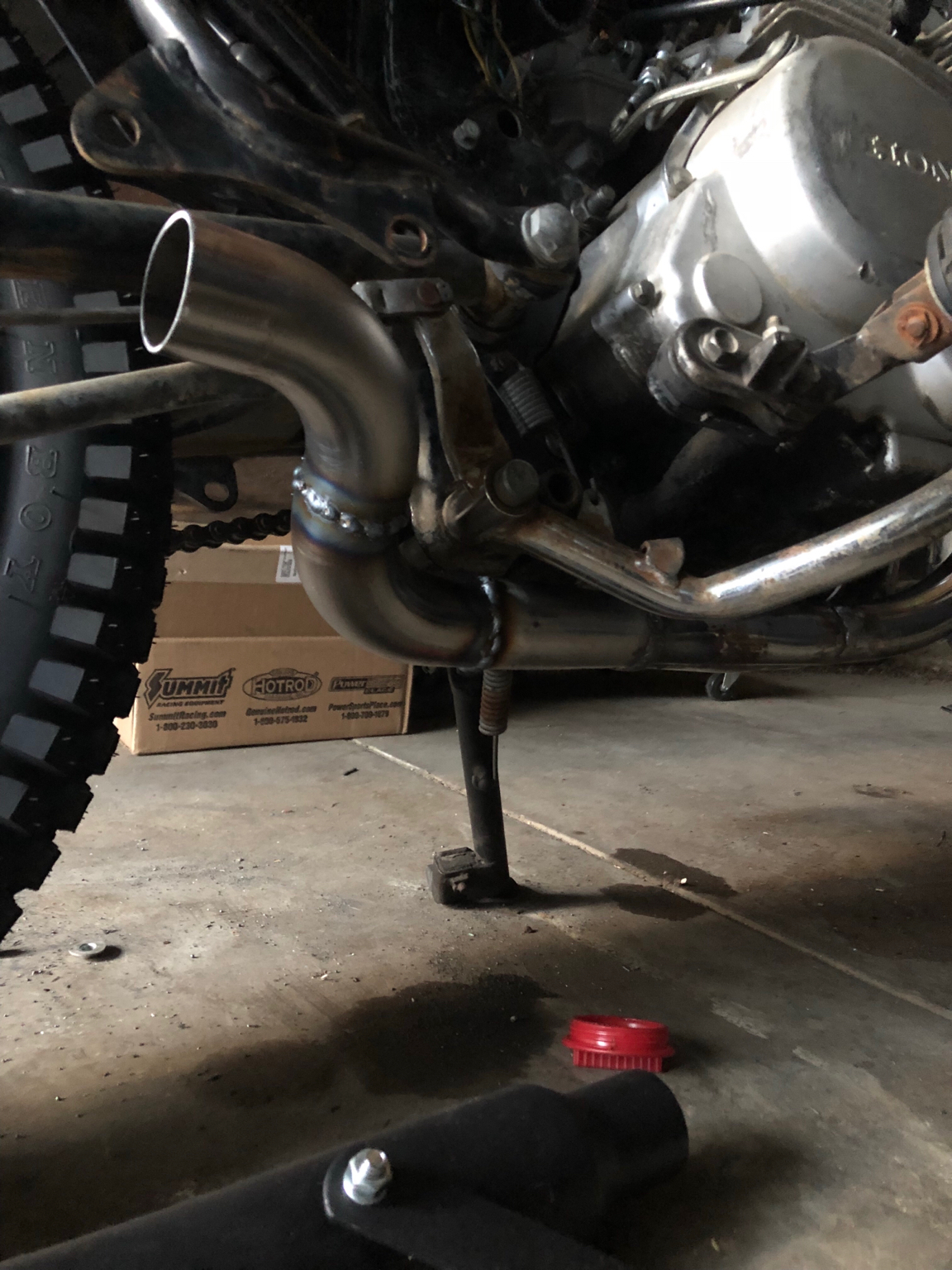

Here’s a quick shot of the collector and pipe... 12” emgo bullet muffler is gonna get bolted on to the end.
