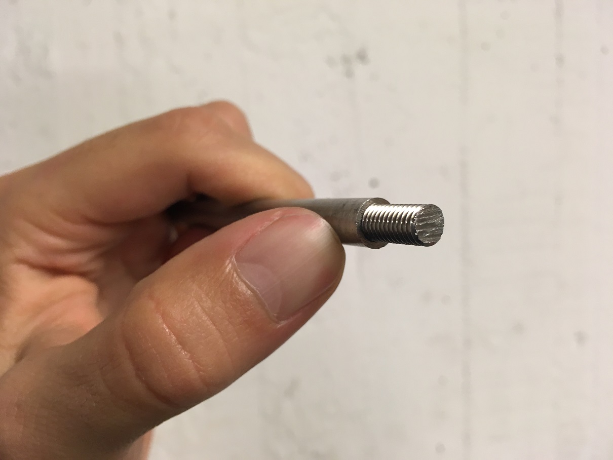

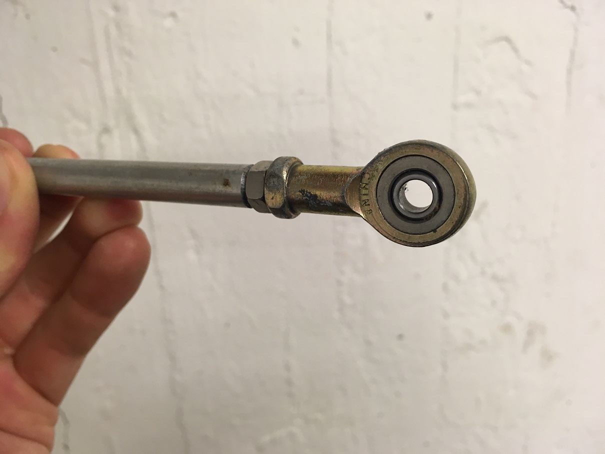

That would work. Might be better if the linkage were machined in a stepped shape to allow the actuating rod to be straight.
Exactly. I figure if I am going to be drawing up a custom linkage for the rearset (to create mounting points for the return spring and the brake light switch on the underside), I may as well include some smart geometry to reduce the offset in the z axis.
Over the weekend I managed to find some stainless threaded rod at a local hardware store, plus some stainless tube that fits it exactly - a little bit like the kits you can get from DCC or Lowbrow customs - except they come with alloy tube.
I think this will do the trick - should be well strong enough. Also, in the last pic, you see the linkage bracket that I will redesign to include some of the required offset plus a spring connection on the underside.

out of curiosity, why go with stainless tube if you're concerned with weight, I imagine it's almost 3x as heavy even if it's not much. also - I used carbon fiber tube on my brake actuation rod for my bike, it's stronger than the alloy - nearly impossible to bend and took quite a bit to break in the harbor freight press.
Carbon fiber would only work if the rod could be completely straight - I need two bends in this case. Unless you laid up the carbon yourself to the shape/bends you wanted?
The stainless is heavier yes, but by very little - it has a 1mm wall thickness as opposed to the aluminium tubes 1.5mm wall - which evens out the weight diff a lot. I figure I want this linkage to be strong and because this rod will save at least 500g over the original linkage idea (with two rods plus a linkage arm, plus a pivot axle).

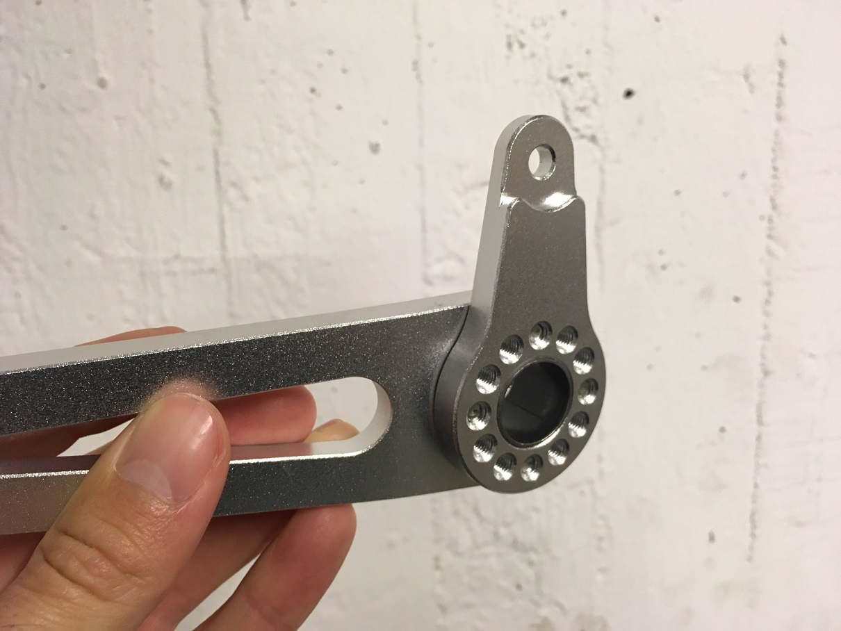

Did a bunch of stuff over the weekend (last weekend) and just posting now. I tried making my own slide hammer to pull the tank dent - by gluing the end to the dent and hammering. Failed miserably. Lots of things wrong with it. Anyway, decided to order a dent puller kit from ebay for 8gbp, be interesting to see if it works.

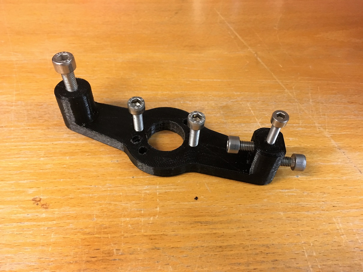

I also prototyped the rearset linkage bracket a couple times and think it will work good. Managed to get in all the details it will need plus a nice 25mm offset so the linkage rod doesn't have to be bent so much.

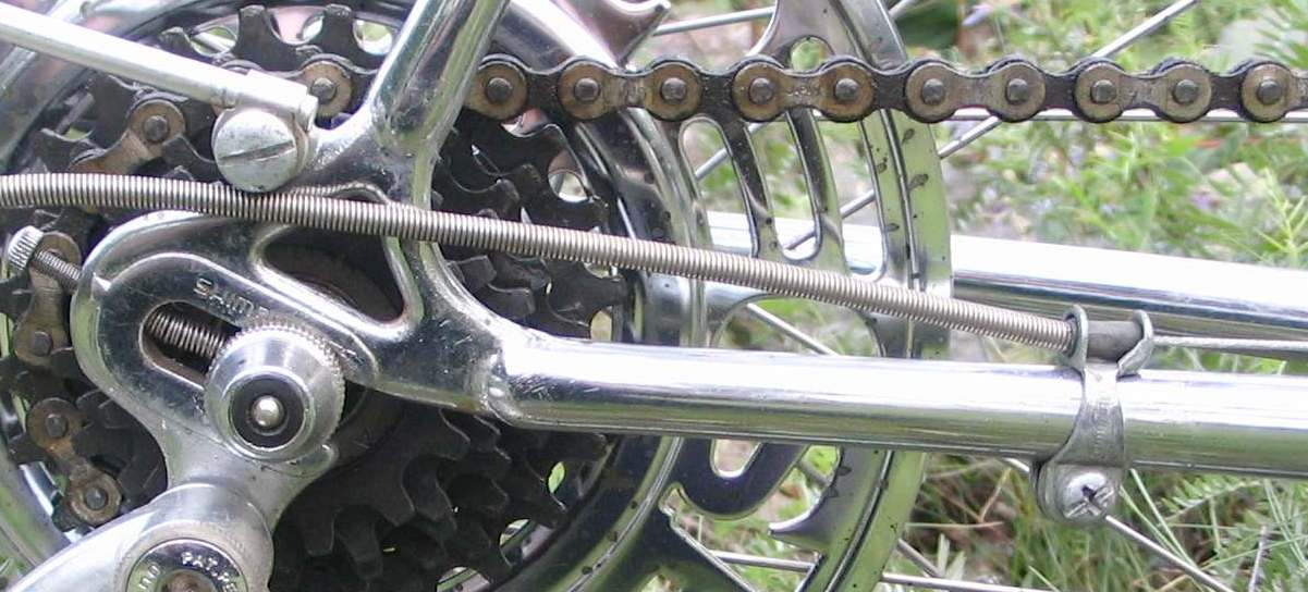

Having plowed a fair bit of this ground myself, I have a couple of observations. There is a lot to be said for a linkage system, but there is a requirement that is often so difficult to meet that a cable starts looking very appealing. The issue is a result of the suspension motion. In order for the action of the pull rod to be constant while the suspension moves, the pivot point where the crank arm connects to the pull (or push) rod must be coincident with the swing arm pivot. Any other location introduces undesirable motion into the braking system as the suspension moves. Obviously this is impossible to achieve, as the pivot is not stationary, and can only be ideal at one brake pedal location. Fortunately, the problem is a matter of degree, so as long as the problem is small enough so as to be (mostly) unnoticeable, it is not a problem. Unfortunately, there is a quite limited range of locations for this pivot where this problem is, well, not a problem. The stock location is pretty much the only good place. On virtually all bikes, you will find this location as close to the swing arm pivot as practical, and very close to or on, a line drawn between the swing arm pivot and the rear axle. Even very small deviations from this location will create obvious problems with the brake actuation as the suspension moves, though the seriousness of the problem often depends on who you ask. Moving this pivot point fore and aft along the center to center line is fairly benign. Moving it up or down off of this line is not. Your location is high enough to be very noticeable to your foot if you apply the brake and have substantial suspension motion at the same time. Opinions vary. On a street bike it might only be an annoyance, but it would be intolerable on a road race bike. The farther away from the center to center line, the worse this will be, and if far enough away combined with sufficient suspension travel, it is even possible to lock the brake even with zero pedal on a hard enough bump.
You can see how this works by taking off your shocks and while observing your brake pedal, moving your suspension up and down. You will have to first adjust your brake to be off of its return stop to see the motion. In operation, with the brake applied, you will feel the mechanism "pumping" as you travel over bumps. This phenomenon is present in ALL similar mechanisms, even stock configurations, but it is small enough that it is unimportant.
From the pics, it looks like you can lower this pivot to fall along the center to center line, in which case the issue will become insignificant. When I put a bike together, I determine where the pegs need to be and that is where they stay. If you are committed to the current peg location, keep in mind that the brake pedal axle need not be part of the peg. And if you have not already given consideration, the lever ratios are very important. It is very useful to measure the stock brake pedal length, along with the length of the lever that connects to the pull rod. You will need to keep this ratio, as well as the ratio between the lengths of arms at both ends of the pull rod in your new system if you want similar power required at the pedal for operating the brake. Just because this system is very simple, it does not mean there is not a lot to figure out if you want it to function well, and the fact that all stock systems are so very identical is worth considering. There is in fact very little deviation possible without real consequences, which is why cable or hydraulic systems are often the "go to" solution despite their increased complexity and expense.
Thanks for the input mobius. You managed to explain what I have discovered/realized with this linkage during this process. A mechanical linkage, no matter how 'optimal' will always be 'sub-optimal' in this particular application. And I agree, a cable set up would be much better. I think I'll weld a cable holder to the swingarm before powder coating it - just in case I need to redesign the rear set linkage and go down this route - I will try the mechanical linkage first. Besides, as you mention 'On a street bike it might only be an annoyance, but it would be intolerable on a road race bike' - absolutely true. A road racer would be using the rear brake a lot more eloquently than myself and would be annoyed by the weird feedback through the foot peg from the swingarm action. But I don't (hope) think I will notice it too much. Having the backup plan for a cable system already welded on place will give me piece of mind.
Check out the attached images for comparison of stock position for the brake link rod and the new position plus a forward moved suggestion position - which with the brake arm lever flipped upside down, would be a similar/comparable position to stock.

Maybe I need need to weld on a 'cable stop' as they are called. Looks like there is a bunch of either bolt on (drill and tap holes) or clamp on solutions available...

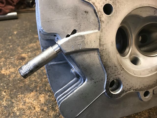

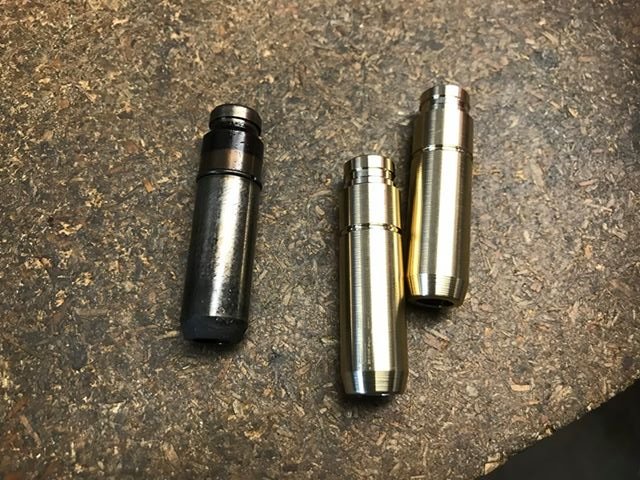

On a very different note, I got a couple of update messages from Chris this week. He said the exhaust thread detail in the head was too risky to weld up - too much heat distorting the head and too thin aluminium there. So instead he turned up an insert and threaded that in place (and added epoxy) then re-tapped that. It looks good!

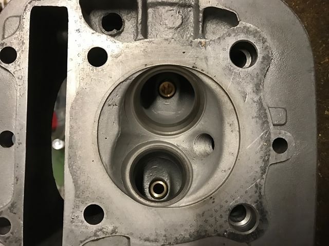

Plus he has installed custom bronze valve guides and turned up the custom Ti valves 8) 8) 8)
So happy there are pros that do this kind of specialised stuff, it is way out of my league.

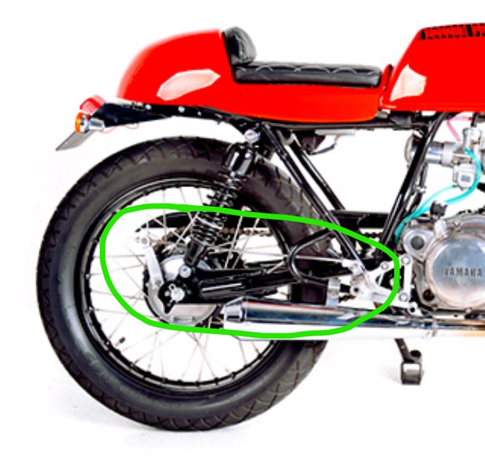

And while I've got you here... I notice on your bike you had a similar brake linkage set up! I guess the bike was long out of your hands by the time it was being ridden and therefore cannot comment on its action/feel/performance? The brake specifically I mean.
Personally I've never been a fan of reversing the operating lever like that or having rod pivot point too far from swing arm pivot. Always found it made brake 'grabby' (putting main pressure on leading shoe instead of trailing shoe) and the suspension operation was very noticeable
