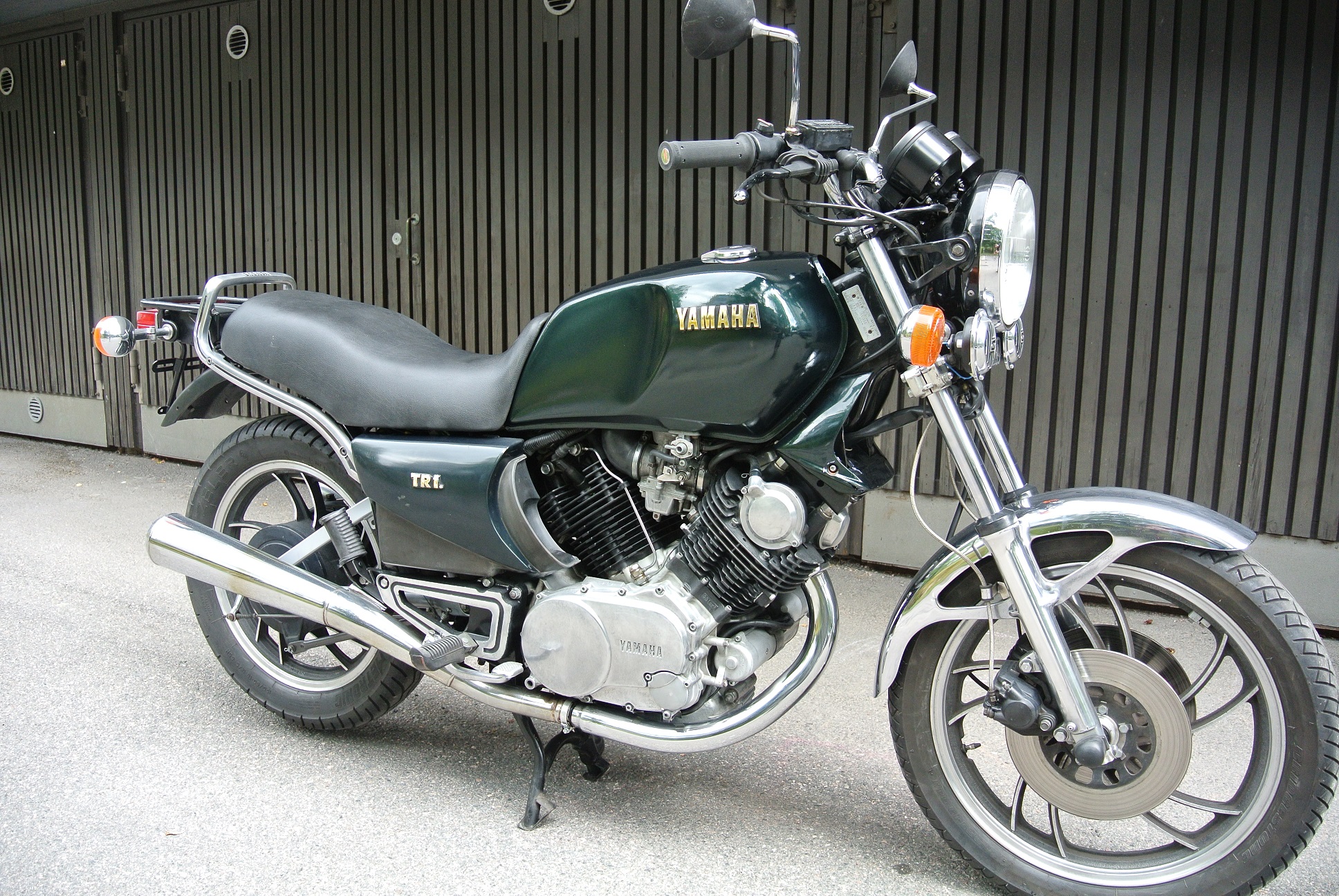

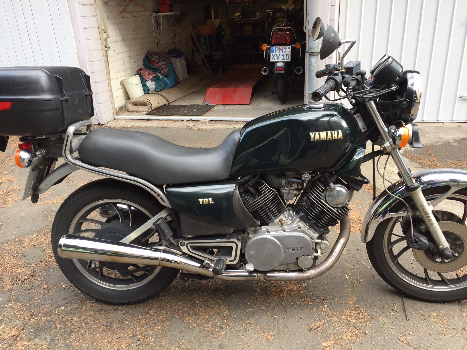

Here in Finland we need to 1st register the bike in original shape but then it's time for some mods.
So here's the starting point.

...oh and it's a 1981 Yamaha TR-1 1st pic is when I bought it and 2nd one is the cleaned up version, hope to get it to registration this week and then it's time for the hop up parts;-)
light- 172 kg with full tank 8)

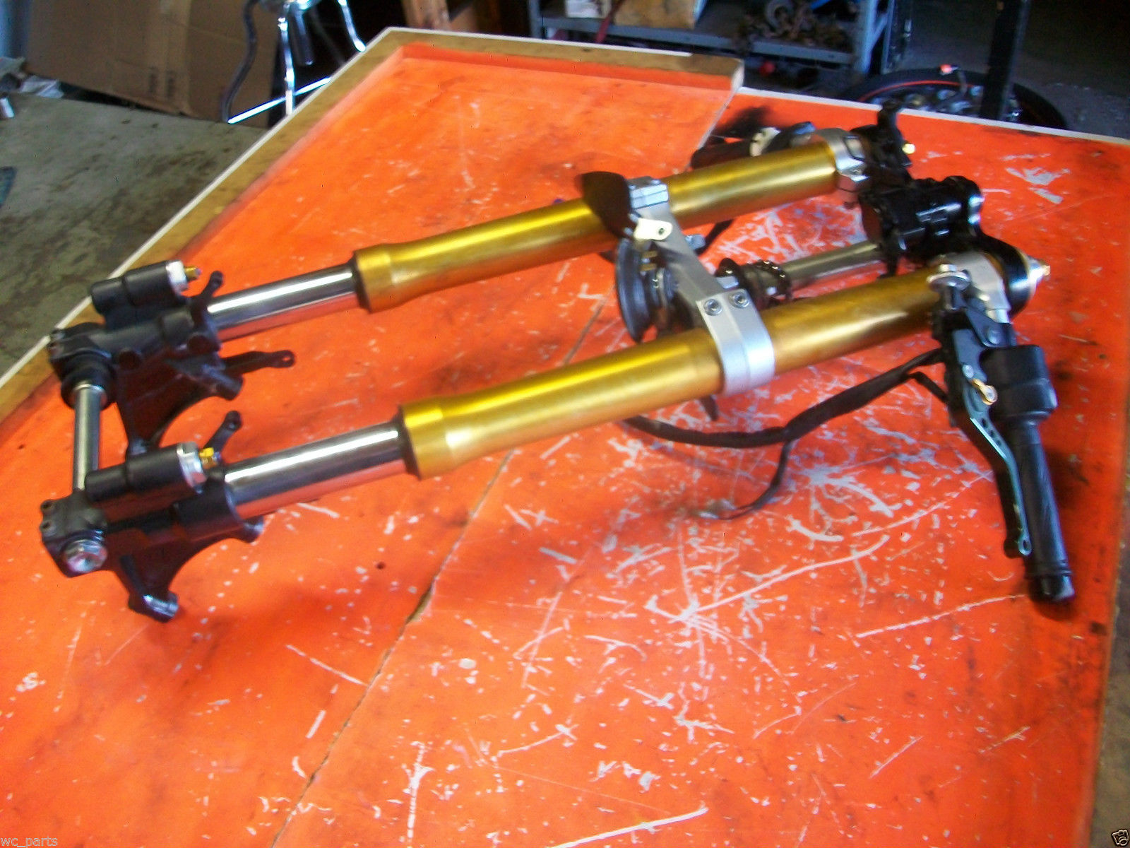

bandit forks are heavy, usd are much lighter, if you use a fork not older than 10 years

+1 for USD forks.

I think I will try to get my hands on some USD forks, but around 100hp should be enough for me :P (probably en up putting a turbo on the bike at some point....)

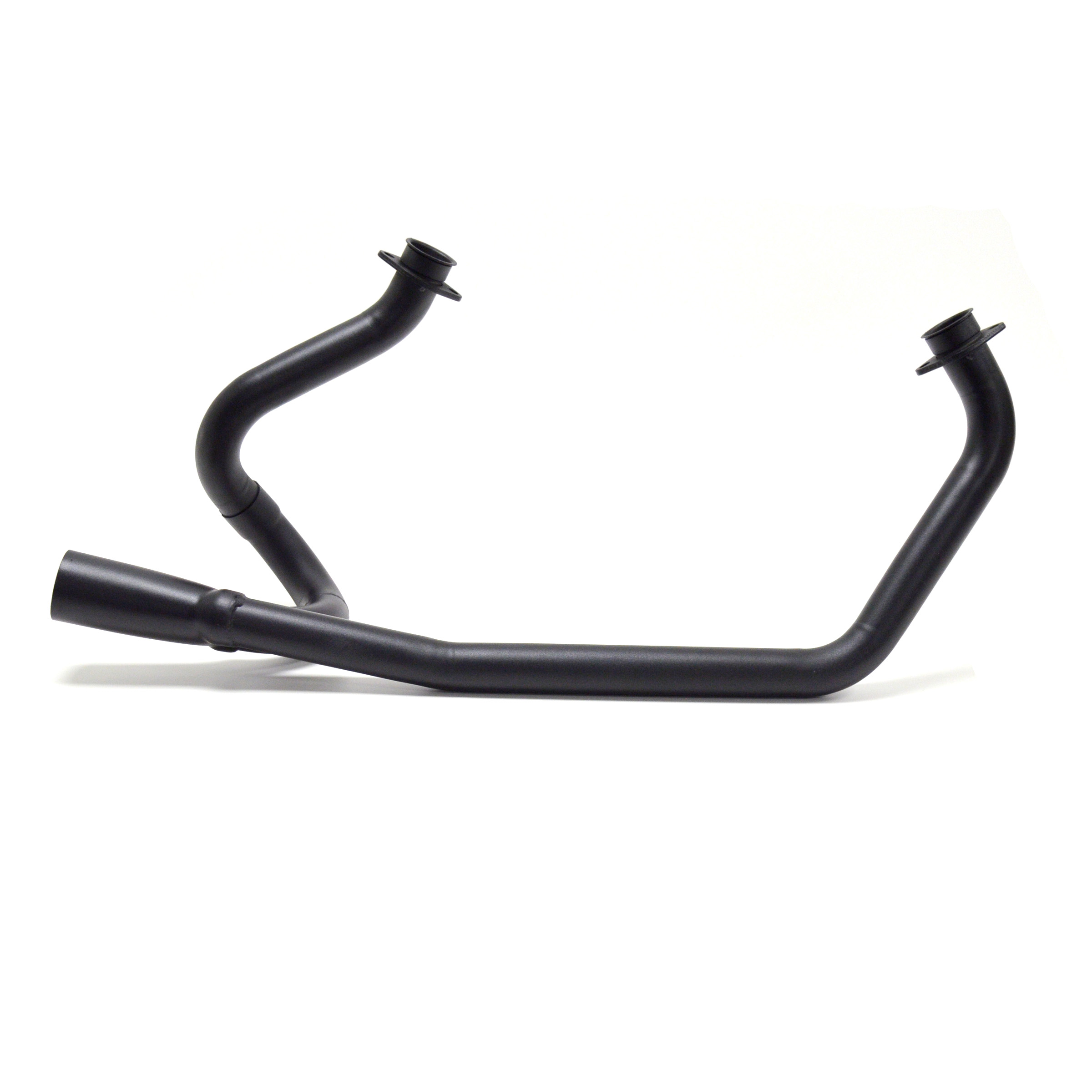

the exhaust is important, 2-1 is the best for power, but it is loud
the muffler of last year had an inlet-outlet 50mm on the dyno i miss with it 5hp on top and 10 hp in the middle, now i use an empty cone 55-100mm and down to 70
but if you reeduce the weight to 180kg, the stock engine is good enough with the dellortos

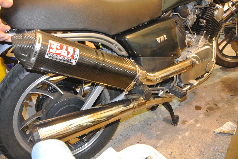

Yep 100Hp might not be too realistic, but I will be happy to 80+ hp figures, hope to get to it with a 2-1 exhaust and the Yoshi pipe pictured.
I had to settle with an aftermarket header pipes as I have no access to pipe welding expertise.

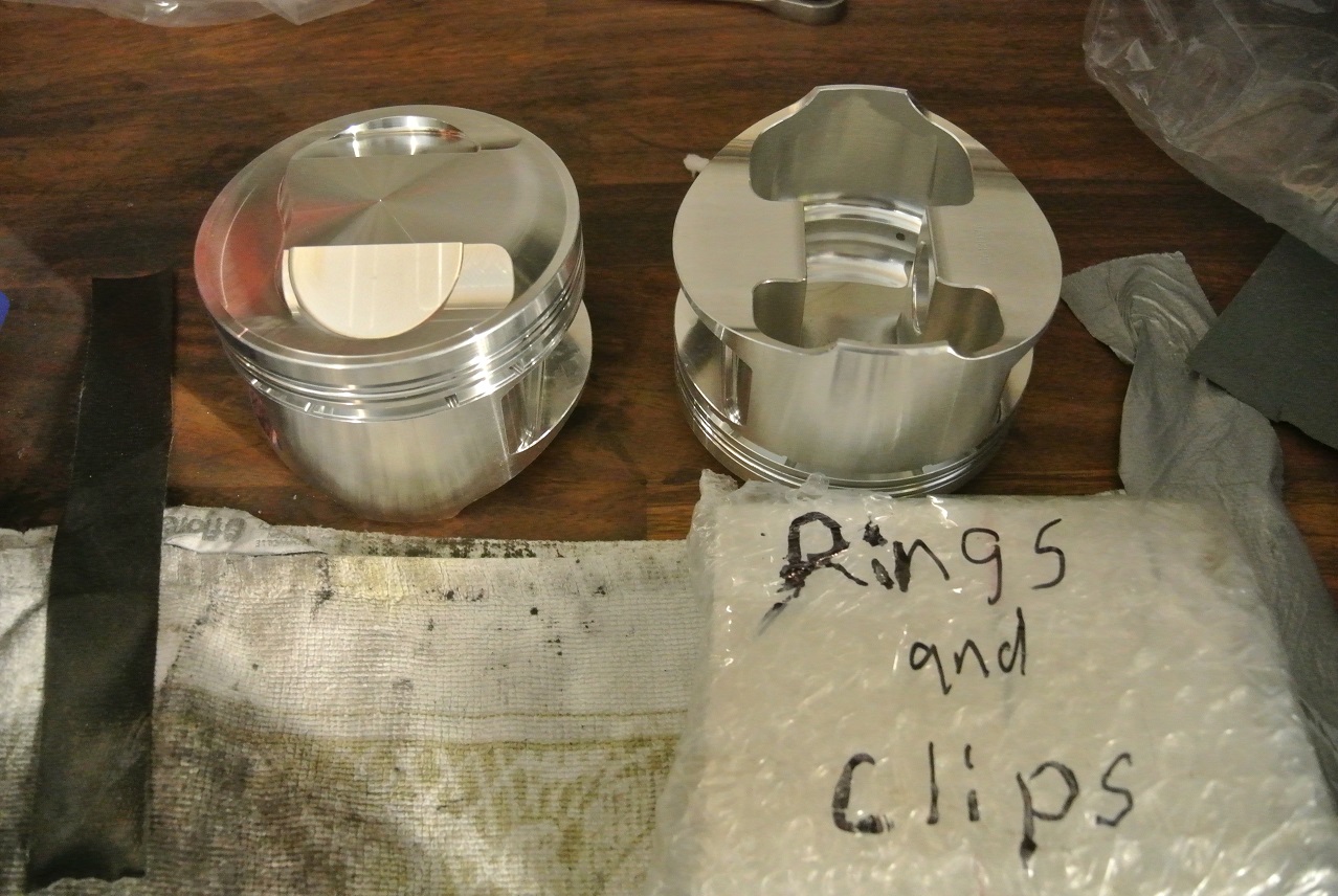

And the high compression pistons (should weight a lot less than the stock)
Compression release needs to be machined to the rear cylinder (Thanks for the tip MxHollywood ;-))
And then the Cam that needs to be ordered, I think I will also need to get new valve springs to avoid floating issues.

500€ should be enough for a pair, but I just ordered a R6 front end so the carbs might need to wait until next paycheck.

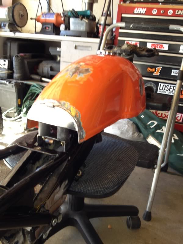

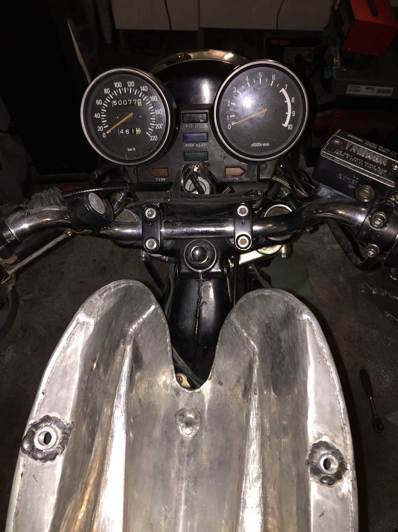

Did some fitting on the gas tank, seat and exhaust.
Seat looks to fit nicely and so does the exhaust (As soon as I cut the joint 10-20 cm shorter to move the can forwards)
But the tank seems to have a slight problem.
It does not go low enough in the front.
See pics.
Any advice, how to widen the front of the tank "tunnel" so it would go deeper around the frame.
The optimal place is just at the thickest part of the frame, so either I widen the tank or slim down the frame.
I'm betting the tanks needs to open up.

Modding the tank will probably be the easiest, if you have someone that has the skill to weld aluminum and have it look good.
Polished aluminum does look good, the transition from the tank to the seat will need attention too, it's the perfect time too, if you are already getting work done on the tank.
Can you shorten the pipe enough to bring it in line with the end of the seat? If not, the Exaust-Can could be shortened too, I have a Yosh pipe on my F4i, the sound is sublime.

J-Man, yep called a metal shop and taking the tank there later this week to see if widening is possible.
The tank issue is about to get solved, the tank is at the local welder who will do the same thing that was done to Stanley T's Mojave tank.
In Addition I'm planning on adding 35mm of lenght to the side/bottom in the rear so the backplate will integrate to the seat nicer.

Those pistons are my re-production design from Arias! The valve clearance is tight be EXTRA EXTRA careful on reassembly that you get the cam timing right, Countless viragos with bent valves out there. Get the viton valve seals while you are at it. Look at my thread near the end I have scope cam taking video of the clearance. Good luck!
Thanks for the heads up Hollywood, I'll try to make sure I get the cam aligned and in the right spot from the 1st try.
Would you recommend the viton seals an both intake and exhaust, I would assume yes, currently no smoking at all although there is 50 000 kilometers on the motor.

Yup viton comes in 4s. It's the cam to crank alignment your after. Not just the cam. Check before and after chain tensioner install.
