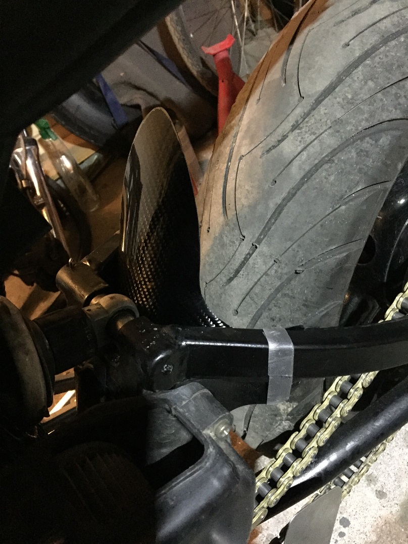

Installed a light mudflap to protect the shock.
Because I was too lazy to figure out the blinker relay not doing anything.
It's actually a mudguard for a mountain bike but might work pretty well like this also.

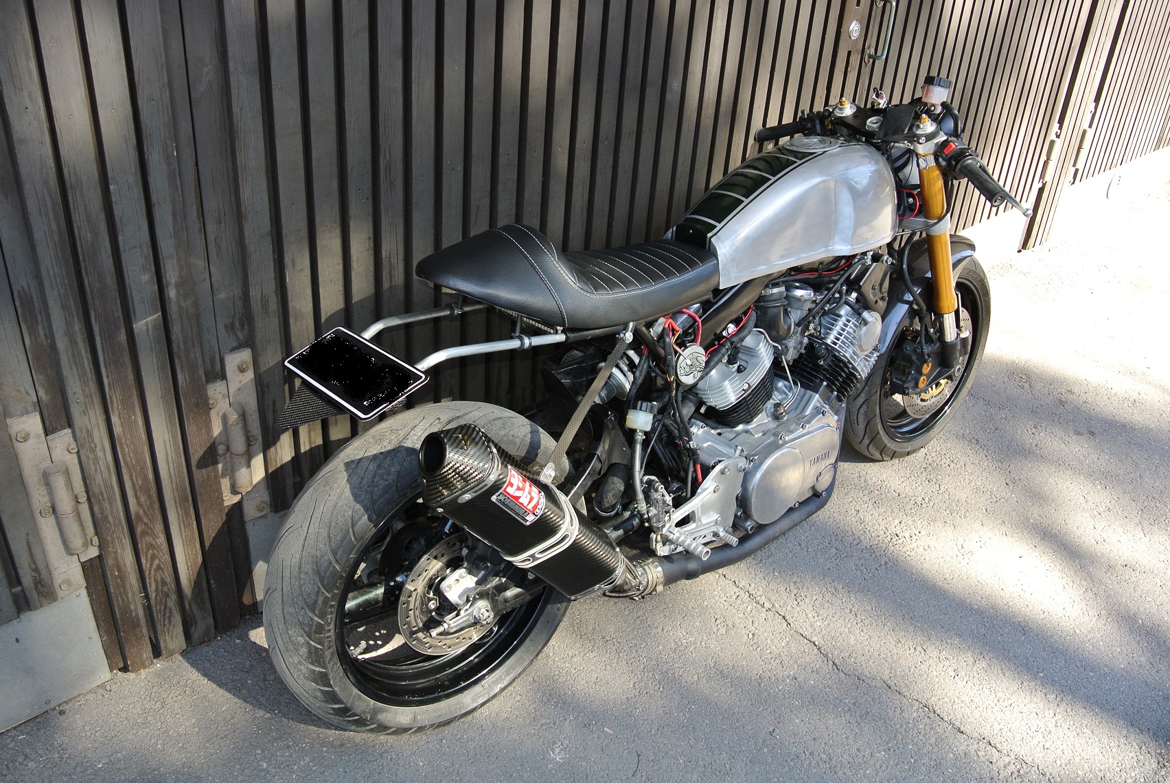

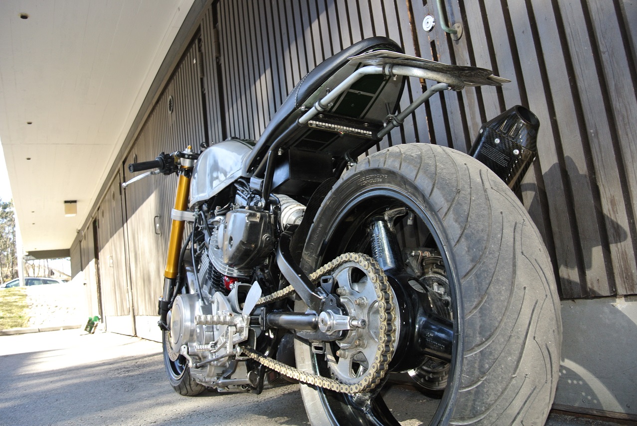

Made some progress, tidied up the electrics (not done yet!)
Added front fender (carbon of course because it's at least 10% faster)
Made an license plate holder out of aluminium tube.
Raised the front of the seat 1" to align better with the tank.

That old hedlund design sure is beautiful!
Brw i thought all finnish guys and their grandmothers were expert welders? ;)
With the plate rail, you need to cut a cardboard wedge template then an aluminum plate i use those aluminum clip boards for this stuff and form it to fit that gap, add a tail light bar(s) frenched in.
Amazing what you find at office supply
open-uri20130816-17199-3k7wy4.
DataDavid, Yeah my Grandma welds better than me, that's why I outsourced my welding to these guys: www.jarmax.fi they actually seem to know what they are doing.
Tune-A-Fish, I did not completely understand your clipboard design, but if you refer to the "underseat plate" gap, the seat is actually just a bit too loosely tightened so no need to visit the office supply ;-)
...did you mean Hageman design? http://www.hagemanmc.com/
Or Actually Hedlund design?: http://www.hedlunddesign.com/
Both look good to me ;D
Its said that this engine was designed by swedish engineer nils hedlund for yamaha, it looks very similar to the legendary hedlund v-twin which is a collectors item today, to be put in wild builds and ridden hard of course!
