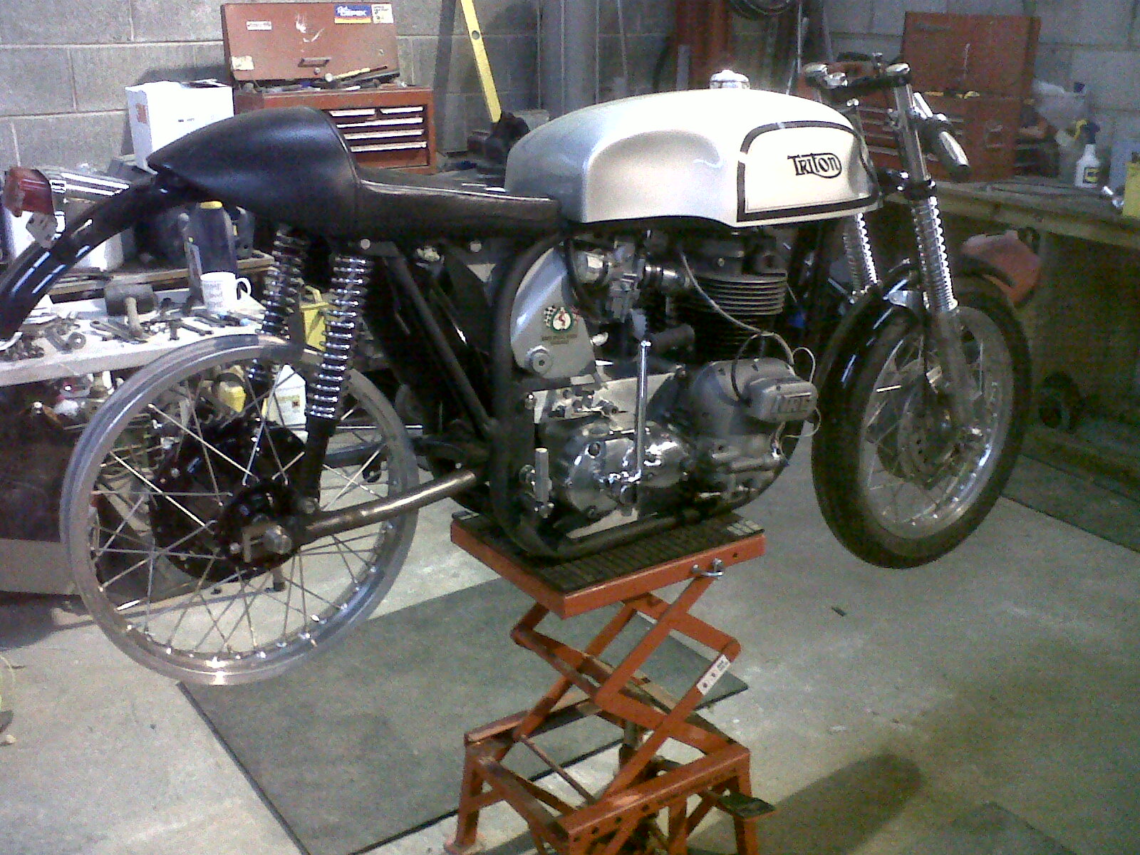

This is an old Triton I originally put together in 1993. Its now updated with a Nourish race engine, dry clutch so will have much more power.

Cheers, this is still the dry build at the moment, but I will be running it and testing everything before I tear it apart for frame painting and a detailed re-assembly. It will retain the tank I painted 20 years ago as that is still looking `fresh`, but everything else will have a show quality finish once Im happy with it.
It felt strange taking fittings off that where last tightened up 20+ years ago by me before starting work on it again.

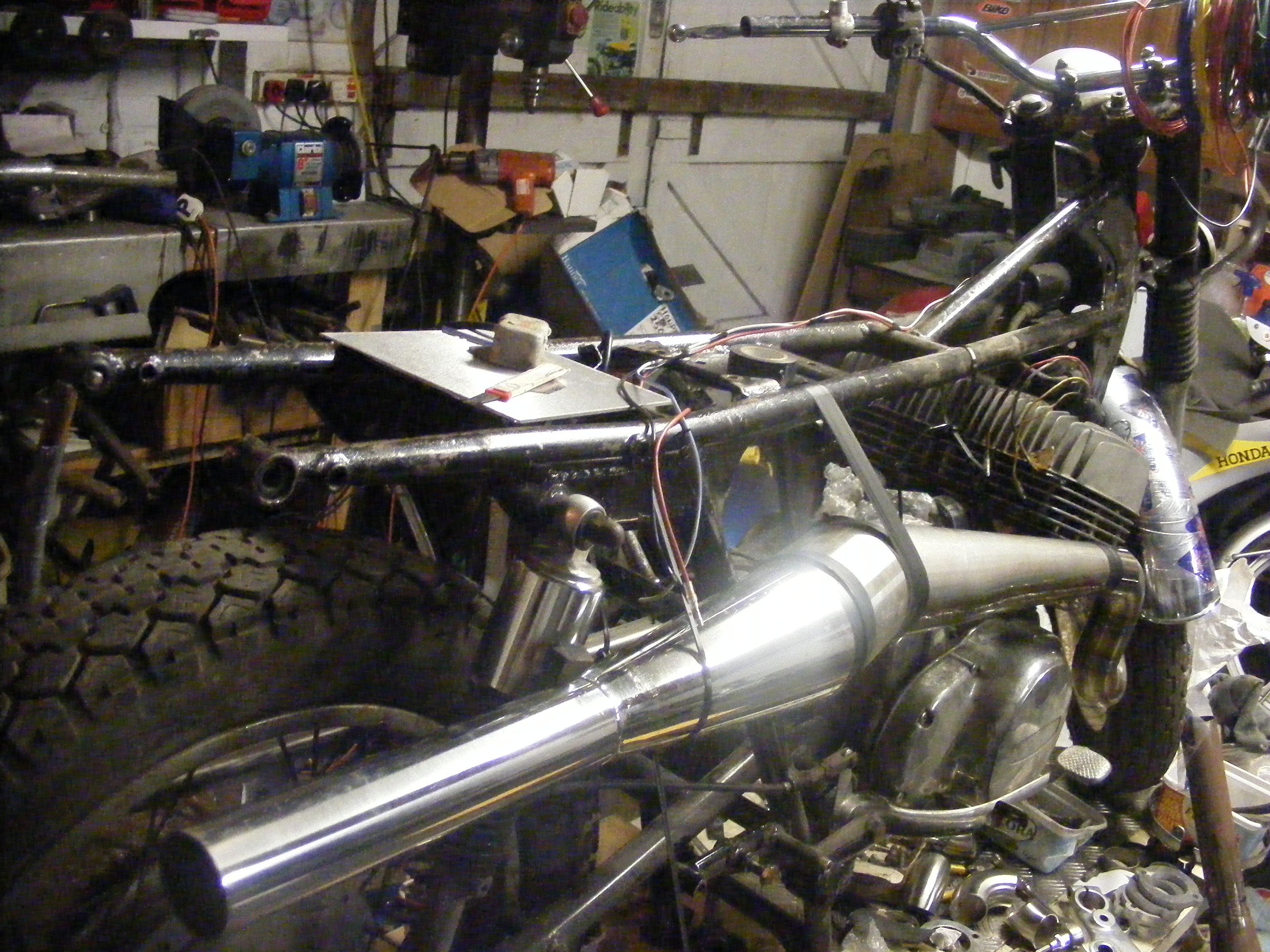

Couple of pics of engine and headers here. Took four weekends making the exhaust, but it was pretty interesting to do.

Back to the Triton....I agree, making the exhausts is probably my favourite job. It's great to use your imagination and come up with your own unique design. The pipes are a major feature of the build....everyone loves a trick system. We built this, 2 up one side set early this year, (for one of my 500's), and are now working on a street scrambler. After that's done, we are going to build an up and over system, exiting through the seat for my cafe T500..........

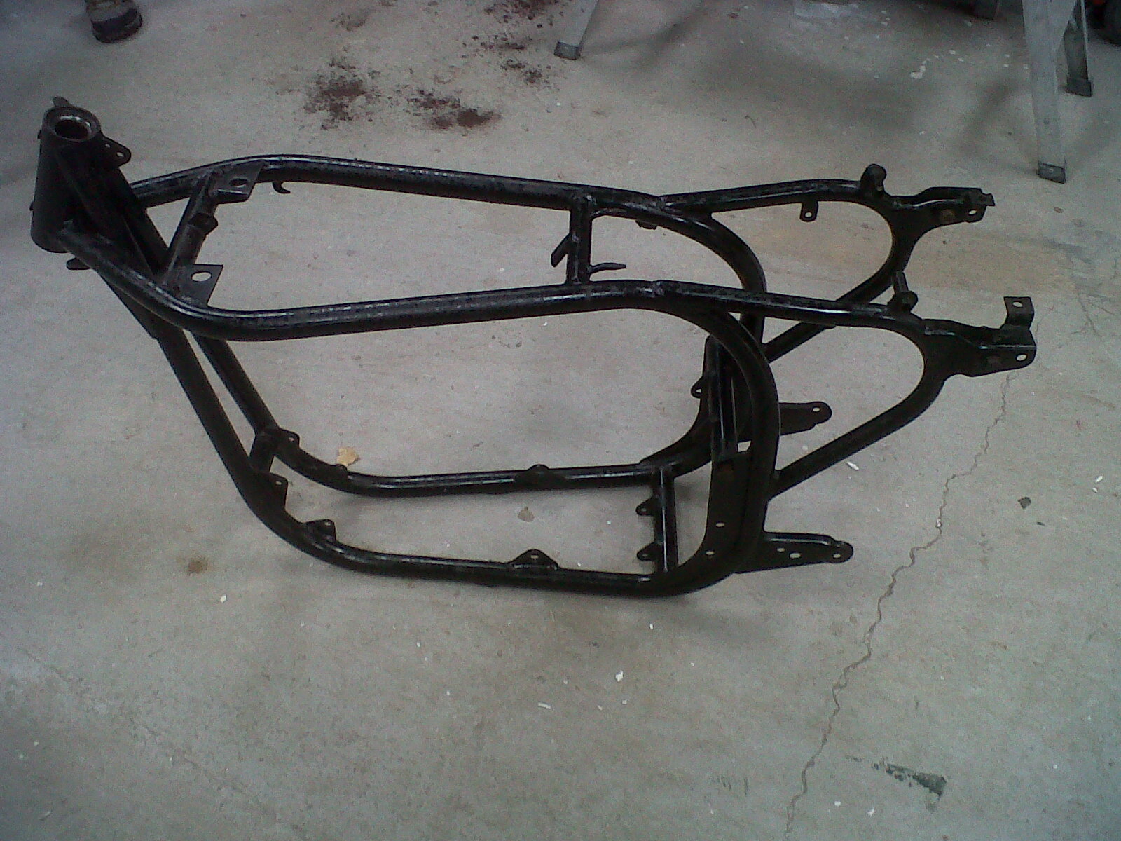

For a quick re-wind, this is what Ive been up to.............Here is my old frame, which was corroded badly, so I removed the back end, which was good and transplanted it onto a donar that I picked up

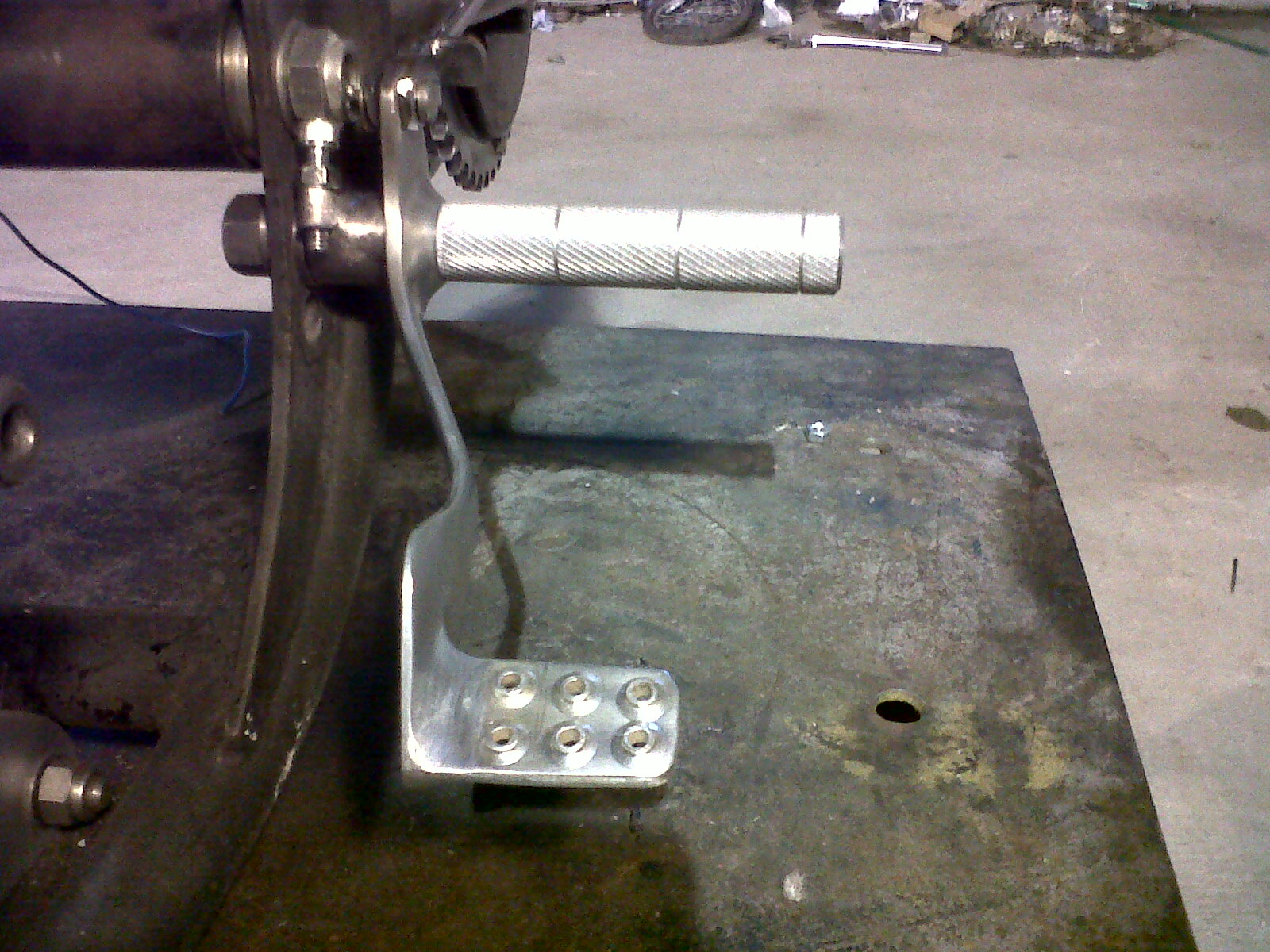

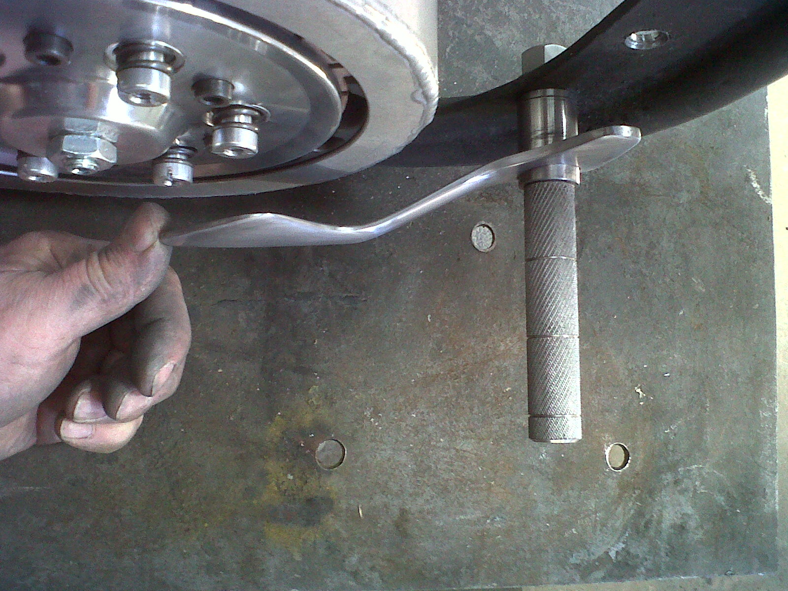

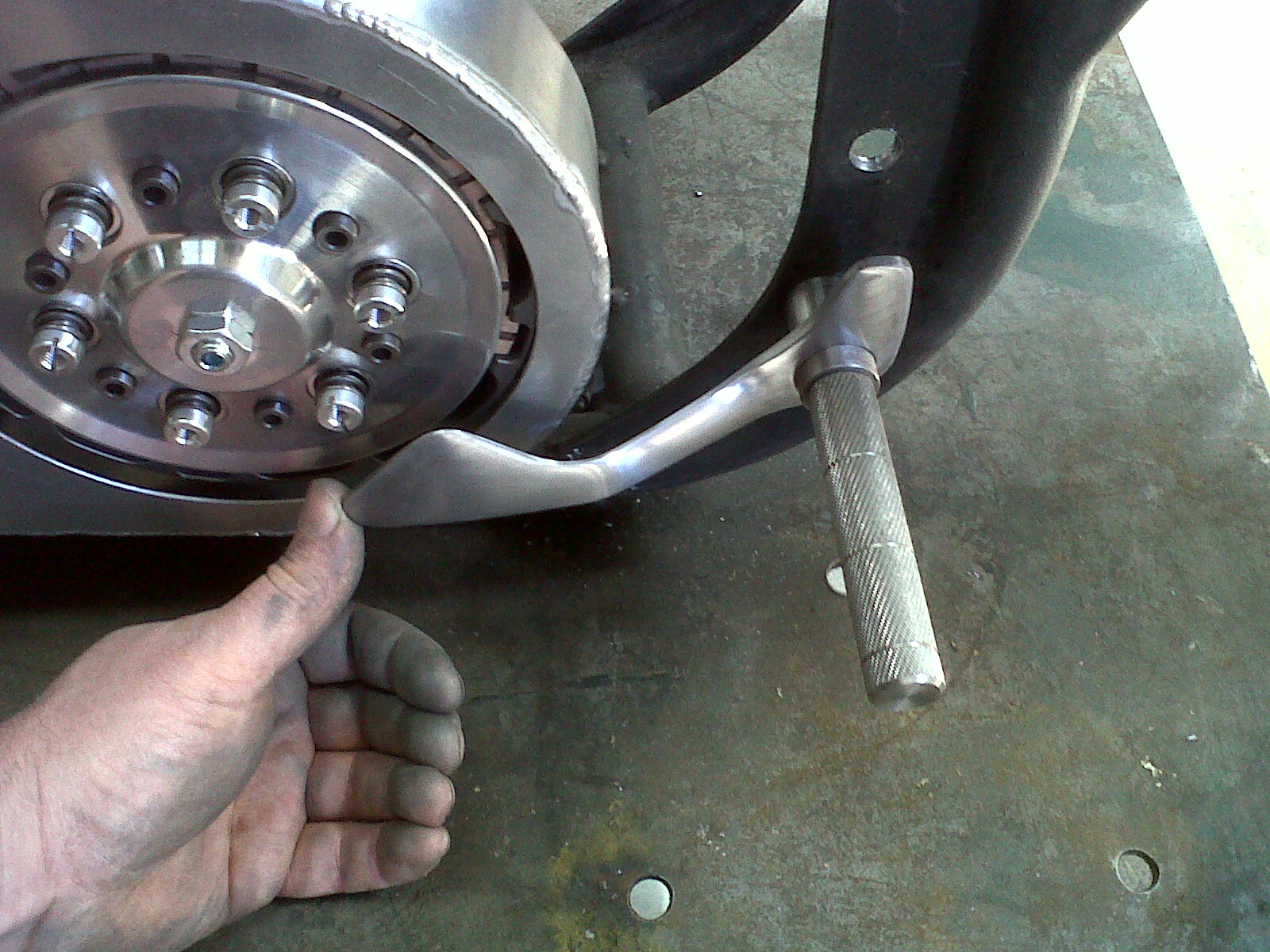

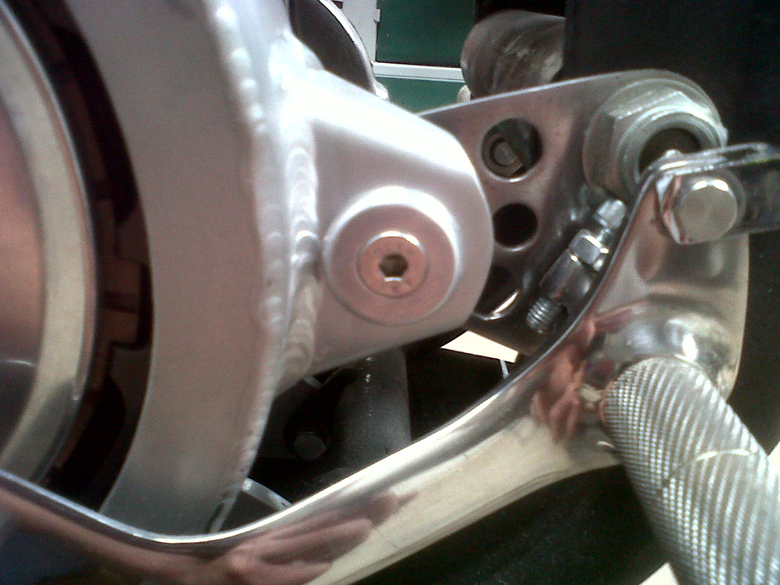

I made a pair of rear sets and needed a rear brake lever that could fit around the primary cover, so spent a couple of days shaping one up after a making a template from cardboard and alloy.

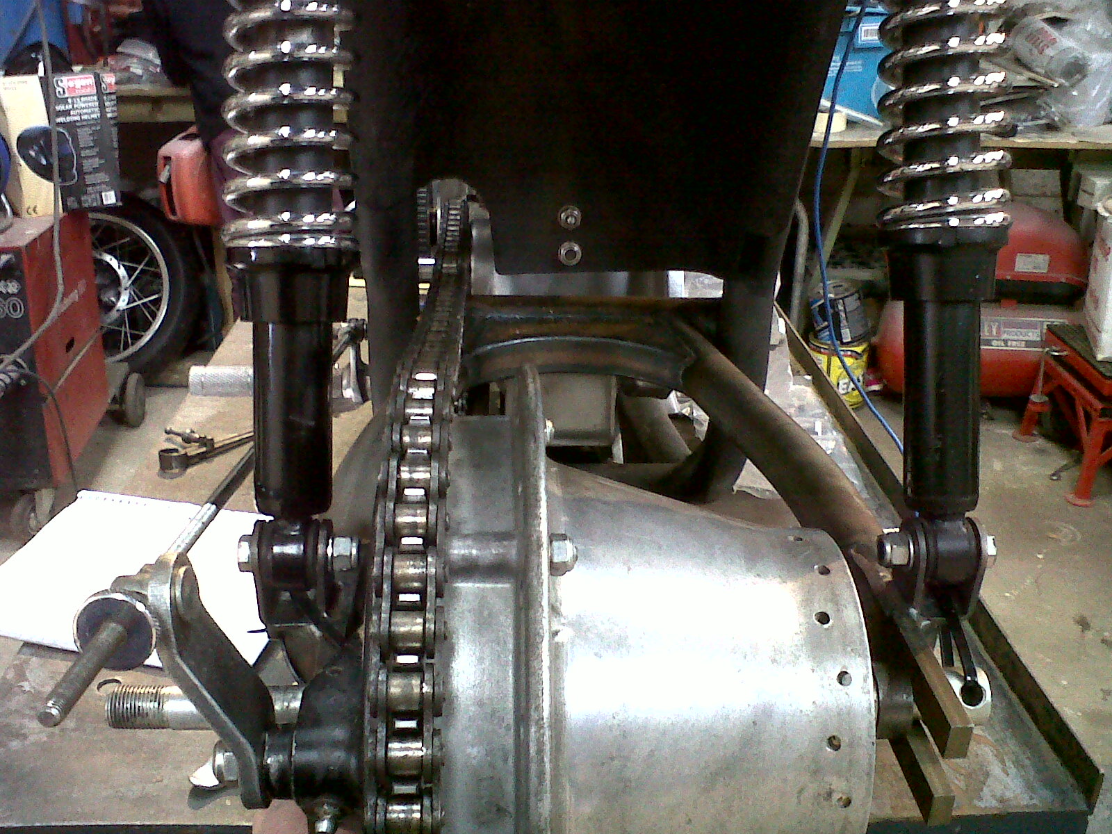

Picked up a Triumph conical rear hub and lined up the final drive sprocket in order that I measure up for wheel spacers that needed machining. Rear swing arm is wider than standard and came from Mick Hemmings. I can get a 120 rear tyre in this.

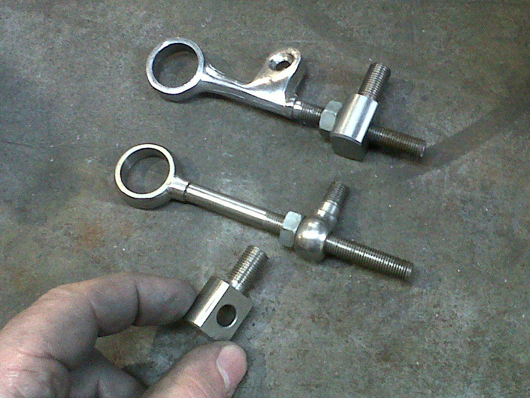

The engine plates I made where thicker that my original Triton plates, so my old gearbox adjusters where`nt long enough. Ended up machining a couple from stainless bar.

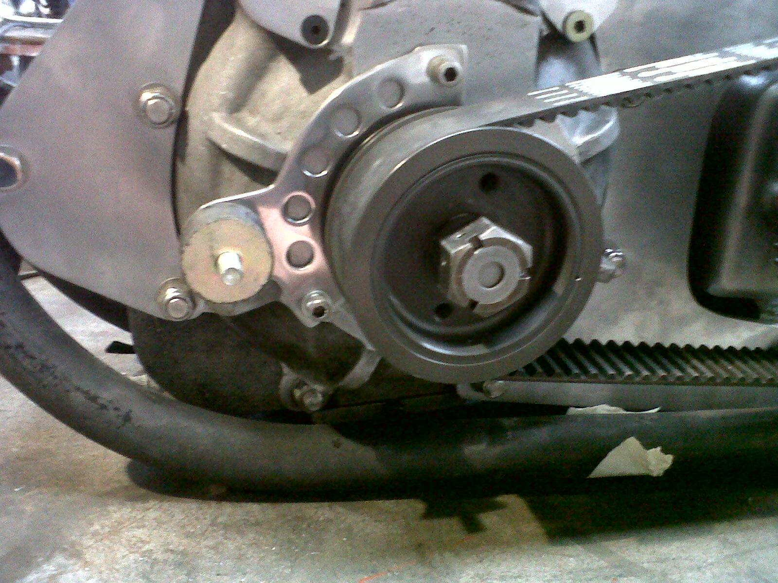

Only one pair of hands, so I get the tape out to hold things into place for marking out. This is the rear bracket for the primary cover. The section that bolts onto the frame is steel, so will be nickel plated when the dry build is finished. Rubber mounting stops the alloy cover from cracking.

Similar thing for a front bracket, but I changed the rubber mounts so I could use taper head studs with machined washers to make it neater.

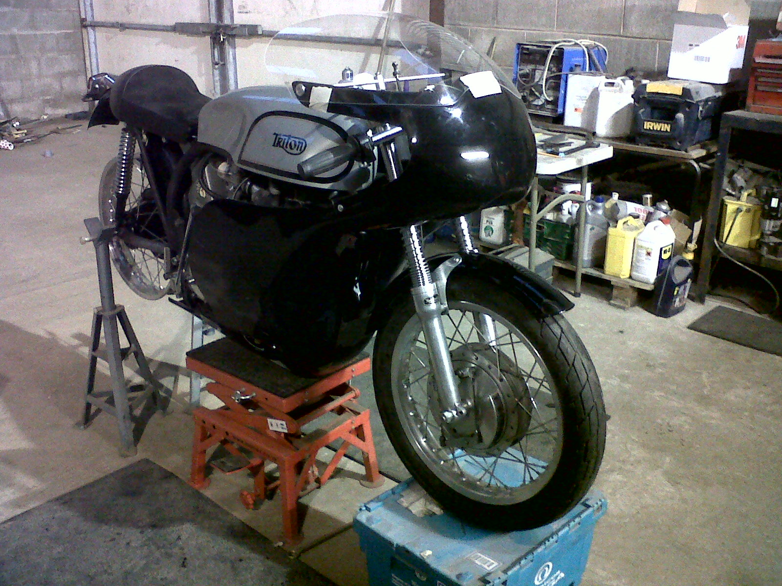

Dropped my old front forks in (these rims and front brake are now changed) , plus rear wheel to sort the fairing brackets out. Easier said than done
