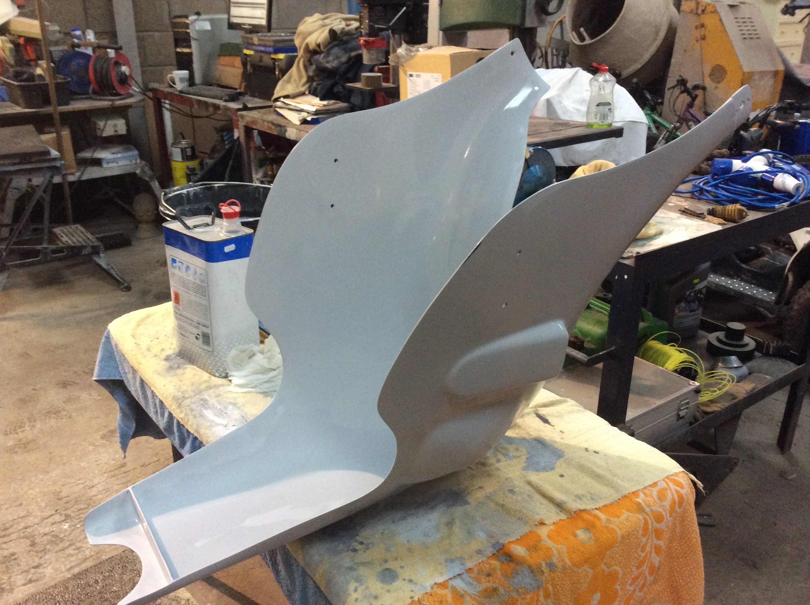

Took forever blocking that resin down, but it's an even thickness all around - actually no thicker than it was before and it's come out very nice indeed. No way I would ever do this again, due to my patience being tested to its limit, but it's really transformed the finish on the inside.
Shot three coats of 2k high build primer on it yesterday and blocked it back again today after dusting a little Matt black to highlight any flatting marks or pin holes. I used 600 grit paper (wet) on a hand block and this really helped shape it without any grooves from fingers.
I should be painting it with base and clear coat this weekend then I can apply decals and number backgrounds before applying additional lacquer on top.

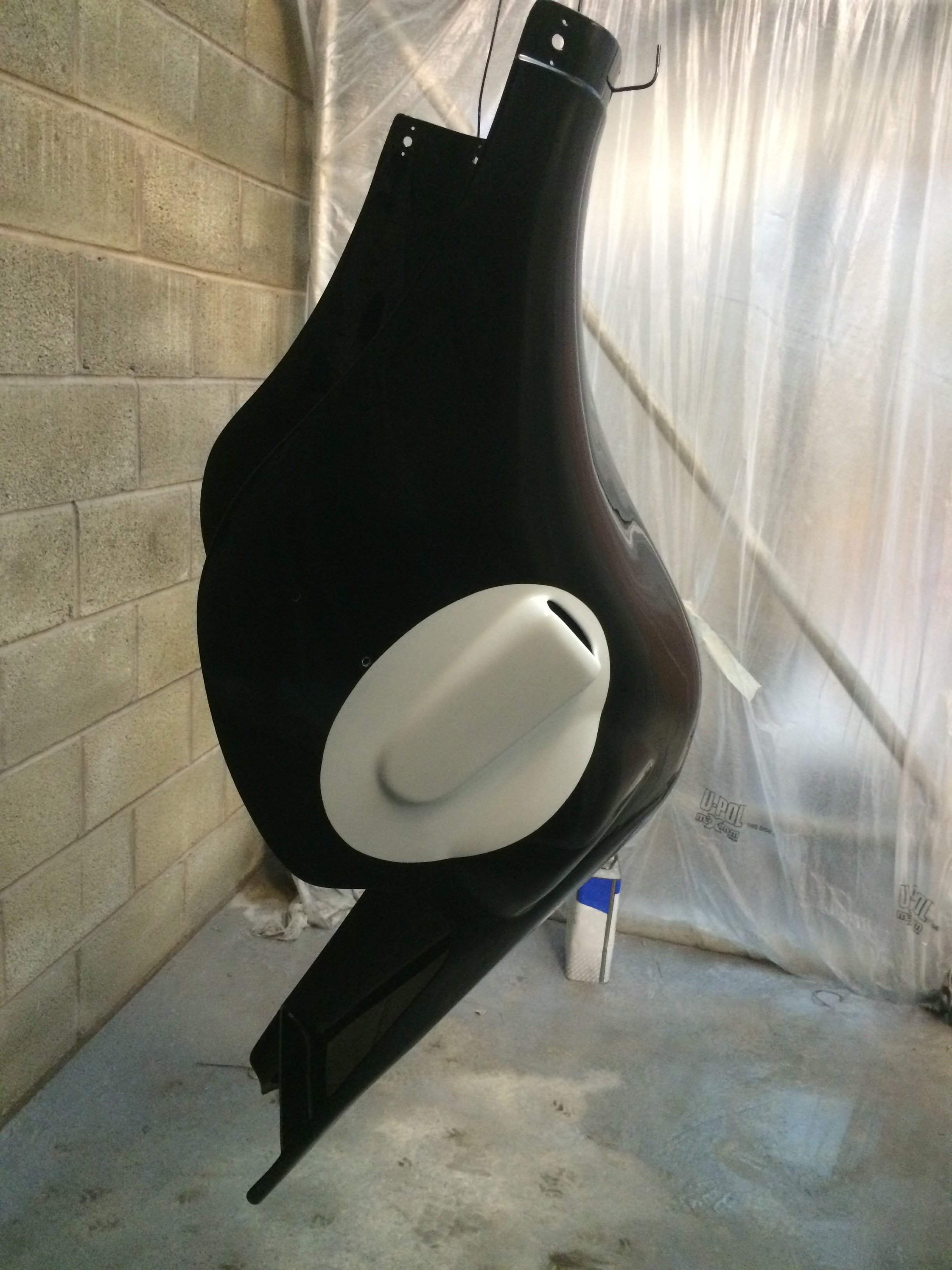

I made a polythene 'booth' a few months ago to paint my tank and it's still intact, so I hung the parts up in there and hosed the walls and floor off.
The basecoat I used is a really dark black if that makes sense. I used an accelerator in the activator for the clear as its only around 13 degrees today, but this also meant I could overthin it and lay it on really wet.
Four hours later and it's just about touch dry and almost zero shit in the paint. I'll leave it to fully cure before I block it down and polish it.

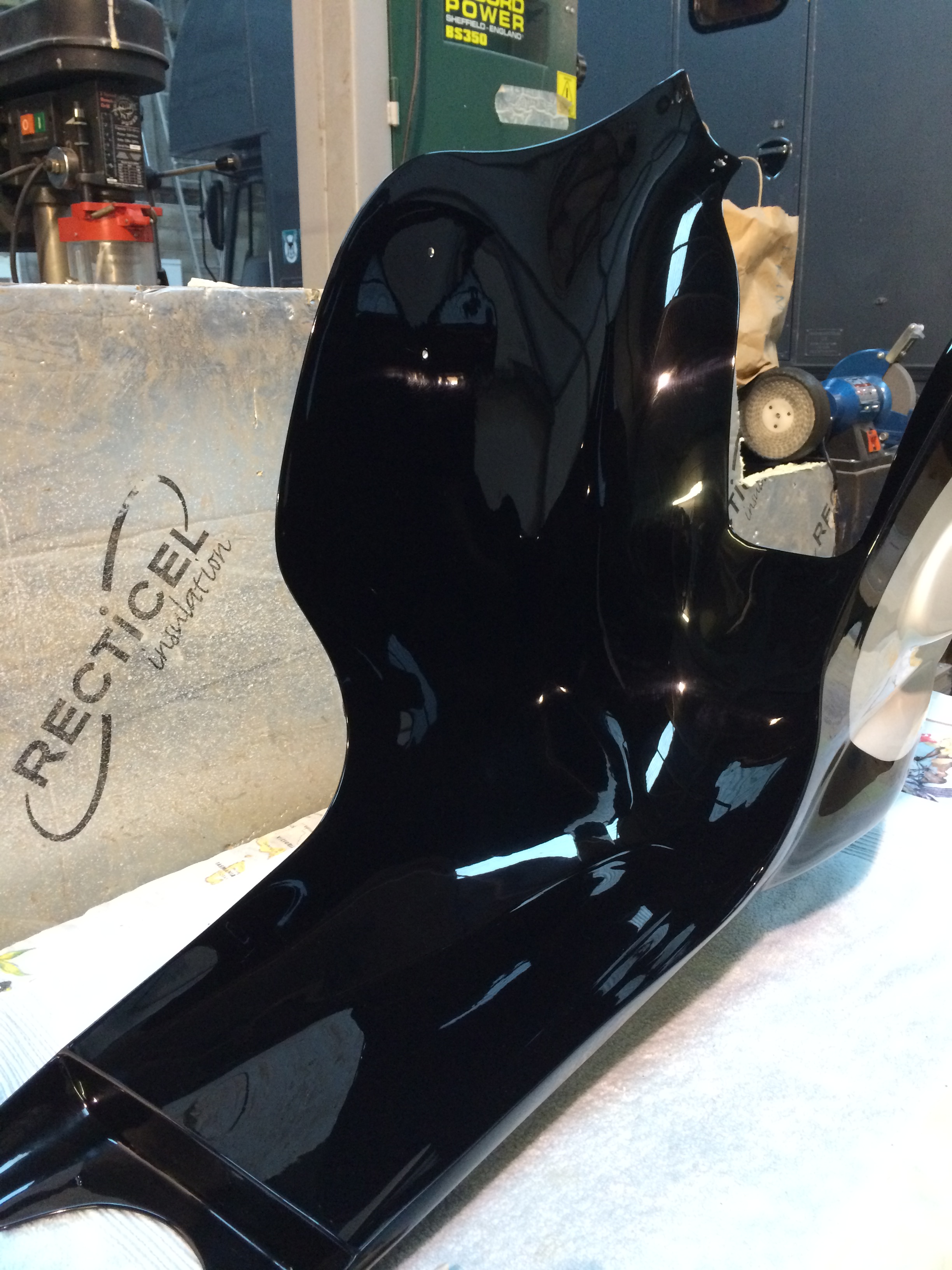

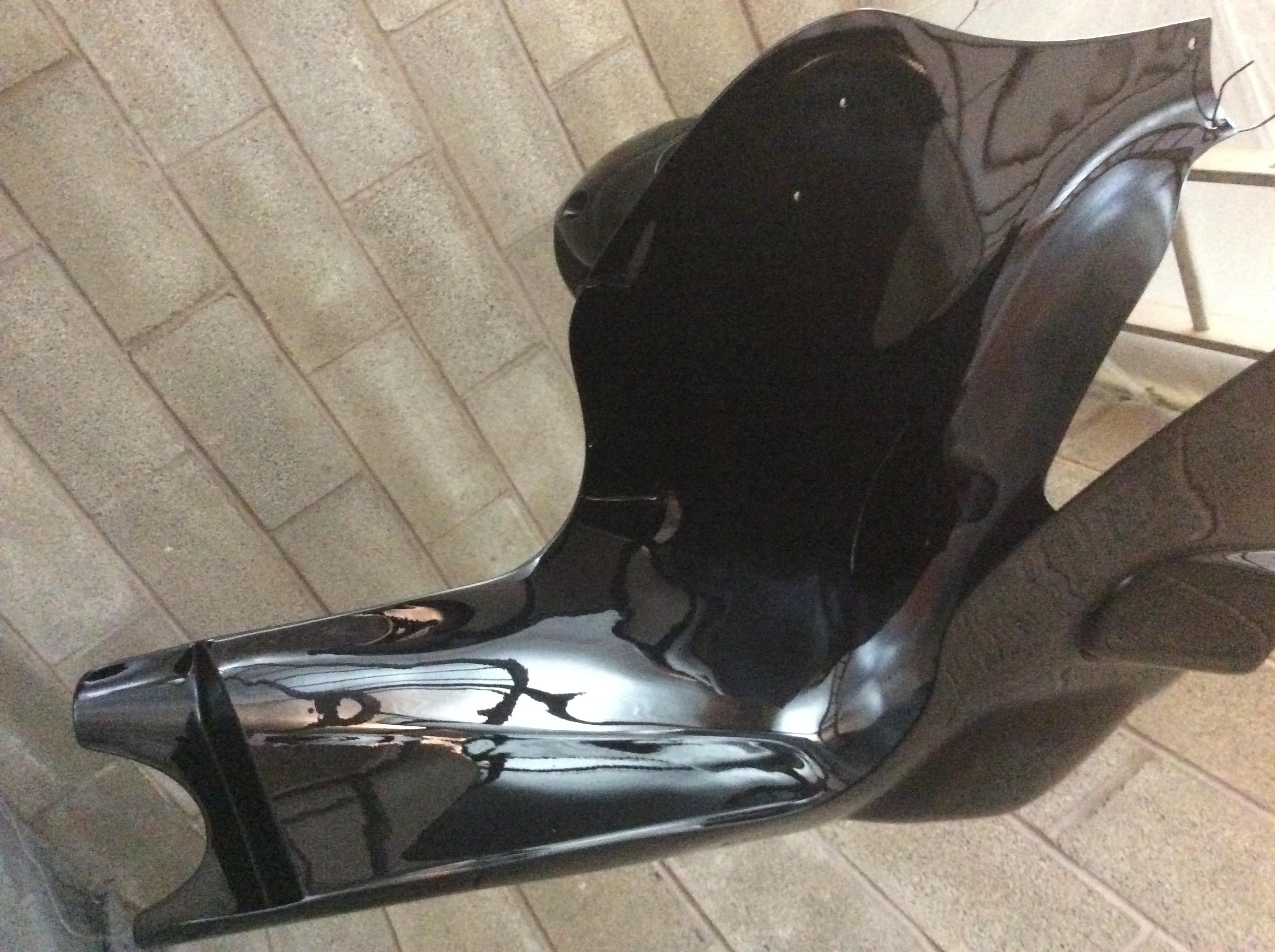

Here's the inside of the upper fairing from this morning. Once it's fully cured I'll scotch it down and mask up for white number backgrounds which I'll paint in basecoat followed by another couple of coats of lacquer.
Bottom picture is what it looked like before.

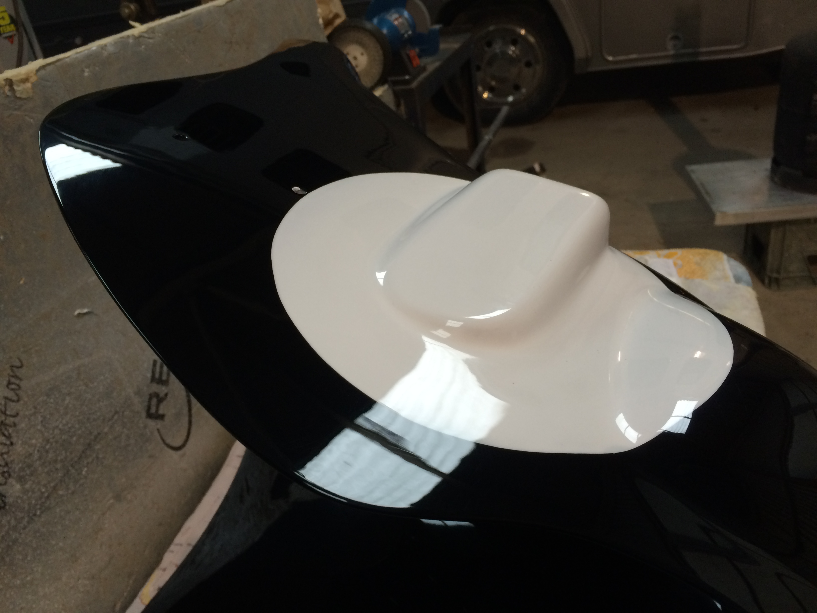

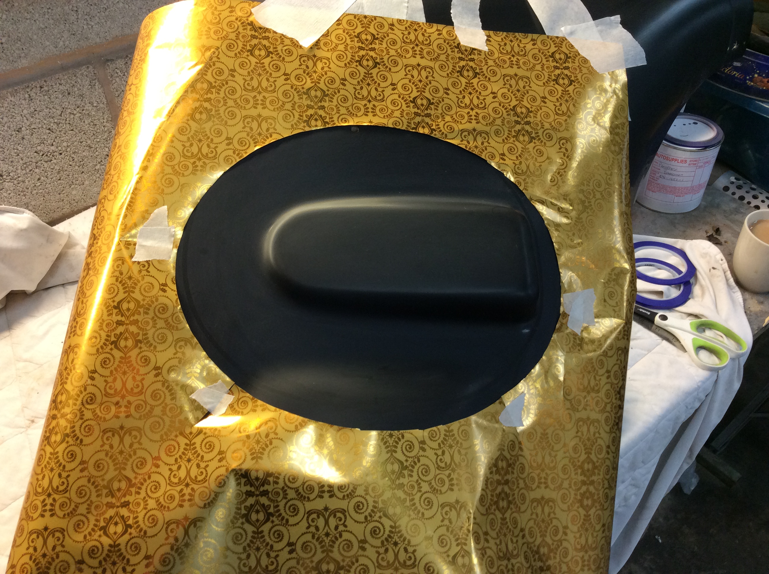

As glossy as that fairing looked, I blocked it down with 1200 wet and dry (only use it wet) and grey scotched it so I can paint white number backgrounds.
Minimum sizes for these on the sides is 260mm wide by 220mm height. There's a really easy way to mark an oval shape out and to save me trying to explain, take a look at this cheesy link. https://m.youtube.com/watch?v=hp7AxUVX714
Drawing it out slightly oversize to allow for the width of fine line tape then gives a good template to help mark it out on the fairing. Once I have it positioned where I need it, I fold the paper over on the rear edges of the fairing and the crease helps as a reference point when lining up the other side. I didn't have any large paper, other than this gift wrap stuff, which also has grids on the back, but this helps to make sure you get it level. The right hand side of my fairing would make it really awkward to stick vinyl on, and this will just look so much nicer.
I'll try to learn how to insert pictures in between text, but the quickest way of masking a fairing up for this is use a plastic bin liner and cut out the area you need to paint. You get no paint where it shouldn't be then. I dropped on 3 coats of solvent basecoat and after it dried, which Doesn't take very long, gave it a light sand with 1500 grit wet paper to lose any edge.
I'll take a few more pictures tomorrow, but I'll be lacquering the whole thing again and you won't be able to feel any edge or step in paint from the number background. I took pictures on my iPad, which I hate, so if they're upside down, I'll fix them on my laptop!

Hung it up again and dropped some more 2k lacquer on. Other than a flat and polish, this is finally done.

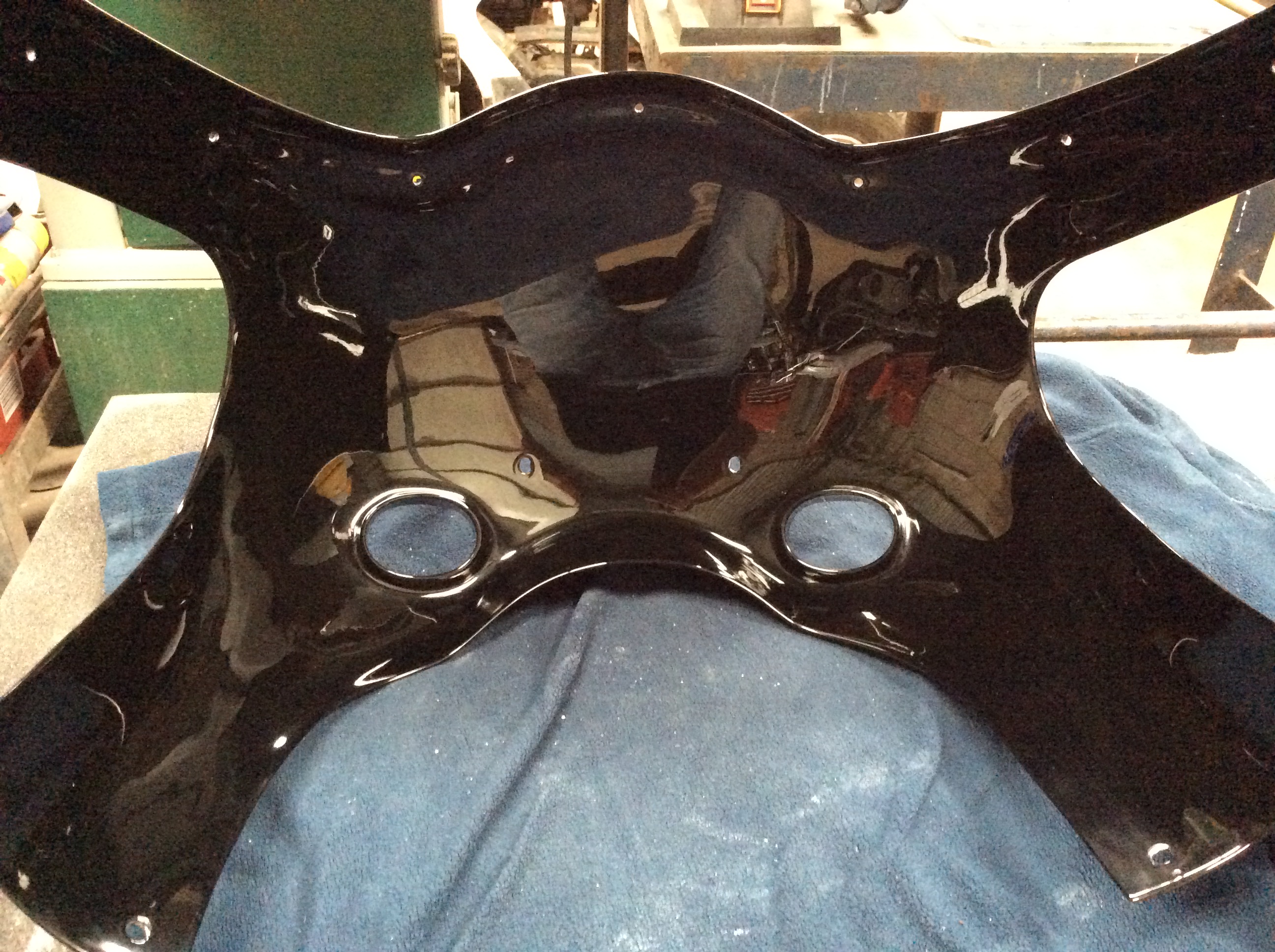

paintwork stuff is now completely finished after I de-nibbed and blocked down with 1500 wet paper. Managed to get most of it with a machine polisher, which makes life easier but all the nooks and crannies needed buffing by hand.
Any swirls or compound marks disappeared after hand glazing and it's now had a good buff with resin wax. Was really cold in the barn today and I had to light my little stove, but it's taken probably a day and half to detail polish good enough for them to be 'finished'.
I've wrapped all these parts up and put them away safe and it's nice knowing they are done and all ready for bolting on in a few months.
