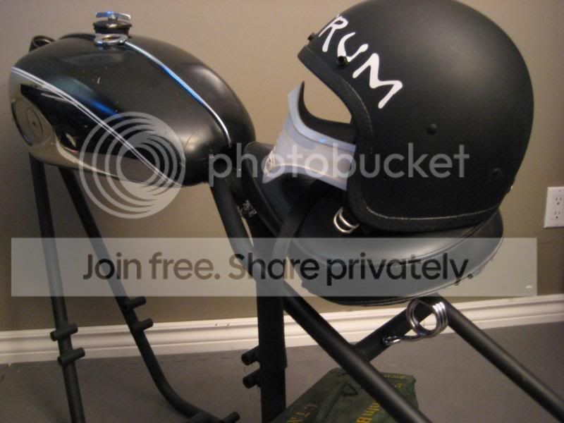

BUT.. Ive decided to use the BSA tank on his build...
Threw the tank on the frame to see what it looks like.. voila:
I definately like this set up better than the Sportster tank that I was going to use originally:
Everything for this build is all ready to go.. all the parts collected, donor bike is ready to taken apart...
I just need to finish up the Triumph then tear into this baby...
Once started, this will be a 3 day build... hopefully.. ;D

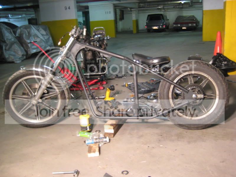

The plan for Day 1 – Transfer all the main parts from the donor bike and
- Get front end off the donor XS and put on to the hard tail – install new tapered steering bearings & upper/lower races
- Get back end off the donor then on to the hard tail – Make it into a rolling chassis
- Handle bars on to the hard tail along with controls
- remove and put motor into the hard tail
- Mount the kick stand tabs
- Mount the brackets for the electrical box – made from an old oil can
- Mount the seat
Starting point:
Tear Down:
We had issues mounting the lower steering races and needed the proper race press… So while waiting for the press to arrive I worked on the mounting the back end
- Thanks to Vinnie for lending us his press for this build.
Finally got the front end all together:

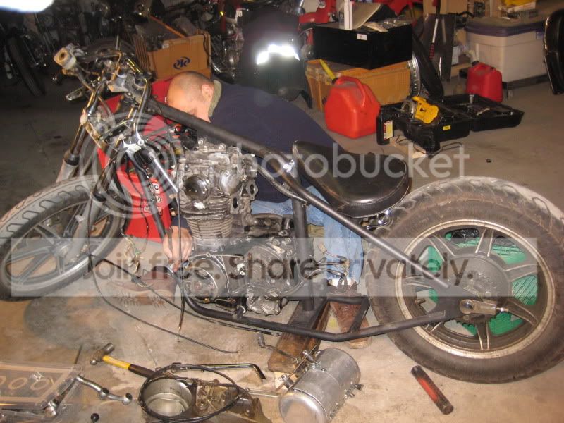

Now to pull the motor from the donor:
Prep for the transplant:
Finalizing the lockdown:

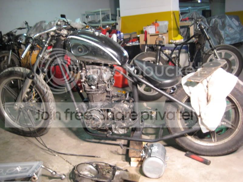

By this point the game plan is to:
- mount the side stand tab and side stand
- mount the electrical box bracket
- mount the seat hardware
- mock up the BSA tank
- figure out custom exhaust
Starting point at 6:30pm
Paul cutting bracket for side stand:
Side stand mounted after an hour of measuring, trial mounting etc..etc..
Making the bracket to hold the electrical box:
Electrical Box in place:
Paul welding the seating bracketry:
End of Day 1:
