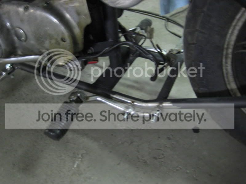

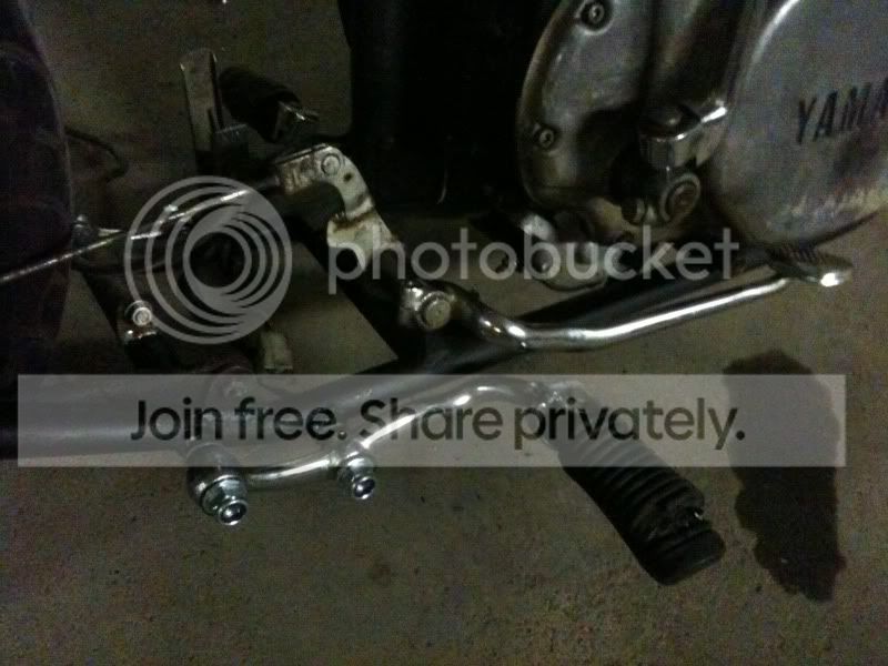

So.. A bit of work done on the bike today:
1. welded screws to the frame for the foot pegs
2. adjusted the brake pedal pivot shaft for the rear brake
3. welded vintage foot pedal to the kickstarter
4. mocked up tank for the tank mount

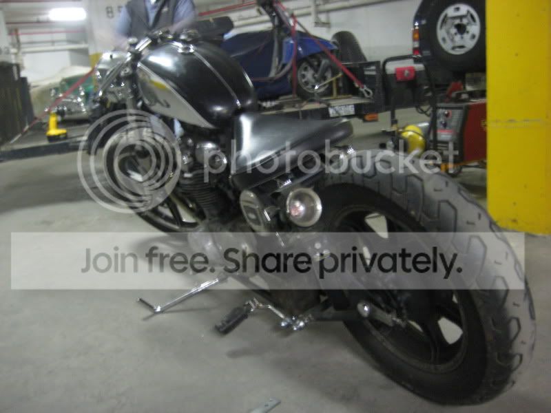

more progress on the bike today....
- Welded tabs for tha battery box
- Welded tabs for the rear brake stay and put together the rear brake assembly
- Welded steering stops
- Cut the mufflers of the exhaust
- Reinforced the side stand mount
Now the exhaust... We cut the headder pipes off and trying to decide how to postion them...
Option 1, have the headers turned off to the right and dump just in front of the engine:
Option 2, have the headders pointed inwards and dump just infront and below the motor:
What do you guys think?

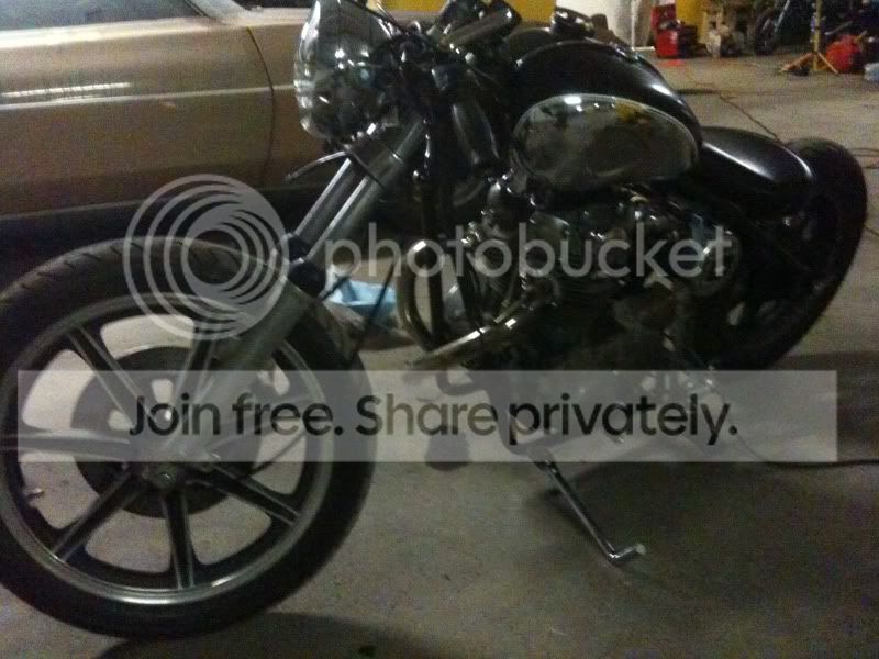

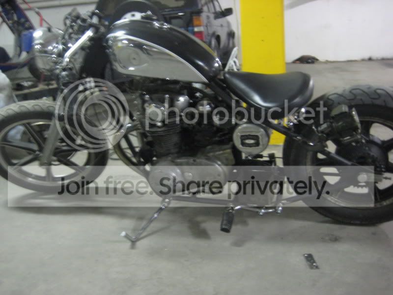

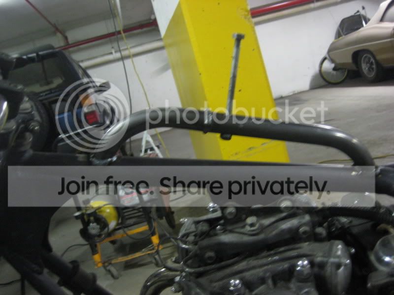

More progress today on the build...
1. Welded the BSA tank mount/support. The problem is that the BSA tank sat flat on the engine mount and therefore an additional "spine" had to be made to hold up the tank:
2. Welded a mount to hold the rear tail/brake light:
3. Vintage carbide lamp mounted:
Tank now mounted to the bike:
Mirror:
Tucked away for the night...

i like it all! love the new tank rails man... but i have to say i am not sure if that is the right seat, toooooo bulky for the cut and clean lines. personally i would gut the pan and add a small piece of carpet insulation and re wrap it. get that sucker thin and clean. bottom line is the bike is not being build for comfort. what you going to do wiht the rear fender? looking good man
Actually yeah.. I've been having the same thoughts about the seat.. I might just do that... regarding the rear fender, Im just gonna keep it fenderless!!.. ;D
