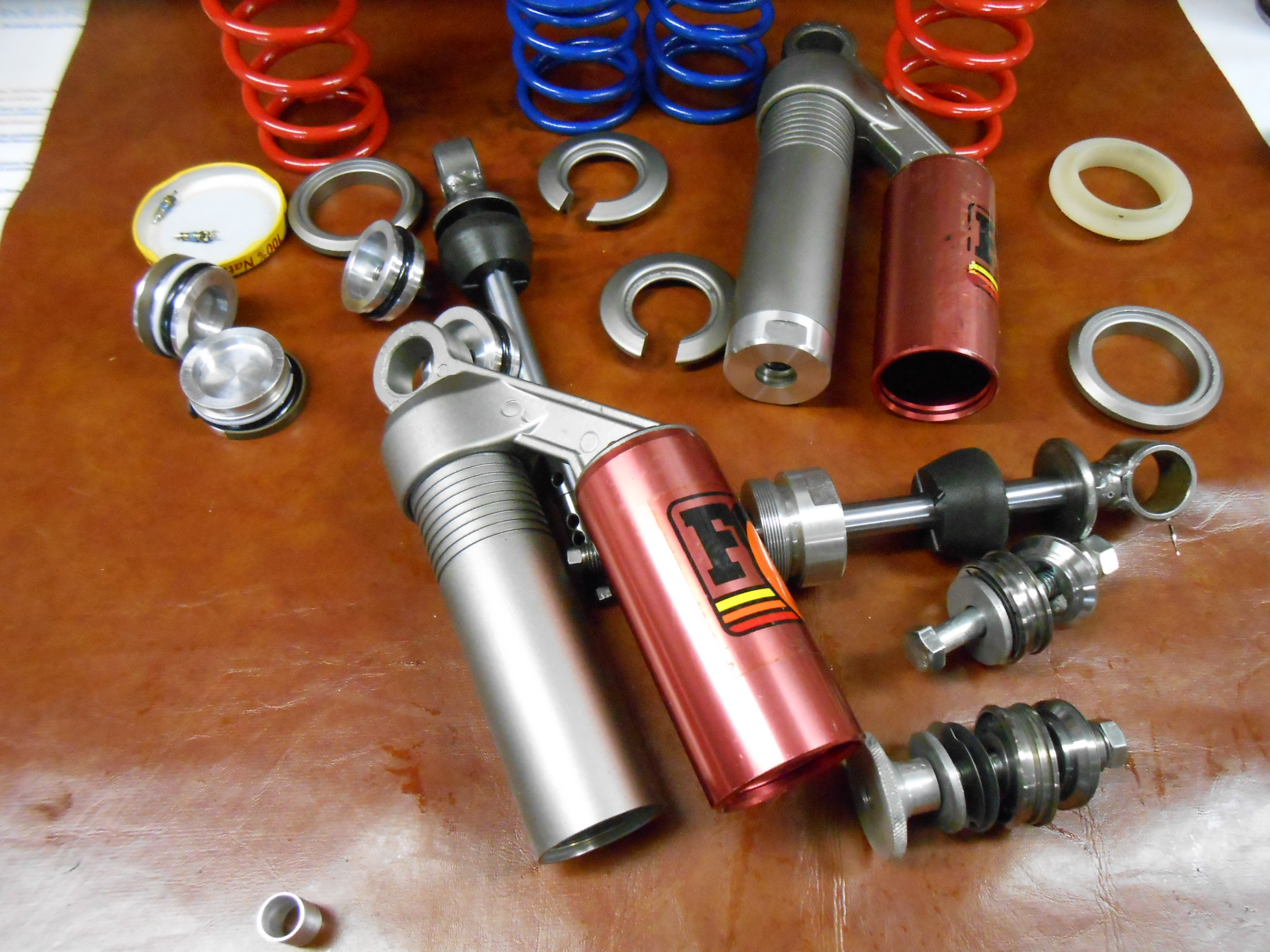

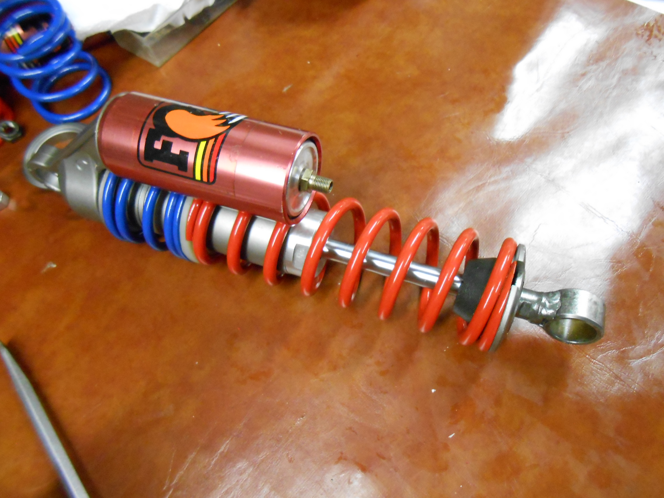

hope you don't mind a few pics finally got mine done :)
they are 13" ers
total repaint,all new seals/orings, new bumpers,the guts were in excellent shape otherwise

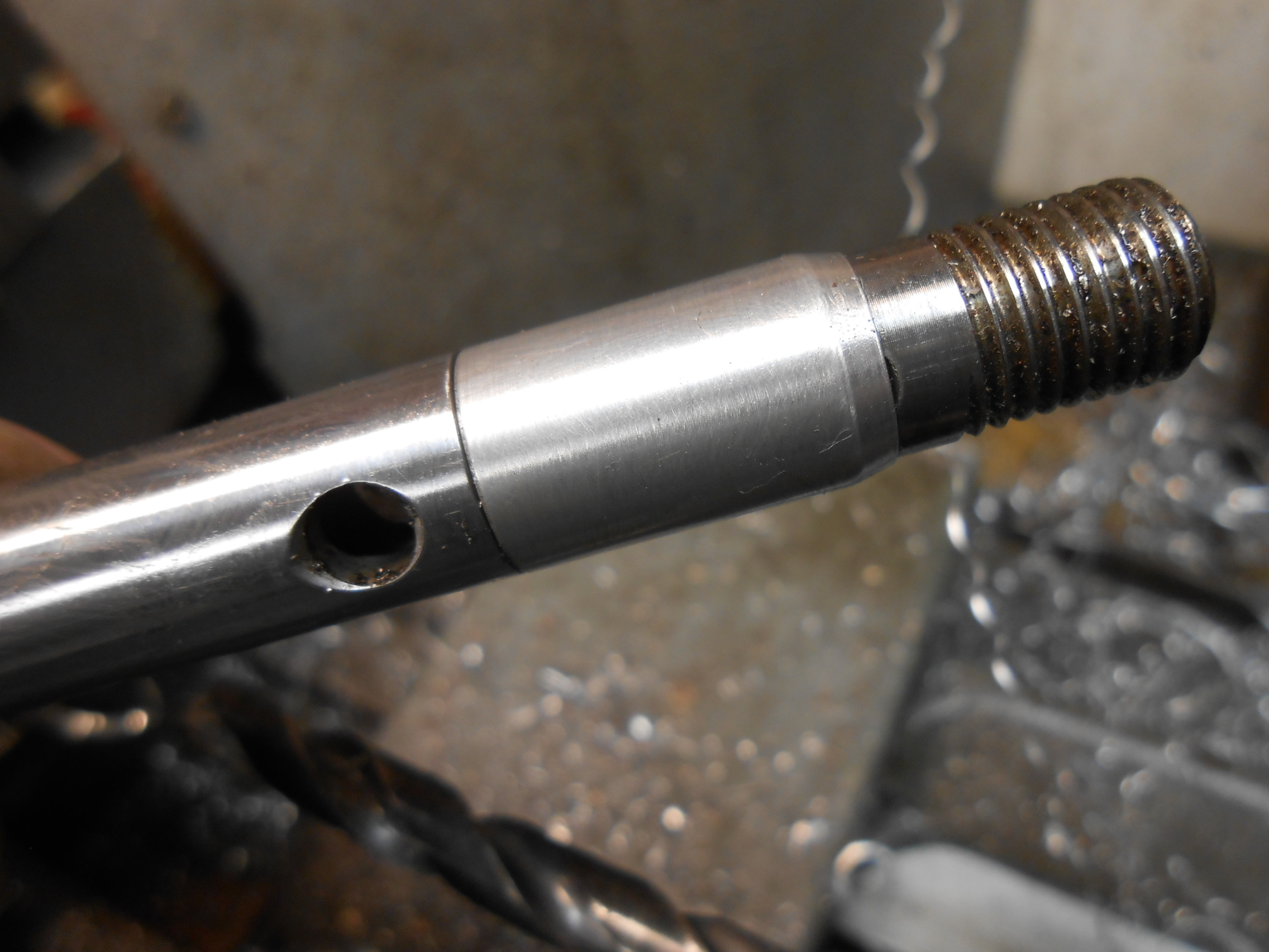

these had knackered shafts.i picked up another pair on the cheap,remote res not piggies,and shafts were identical :) (now i need to make a pair of shafts for the remotes)
i took a fine skim cut off the seal gland od and face to pretty them up
the springs and bodies gor media al-oxide blasted,then rattle-can paint,ford red engine paint and deep blue
the silver gray is stainless steel color i like it
made a seal bullet shaft cover dealy bob to ease pushing seal head over shaft
i am very happy they look the business

Nice, thanks for the pictures! That "bullet" tool you made looks very very handy for that job, and makes me wish I had my own lathe.
I'm gonna place an order shortly for a shaft and all the seals, high pressure valve cores, and probably sealhead bearings and maybe piston rings. Definitely want the stainless steel/teflon lined spherical eye bearings to match the eye bearings in my GS1100E swing arm (clevis on the bottom of the shock). Still not sure on the springs though, as I think these will be slightly softer than OEM initially but slightly stiffer than OEM at 3" of travel (OEM Suzuki shocks have a lot of THICK-wired coils). Going to hit up Thor again for more detailed info on what used springs he has, and have been shopping for some springs on ebay in the 10-1/4" length range to just get one spring that has the rate I want. I'd rather keep the original Fox look however if I can get something from Thor.
