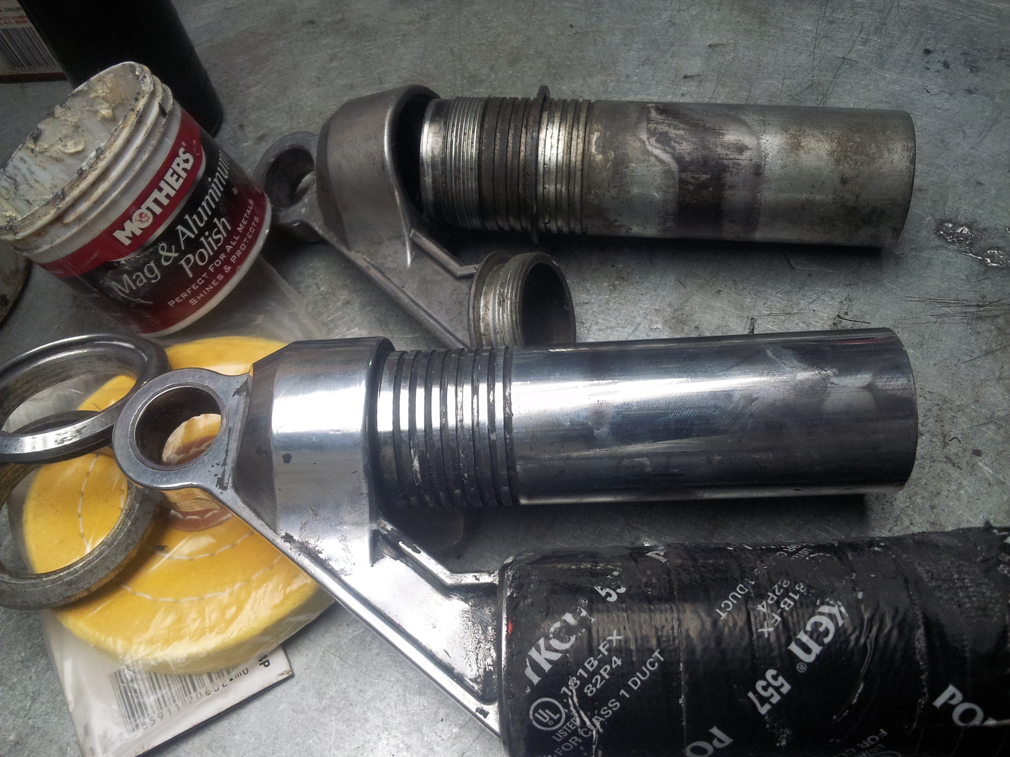

I decided to repaint the springs in a fitting color scheme for my bike/tastes, since I am NOT refurbishing the shocks for resale, but rather to have a nice vintage & fitting shock around my price range (well, that's turning into quite a stretch!) that performs as good as many modern shocks in the $600 to $1000 price range that I definitely cannot afford! the only major advantage to the newer shocks is that they have adjustable dampening and are easier to adjust preload. I will take the cost savings and nostalgic bonus in refurbishing these vintage shocks and putting my own blood sweat tears and elbow grease into them, as opposed to shelling out as much money as the purchase price of my bike in stock form!
after soaking the springs in a tub of paint stripper and then spending some time on the wire brush wheel with them, they turned out looking like a very nice polished steel luster, & I was tempted to clear coat them. Unfortunately I've had problems with rattle can clear coats turning yellowish with ultraviolet light exposure, and I cannot find any durable clearcoat other than paying the powder coaters to clear them. My friend reminded me that clear powder coated bicycle frames typically display spiderweb marks of rust developing underneath the finish over time, and that was enough to deter me.
as I could not find any por 15 chassis coat black locally, my next best and most affordable option was VHT epoxy paint which only comes in semi gloss black, but it's perfectly fine for my color taste! this paint takes 7 days to cure, so I will not get to ride the shocks in West Virginia this weekend, and it looks like rain anyway for Friday's drive down there, so it may be a mountain bike camping trip instead.
also, as you can see in the photo, the shocks surprisingly polished up very quickly to a mirror finish on the aluminum parts, and the steel main cylinder apparently was zinc plated or something, which also polishes up to almost chrome. I was tempted to use the same black epoxy paint for the main cylinder where the spring bushing rubbed the plating off, consequently leaving a rusted marks and no plating. Unfortunately I think that paint may just rub off again, and black may show the wear much faster, although it the black paint is much tougher epoxy paint and it is a Teflon or nylon bushing that separates the two springs. I am undecided on this, as I cannot get silver paint an epoxy form, only in brake caliper paint or lessers. I am wondering if the black will look good and break up the space a little bit, or if it will look odd painting the main cylinder below the spring perch and clip grooves, leaving the top half with the original finish buffed to a high polish. I knew putting on the clips would scratch the black paint off immediately, so I decided that I would only paint below that, whether it is silver or black.if the original finish was not worn down completely to expose the bare metal and let it rust, I would have just buffed the entire thing & been very happy.
what does everyone think, durable epoxy paint in black below the spring perch on the main cylinder, and polished aluminum sealhead at the bottom of it, or just paint the thing silver and let it blend in, but looking very dull compared to the rest of it being polished plating and aluminum (aside from the black springs).

After looking at Carpy's supercharged cb750 "koppa kafe" with chromed springs, polished aluminum, and re-anodized orange reservoirs, even with black springs instead of chrome, I think I may try for the more durable epoxy paint to break up the color monotony a little more and accent the bodies with more black. Hope it ends up looking alright.
Re: Vintage Fox Factory Superbike Shox
ON SECOND THOUGHT... Holy smokes, after sanding the rust discolored areas off where the plating was worn completely through, this factory finish AND the bare sanded steel polished up almost like chrome! Wow. I think I may have to clearcoat this area to prevent the bare metal areas from rusting, as I can always go back and epoxy it black with some quick sanding if the clear wears off and starts rusting again. I was hoping for more black to break up the shiny polished aluminum scheme, but the results here were just too much to cover up. You can tell the bare metal areas apart, but they blend in quite well enough.
I am incredibly excited about these. This rebuild I will call 36th birthday gift to myself. Hopefully get to ride them for the first time on a 4 hour cruise through 2.5 hours of twisties and hills and 1/2 & 1 hours flat rural riding before and after on the way to the Williams Vintage Cycles vintage bike show in Xenia, Ohio May 24th, arriving around 1230 or 1pm (show goes until 3pm). That will be quite the reward.

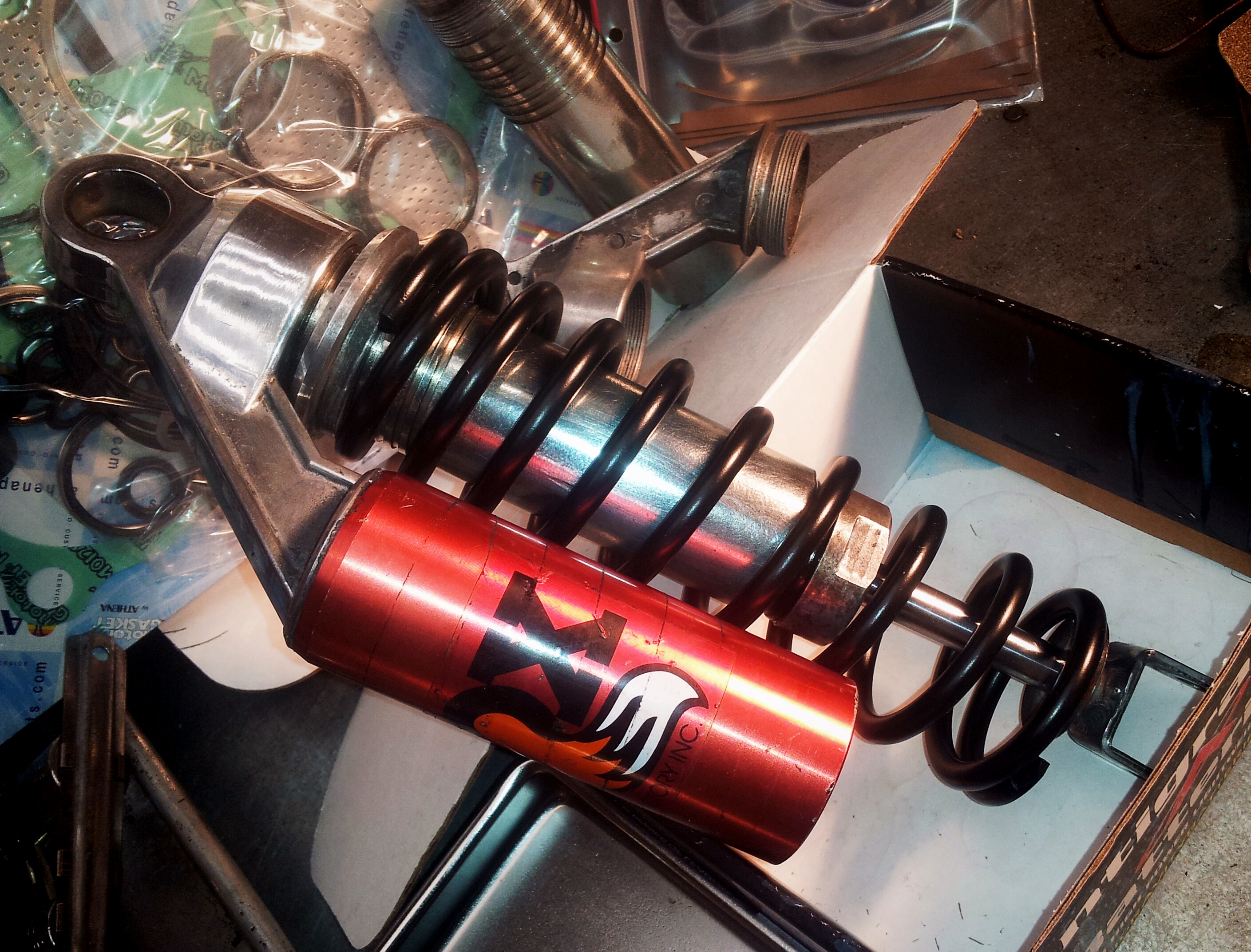

I clear epoxy painted (firearms finish from Brownell's) the main cylinders after polishing and degreasing them A LOT, and had to mock them up to see how the colors will look when assembled. I am VERY VERY PLEASED to say the least. Now if I could only get those darn parts from Evolution (Thor)... Doh!
