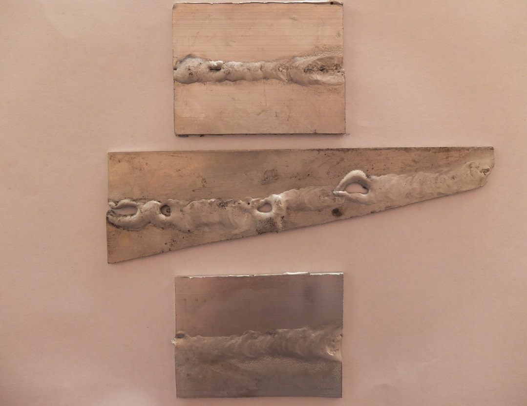

Finally got some Aluminium flux - shit it is hard to weld Aluminium, without it slumping into a puddle.
Top and bottom are 2.8mm and the middle is 1.4mm thick.
Practice, practice and more practice needed.

Great start! You’ll find that different torch sizes and settings will help. Since the aluminum flows so easily a lot of guys, myself included, prefer a larger tip size but a small feather in the flame as opposed to a completely neutral flame.
Play with your torch settings and keep up the good work.

Do you brush your workpieces off with a s/s brush first? I notice a change in color/sheen when the material reaches welding temp, about when your filler starts to drop off and beads melt onto the base material is the time to back off of the heat.
If you rub some soap near area your welding, (ordinary cheap bar soap) it turns brown around 400f and black when weld area is 'about right'. (soap line about 1/2" from weld line)
You can also use the same 'trick' when annealing aluminium, great wen 'emergency' straightening brake levers, etc)

Same trick with soot - use a low acetylene flame (no oxygen) and hold your piece above it until it has a nice sooty covering. Heat it until all the soot disappears and you are roughly at annealing/welding temperature. Before welding give it a quick clean with the stainless steel wire brush. Has worked perfectly for me for years.
