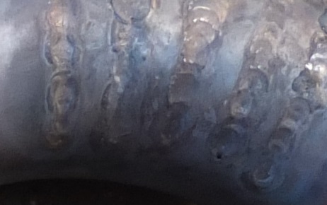

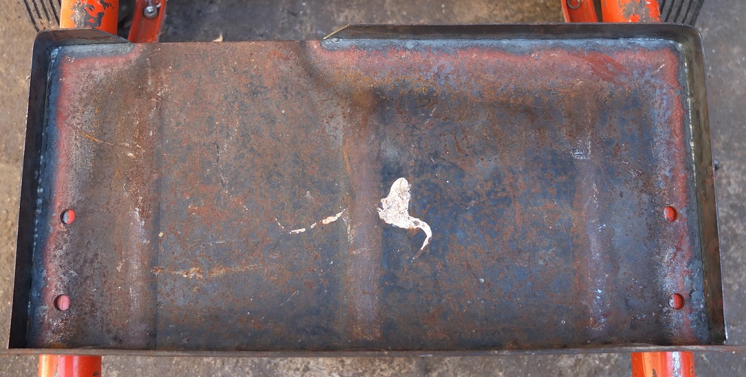

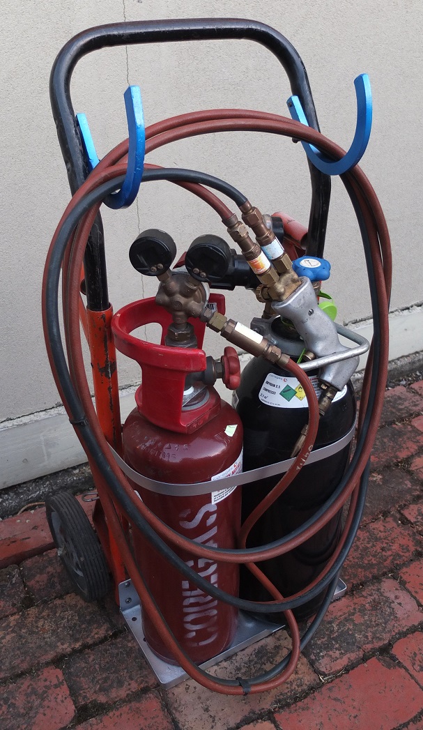

I made up a trolley today for the O/A setup. Welded a perimeter onto the base tray to help hold the bottles. The perimeter was 1mm and the tray 2mm mild steal. It welded easily with a very small heat affected zone and absolutely no distortion.
Youre not really supposed to weld stainless with acetylene, but its handy to know in a pinch!
Understand, but if you are limited to one system then O/A appears to be the best compromise. By the way the Dillion manual states no flux is required for stainless. In the attached photo, when the flame is correct (carburising), O/A is capable of good welds with stainless.
