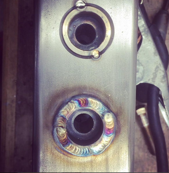

I have been using the Eastwood TIG 200 at home, Miller Syncrowave at work. the Syncrowave has a bunch of add-ons like arc pulse, and a cooling system. Its pretty big and heavy but a real workhorse for production fabrication downside it comes with a steep price tag. the Eastwood Tig its an entry level welder that does both AC and DC. its only $700 and has a three year warranty. My only gripe about it is the regulator it comes with was pretty chintzy so i had to replace that, and the foot pedal has a tendency to blink out when you are tapering off. I have had it for about 2 and a half years and it has been a fabulous welder for the money. This is some stainless I welded with the Eastwood welder.

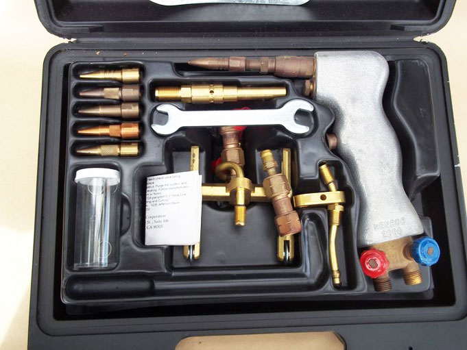

Has anyone used one of the Dillion/ Henrob/ Cobra oxy acetylene welding torches. A bloke gave me one a few years ago, as he said he could not get it to work! If you look at the videos on Youtube it can weld any type of metal very easily!!!! Has anyone tried it, or know if it is worth the effort? Supposed to be very capable (in the right hands) on welding thin panels like fuel tanks.
In the past we had to pay monthly rental on the gas bottles in Australia. The market has now changed and we can easily get non-rental gas bottles which makes the oxy/acetylene options more cost effective than a new tig.
Genuine gas welding is quite the step up form TIG, I had to do it in school a few times and I admit I can see the appeal, but I had a really hard time learning it. (But that probably also partly was down to the instructor, as in retrospect he obviously wasn't too skilled with the Oxy set himself...)
Thats a very weird looking gun that henrob. Doesnt look very wieldy to me but i dont see why you couldnt weld thin plate with it as well as any other setup.. i prefer an x11 handle with a small bendable copper nozzle for thin work. Just learned the oxy/acetylene setup these last years, excellent method for gas tanks.
Looks like I should invest some time and learn how to oxy weld. The Dillion runs on only 4psi for both the oxy and acetylene, just hope the regulators can be reliable at such low pressure.
Given my current lack of welding skill, I will be getting my mate to tig weld up the headers on the XS896.
It's similar to a jeweler's torch. I've used them a bunch when I was in school. They're quite capable. I see them pop up on eBay for a decent price under retail now and again, but I never get them before they're gone. They're absolutely worth a purchase, especially with the additional prospect of brazing.
