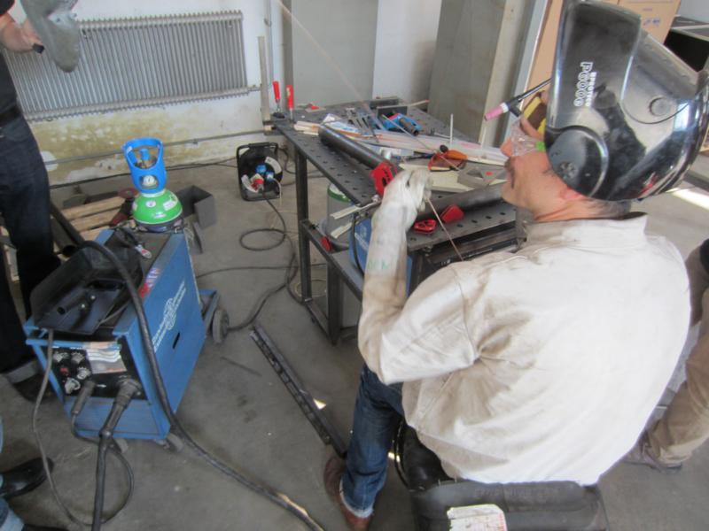

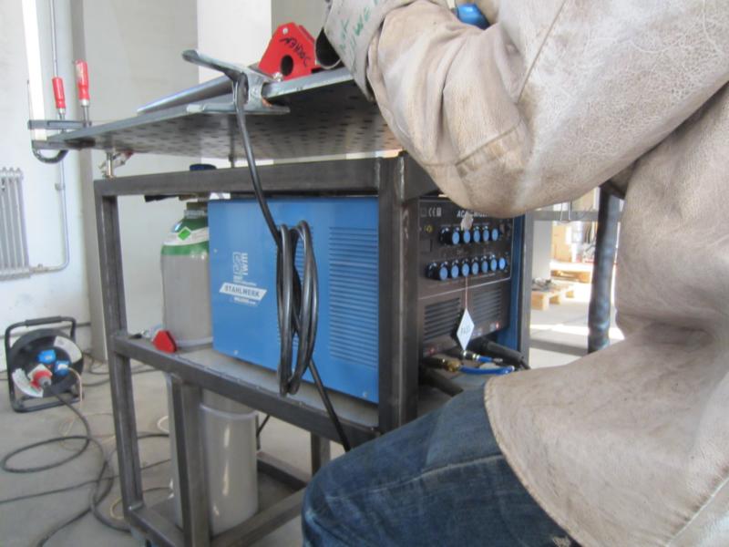

So guys I finally ordered my welder!
Its a 200amp tig welder!I also ordered wlding stick for ally, stainless and mild steel, can´t wait to set it up!
I also have an idea for a welding table,here´s a pic of the table the guy had that held the "welding lecture". 8)
Is there a certain grid these holes have on these welding tables or is this random?
I will get a thick steel plate waterjet cut and would like to have the grid and hole dimension to start to draw it in CAD :-)

In school we used to have one tapped in M8 in a 10x10cm (roughly 4"x4") pattern, so you could bolt stuff down.
I actually like his setup VERY MUCH. I may have to copy that down the road...
Jep its amazing isnt it?
I will start with a thick steel plate like he has on the top and will build that cart down the line too, when I can throw on good welds.
Really nice when you just need a power plug and can weld anywhere in the workshop...
