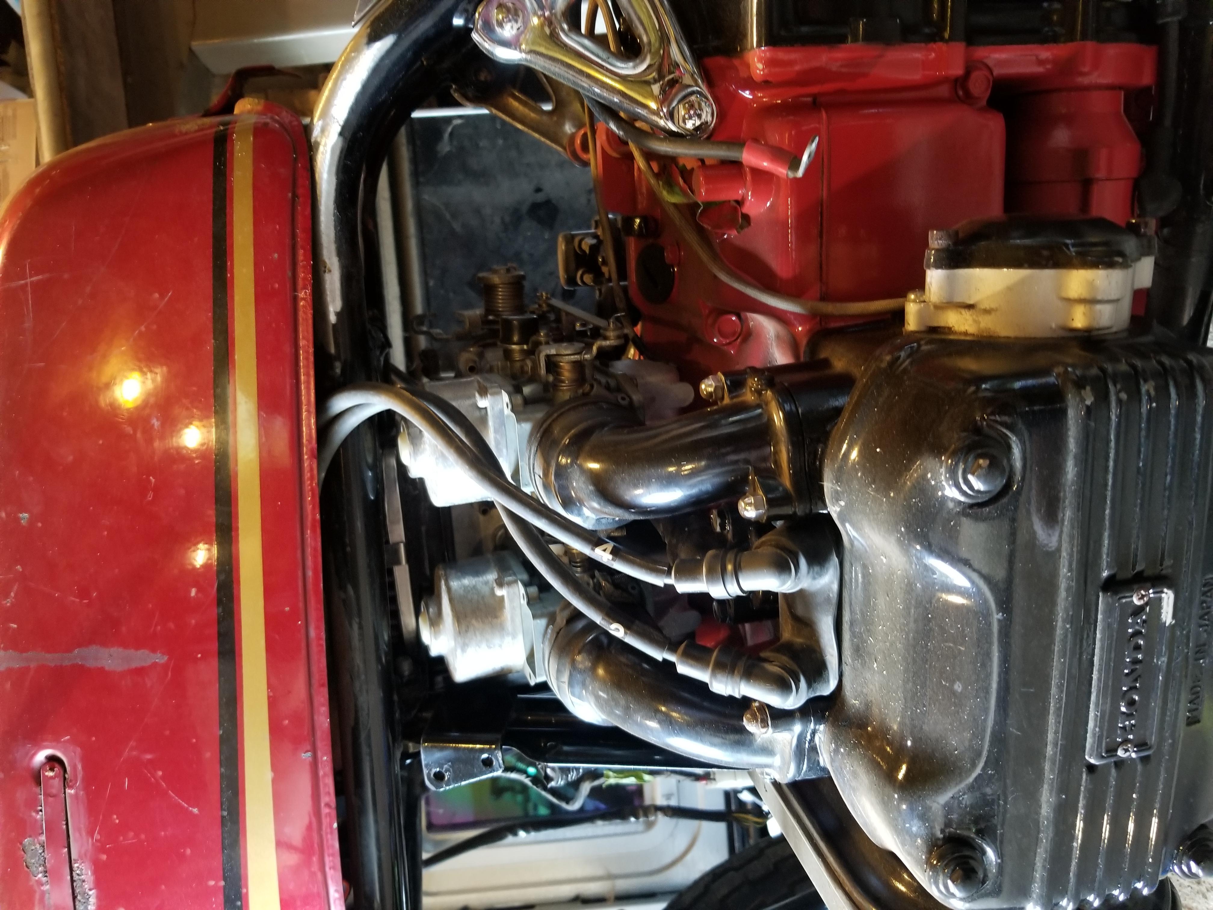

Has been a while for this one. Carb issues last year? Then it sat after I painted the motor. Finally pulled it out and cut some frame off. Kinda torn on which direction to go....hardtail or not? Am thinning and lowering the frame at the shocks, trying to make better looking triangle.
Once that's done I'm hoping to have dual Weber's for it, an air filter on stock carbs is gonna be weird under a normal tank.
Any ideas are much welcomed, you guys come up with radest stuff.

Hope you are keeping those intake ports covered. Single Solex (VW) carb, dual Webers, supercharger have all been done to varying degrees of success (supercharged 'wing by J.R. Lusik probably the best). Joe Drum on Classic Goldwings had a single Weber running great until he broke a belt. I just shipped him some valves because he is on very limited budget. For the rear, make sure some is bolt-on so you can remove the bits of drive train if needed. Seems the biggest problem on 'wing radicals is the tank and frame setup. With all of the frame parts on top, it gets real hard to work out a tank that look right, and then you have that huge hole where the old tank was. Might be interesting to see an entire re-design of all that. Oh, and change the belts.
Ports are plugged and taped! I've been reading randakk notes again about carburation....lots of things to think about! I havent been on the wing forums for a while now, forgot about "change the belts" lol

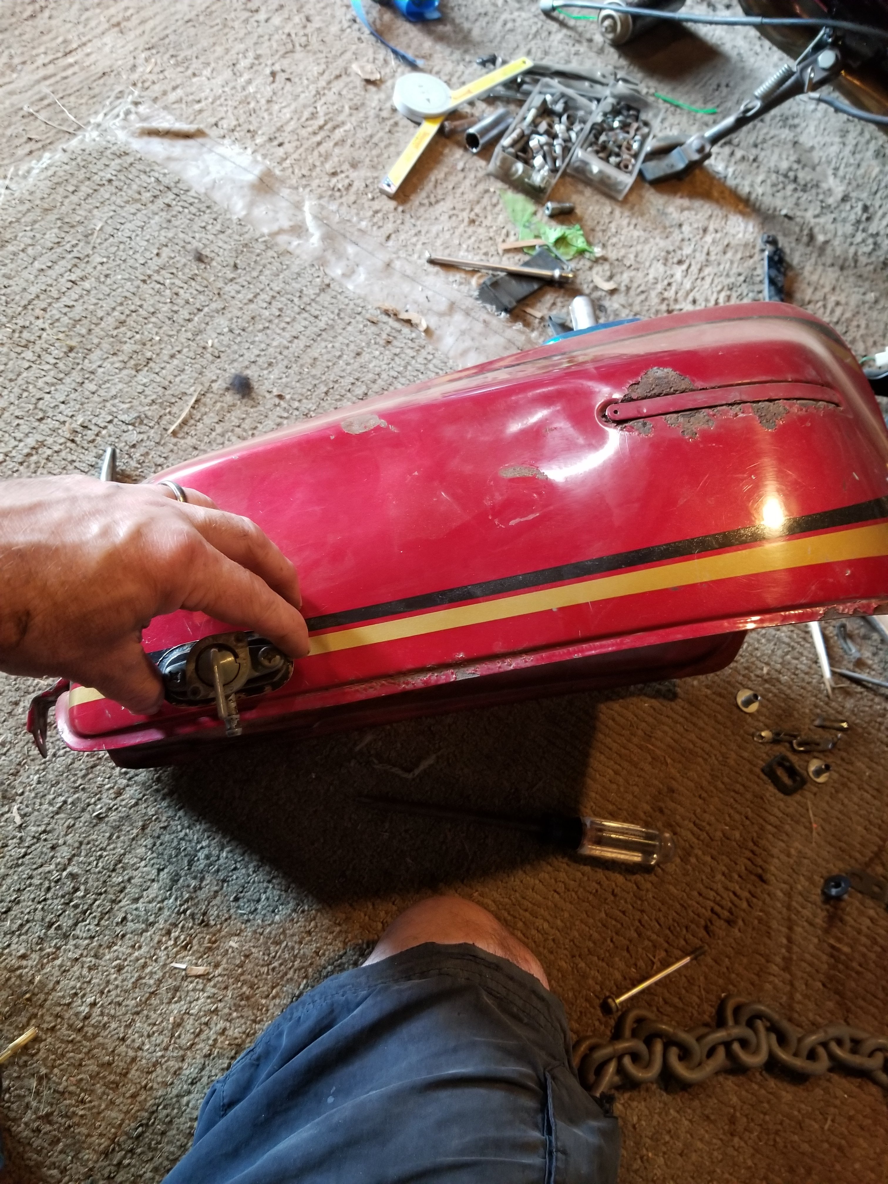

Frame is in the way of petcock....easy option is to just weld it on the side....while it is a rat bike thingy...is it to ghetto? Any cooler ideas from anyone?

My other idea is just to weld in a barb fitting underneath and hidden...inline valve...inline filter...prob look better.
weld the tap on there and you will end up with any water in the fuel never leaving the tank ( it'll sit below the level of the tap) and the tank WILL rust out, ask any previous owner of an early 80s XJ650 or 750 yamaha owner how they know this....
Note that the original tanks sucked fuel up hill to the petcock for about 1/2 tank. Just something to consider. Maybe loose weighted pickups like a 2 stroke weedeater/chainsaw/leaf blower? Electric pump could be used if you could find one with that low a pressure output. Tach can be picked up from ignition. So, a custom cover put over the right rear head after cutting the tach drive worm off the cam. Webbers might even handle (or prefer) a higher fuel pressure. Removing carbs from the top and moving them outboard leaves a huge hole over the engine - could be useful, or hard to fill and make it look right.

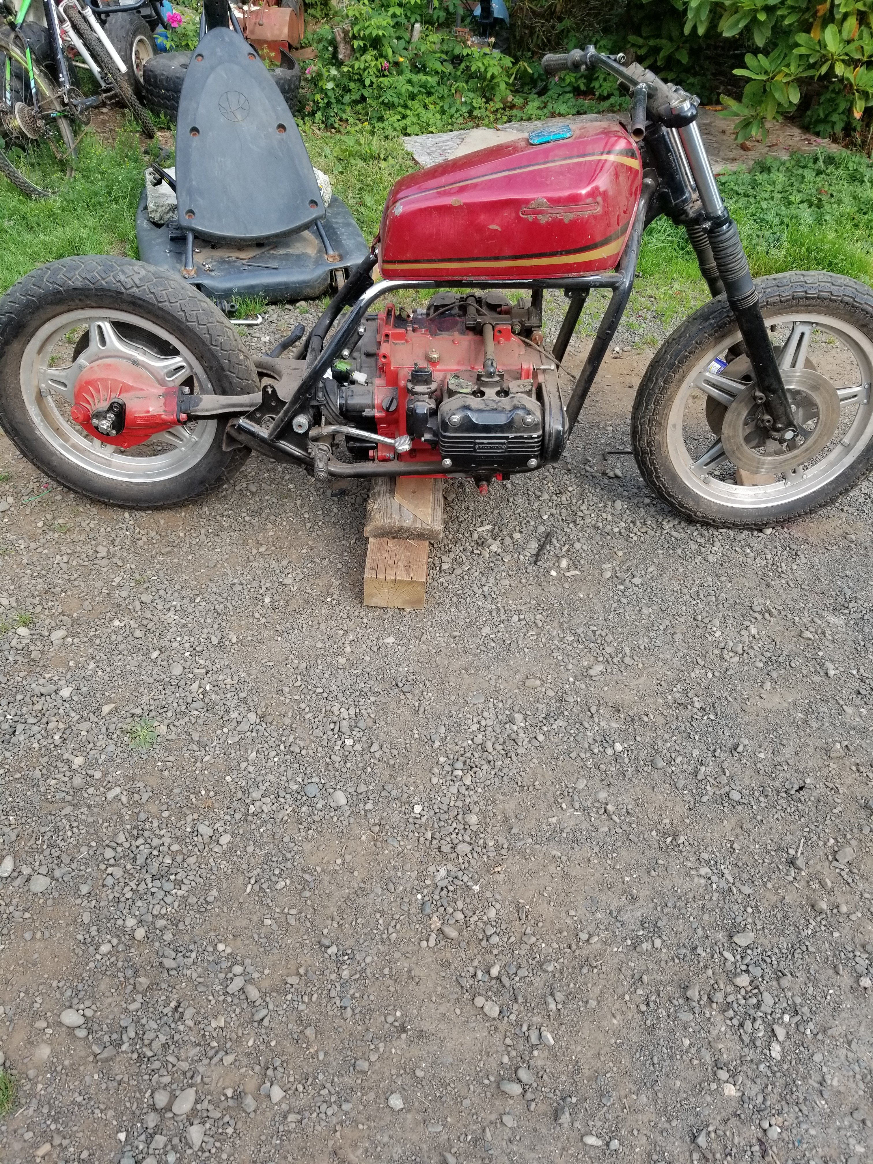

I cut some out and welded in a normal spine...was paranoid about cutting g the top sides though...probably should have.
I built a jig out of old bed frame angle and spot welded the head tube and the back of the bike to it. Similar to how hot rod guys hold a body while they chop the top. The backbone tube was 1 1/2" and had several healthy gussets that couldn't be seen with the seat and tanks in place.

Trying some bends....look o.k.? Need to figure out the tail area and rear fender.

Not exactly sure lol, the main reason for the change was to narrow it up a bit and get rid of the bulky intersection at the shock mount. I dont mind the open look....but I will be housing the fuse box and battery in that general area...not sure if I'll get a much smaller battery, I like power. This is also something I want to throw very little money at....maybe upgrade parts slowly after it's all assembled....
