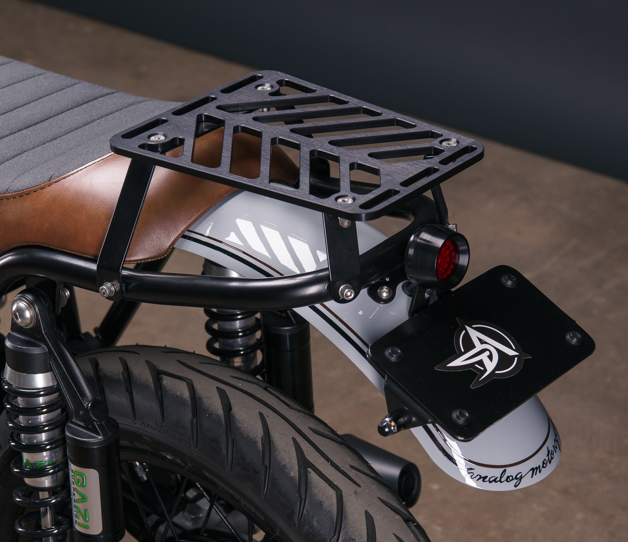

Why not make an integrated luggage bracket out of the upswept piece, and then make the seat a bit smaller, something like this but then flat on the frame.
just an idea.
I forgot about a rack...I had thought about that before...not sure why I bailed on it....time to rethink things.
I was trying to think of a way to make a quick release rack for mine. I don't want it all the time but I do want one sometimes. My buddy has a slick as shit one on his Chieftan Darkhorse and it is great. Throw it on when touring, take it off when not.
