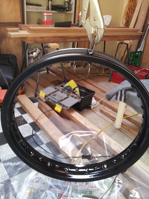

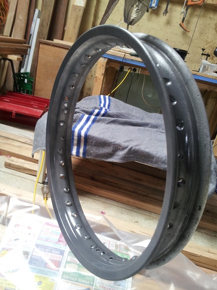

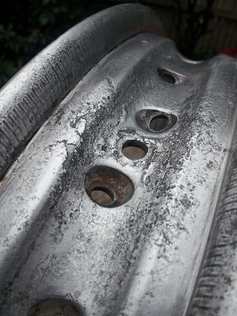

the rear rim was salvageable..just. the worst corrision was under rim lock ..the rest was just surface which ground off with 3m wheel.. etched primed and rattle enamel black

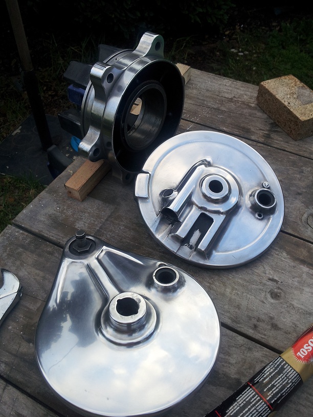

while waiting for buchanan spokes polished some pieces..

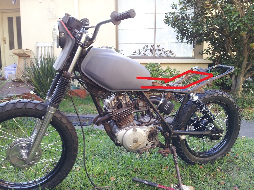

dropped 2" thru triple clamps.. may raise with the 19 rim? have to see

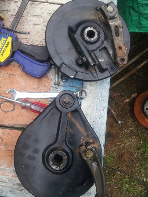

The removable plate on the front hub, juggling 18 spokes one handed.. sheesh its really a patient builder. It aligns 4 different ways to the rim- i know that now!!
The rear is pretty true but front dropped off to get trued - ive spent enough time on it

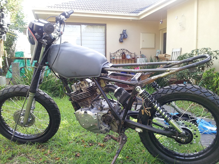

cut & fitted 45° silicon intake and ramair filter.. rear back on..semi polished front forks
cant wait to alter subframe..raise and flatten, contemplating getting a MIG..or leave it to the experts. im leaning towards latter for a quicker, better finish!

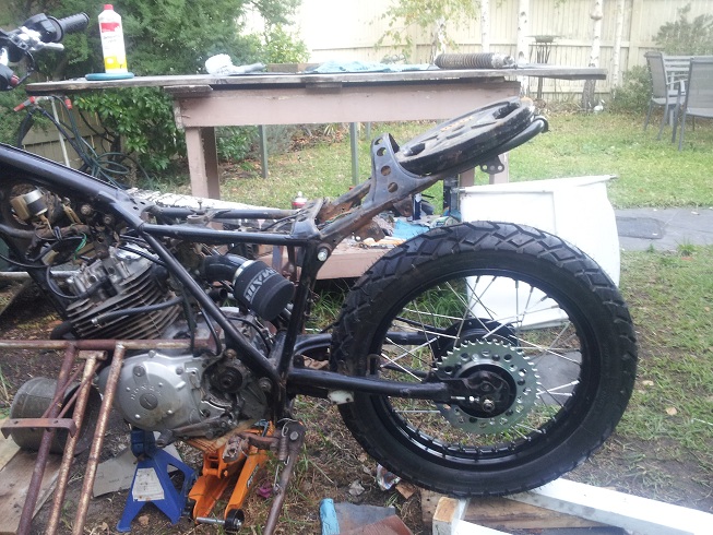

wheels trued and back on..ordering muffler, fenders and sorting seat height and sub frame next.
Any input appreciated, im kinda tall and wanted to raise the seat frame, if I cut and re weld or expand the webbing of original shock mounts would that be ok?

got a welded section in to raise tank/seat.. stock felt way to low for my height. still need put one or 2 bars to support, and plenty of space for battery holder

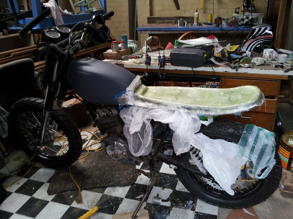

welding tank support and sleeve. First time fibreglassing and no idea how it will turn out. mildly optimistic! It seems some guys just do one layer to start..then add more..others 3 layers straight up. ended up with some areas 2 or 3..but not all over. glassed 4 1/4 bolts in .

Seat sorted. the checklist gradually shrinks..exhaust and electrics next..
