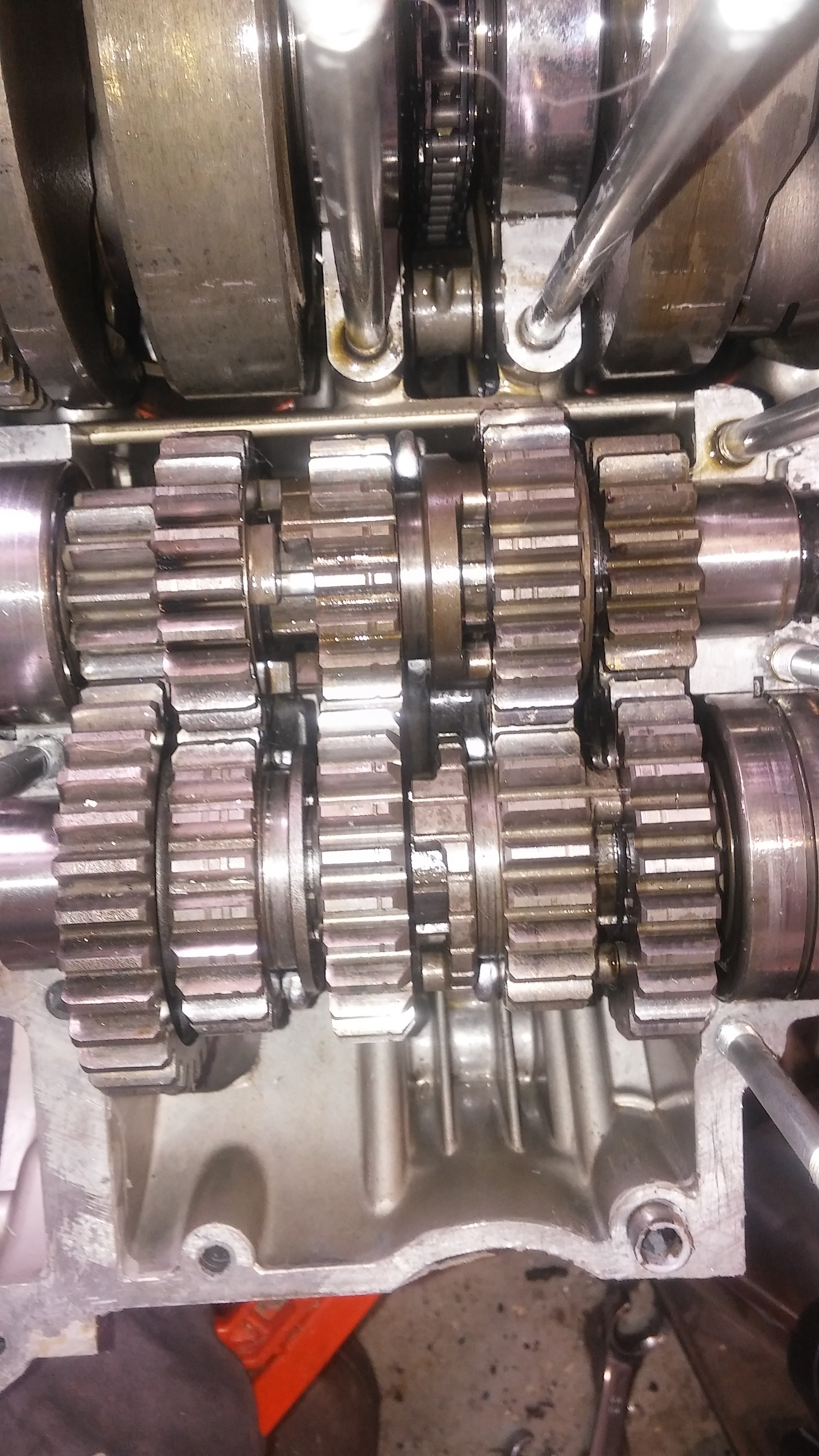

Well the built trans is in. Gotta finish the rephase on the cam and degree it in now.

That looks the best way to do cam, saw it on Chopper Underground a few years ago. Cutting and welding is real difficult as shaft distorts and can't be straightened as it just cracks. Don't remember how many attempts I had on mine before it was acceptable run out
I had a cam cut / welded, and shipped directly to a shop in California for a Shell #1 cam grind.
Got it back and there was too much run out on it.
So then I got a properly rephased cam from the guy who pioneered cutting / using positioning pins / bolting it back together. Had that one done with a nice cam profile and it worked a treat. Mrriggs was the guy for this back in 2011.
http://www.xs650.com/threads/rephasing-the-cam-shaft.7403/
How are you putting the cam back together? Did you drill the positioning holes before cutting?
I actually half way rephased this cam about a year ago. I put it in the mill/turn I was running and had it drill the 2 3hole patterns, then use a parting tool 90% of the way through. I finished parting it on my little lathe today and put it back together.
It has the .25" dowels to align it, the cam gear holds it together and if I get frisky I'll dig out a few aircraft drills to drill and tap it.

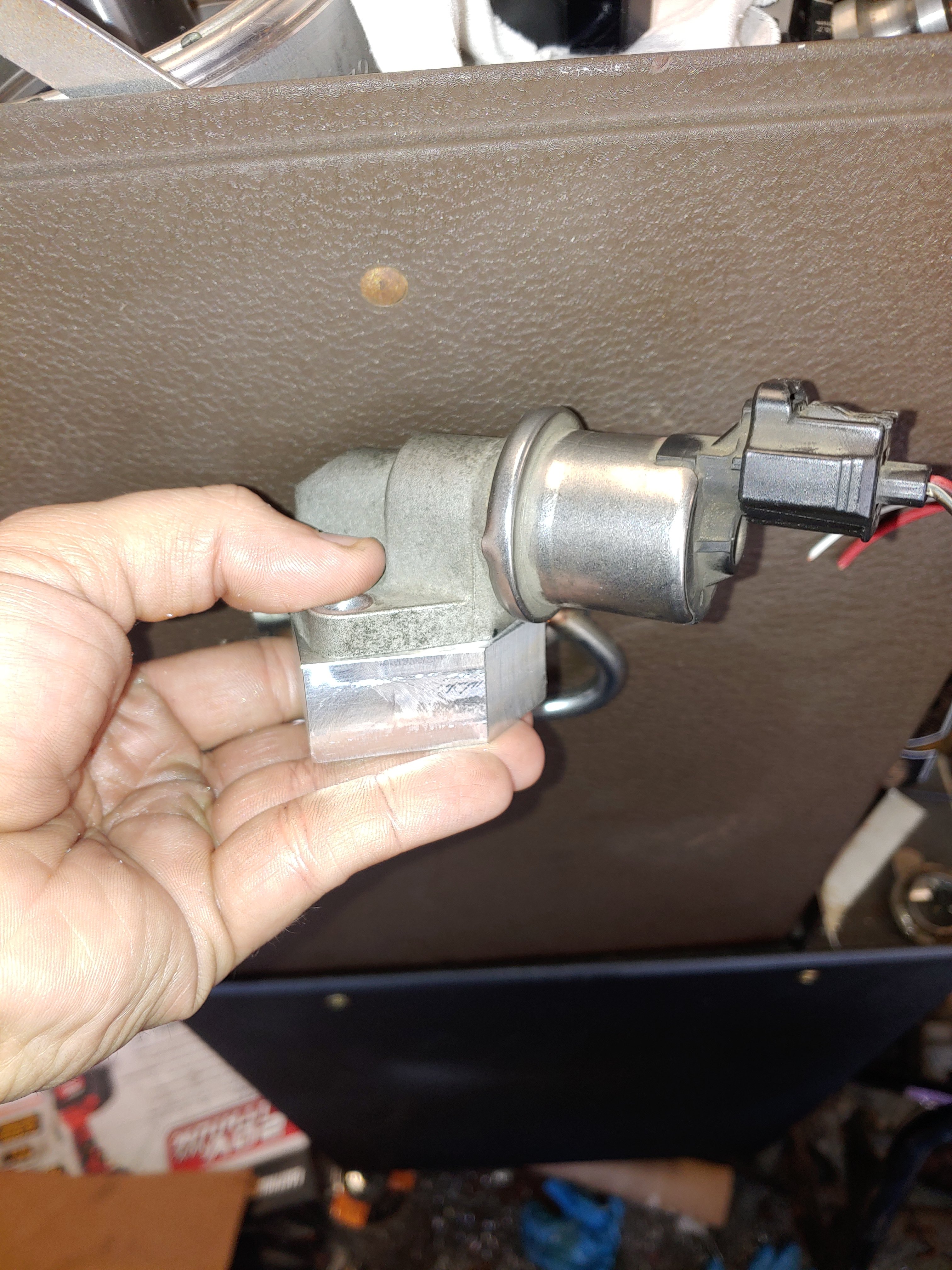

Well the new IAC is just waiting on a m6 tap to get here. And then within an hour it should run again.

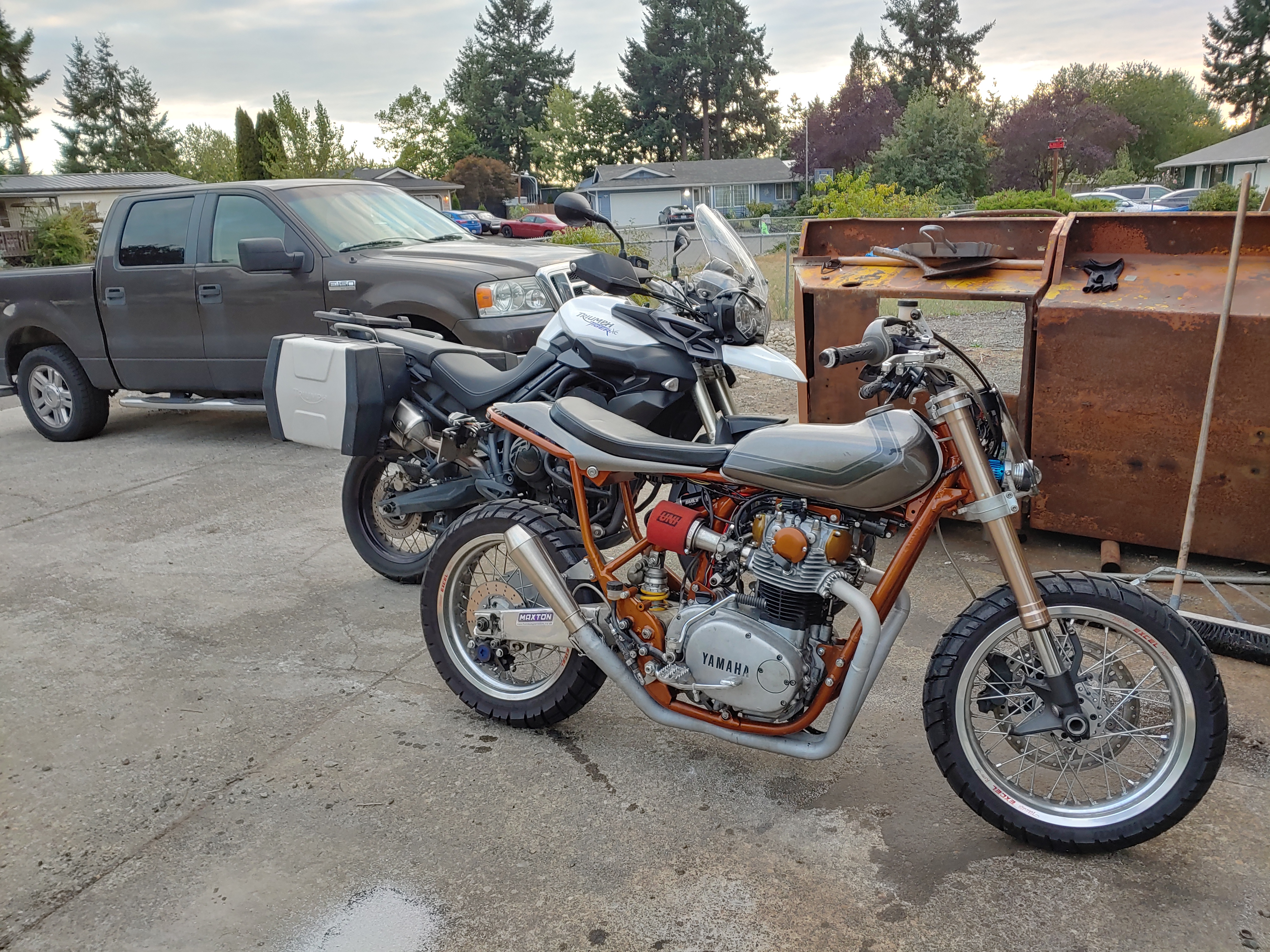

The XS motor definitely lends itself to many styles of builds.
Thanks! I'm very happy with ho it came out. Got it started back up today and it does sound different with the XS1 cam in there. Gotta adjust the chain and I can take it for a spin.
Well, running and ready to ride. Still need to get a front fender on so the cops don't hassle me.

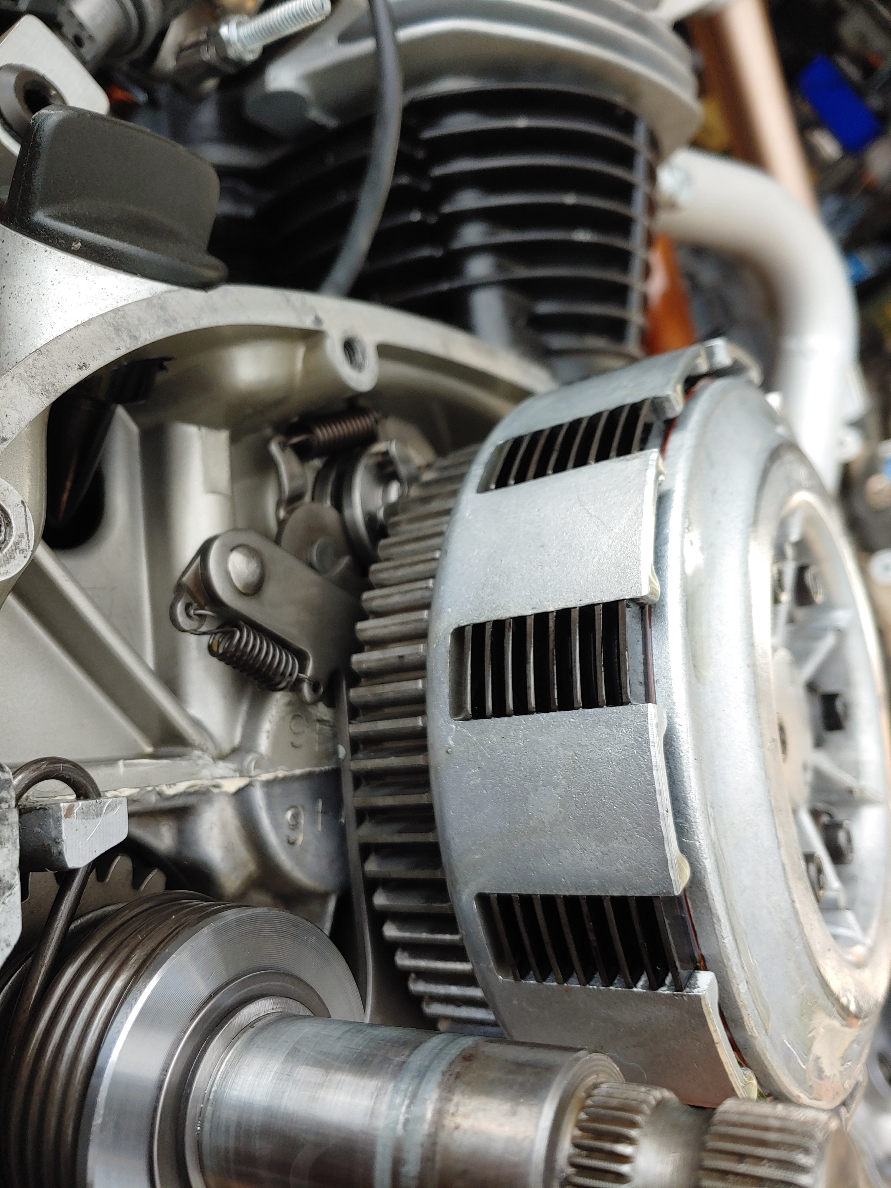

Well with the dyno coming up on tuesday I got busy. Valves adjusted, oil changed, throttle bodies synced, and clutch upgraded.
The clutch upgrade is an APE GS1000 extra plate kit, I just used the friction discs which are 2.5mm instead of 3. This allows you to put 8 in rather than 7, with just a .4mm increase in stack height. Between the extra friction area and the +15 EBC springs the clutch should hold a much hotter set up than I have.
