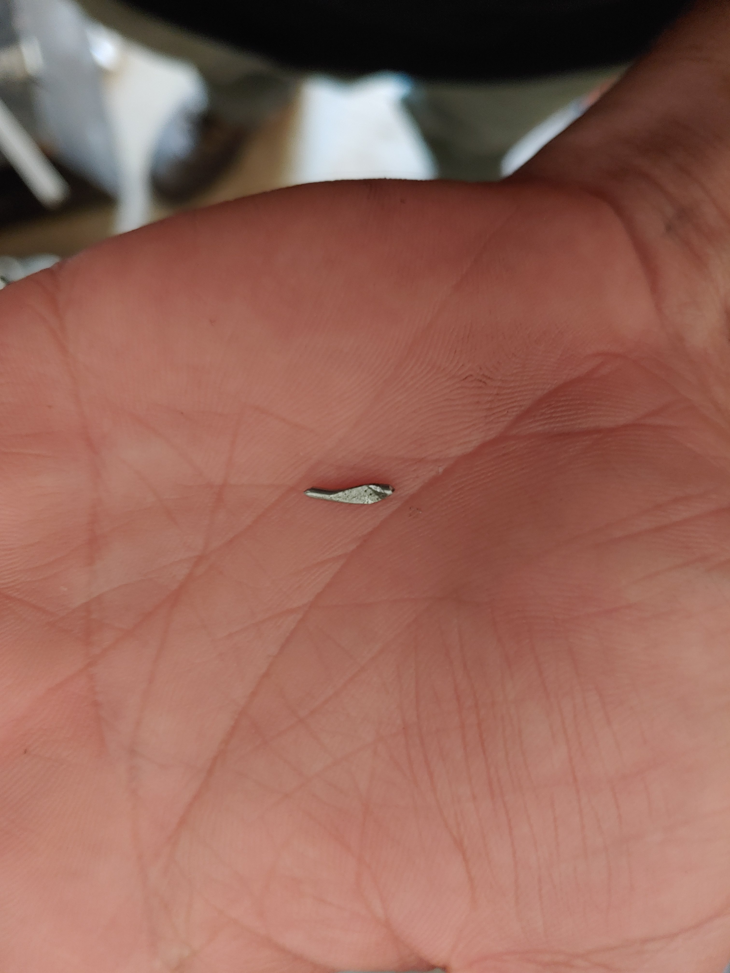

Not head gasket or a ring failure. A wrist pin circlip failed, which caused the oil ring to get jammed, which gouged the cylinder. Such a simple part to kill an engine. So the fix will be a 700 kit. That'll take the bore big enough to remove the damage.

I could probably find some the right size. But I think it might have partly been the design on the circlips that came with the pistons. Instead of just being C shaped, they had a tail bent off one end that stuck into the middle. It could be as simple as I didn't seat it right, to the wrist pin knocking it out of place on install, or bad design. But the JE 700 pistons fron Hoos have normal c shaped circlips, and that is what will be going in.
When fitting circlips, it's a good idea to have the 'heavy ' end at the top even with ordinary 'C' type. When you have a removal 'tail' there isn't a slot in piston to remove circlip, makes life a bit difficult so it's more important. Looking at the piston design, those were the wrong circlips for the piston.The inertia at TDC is much higher than at BDC. It's not in any Japanese service manual though as it 'shouldn't ' matter where they are. I always fit them heavy side up as I may exceed design rpm limits a little (or sometimes a lot) :)
Pretty sure you would need circlip groves machined with a square bottom, probably more trouble than it's worth? Standard circlips will work fine to ~9,000rpm as long as they are fitted properly
