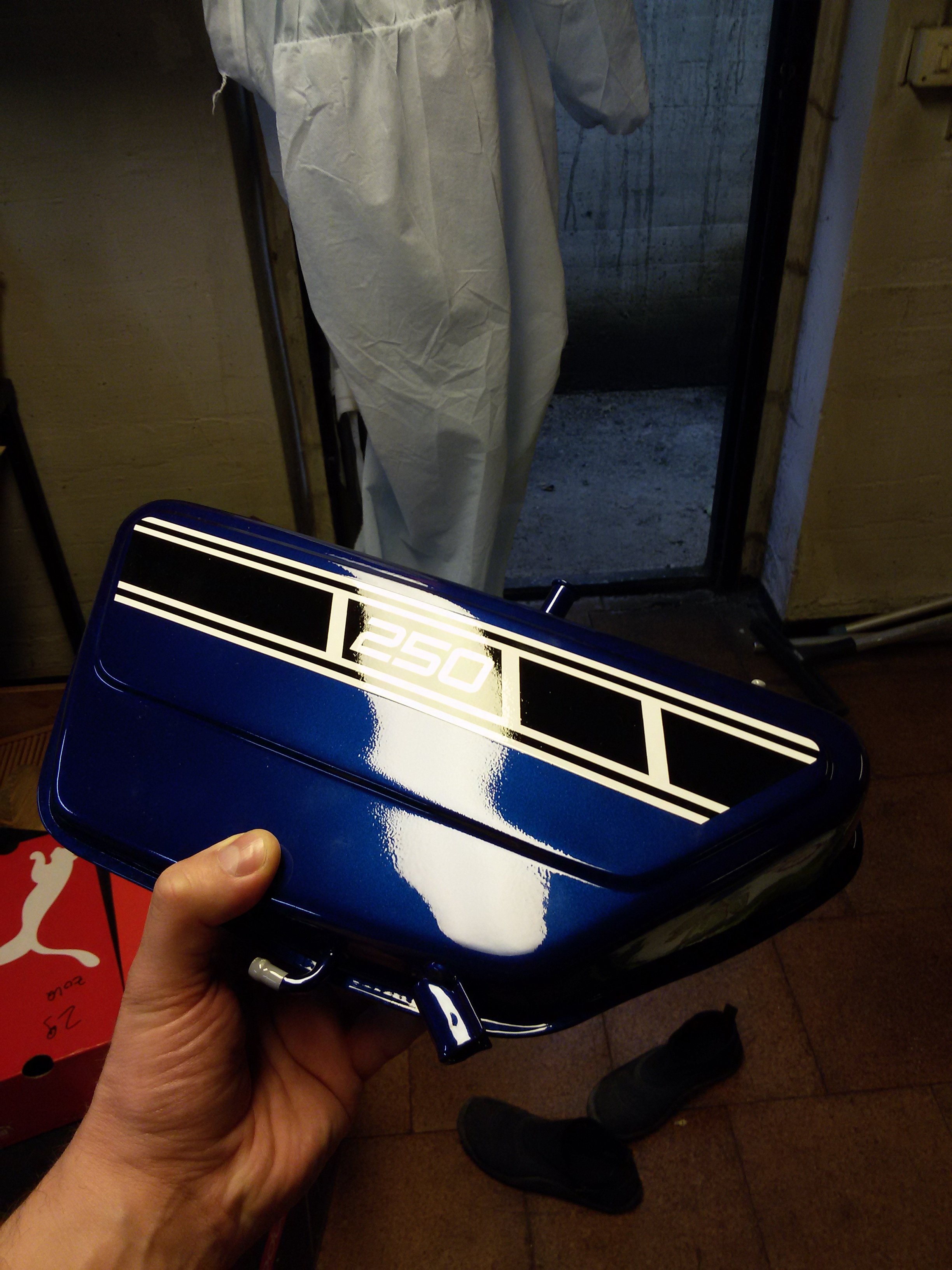

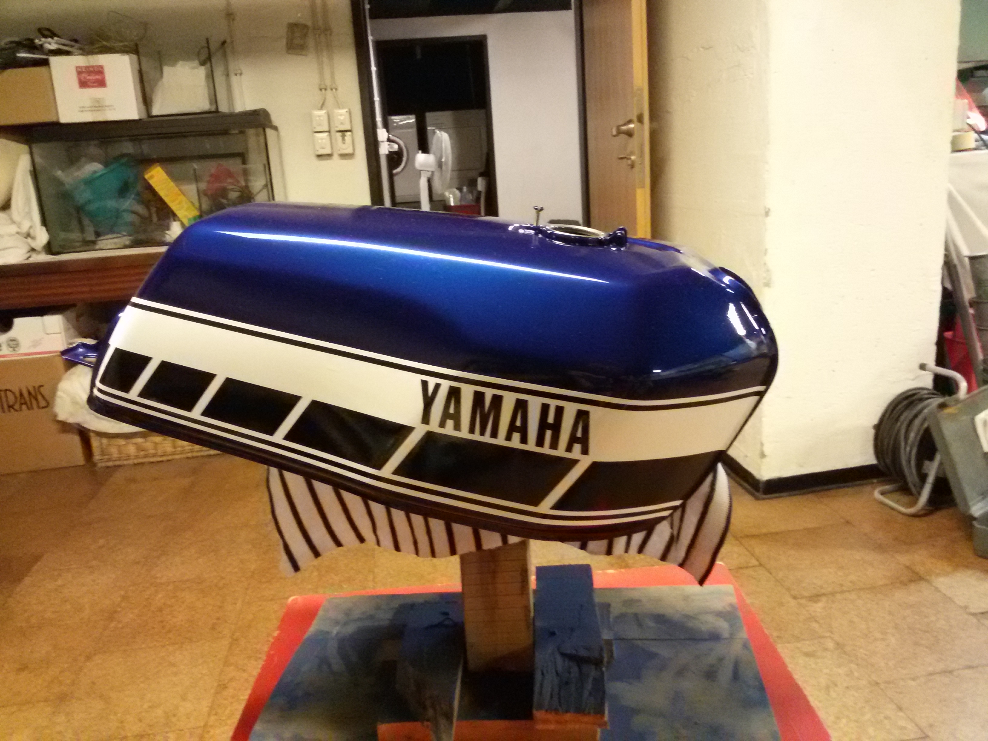

Here are some little snapshots of my parts,i will post the whole process next week!!

Wow, that looks excellent! You should be pleased! You should be able to get it much, much better with a little more work. You are definitely past all the hard stuff, and you should find the rest a piece of cake. 24 hours should be way plenty of cure time to sand out that orange peel and scotchbrite easy to damage areas. Put down another coat or two of clear, and you can sand and polish everything to perfection. This is the time to be careful. No doubt you are feeling the pressure of every additional stage of work endangering all of the accumulated work already done. One moment of carelessness can put you all the way back to square one! You do not have to sand out 100% of the orange peel to add more clear, but you do need to hit everything with the scotchbrite. Once you have enough clear applied to have confidence you will not accidentally sand through, you can sand everything slick and polish. Looks like you will have an absolutely beautiful result!
You look like you have a lot of peel on some of the parts but you should be easily able to remove 100% of it. Your oil tank looks like it needs a good bit more clear, but the top of the fuel tank looks like it has plenty so keep this in mind when adding clear and of course when sanding! Remember, I am just looking at pics and guessing! Be careful to dress up the gas cap mountings with a hobby knife or file or something - the paint looks pretty thick and probably you will have to carefully remove paint to keep it from chipping maybe a big chip off when fitting the cap - some are surprisingly precise fitting. Cutting and polishing is not hard, but you do have to be careful. There are a lot of different preferences, but this is what I do:
I avoid sanding close to edges and hardware like the gas cap mountings unless there is some defect that needs fixing like trash or a drip or something (or is dry and HAS to be polished to be shiny) because as long as the clear is shiny, orange peel is not very noticeable in corners and at edges. The buffer can very quickly cut through corners and flanges, so avoid those areas, and if you need to get close, protect them with some tape. I usually use #1500 very wet and a flexible sanding block to keep the surface uniform. Use a continuously flowing water supply like a garden hose so that any tiny grit that may be introduced is instantly rinsed away. It is easy to create dreadful scratches as you are leaving a very smooth surface with such fine sandpaper. Lots of guys use finer sandpaper but I like the #1500.

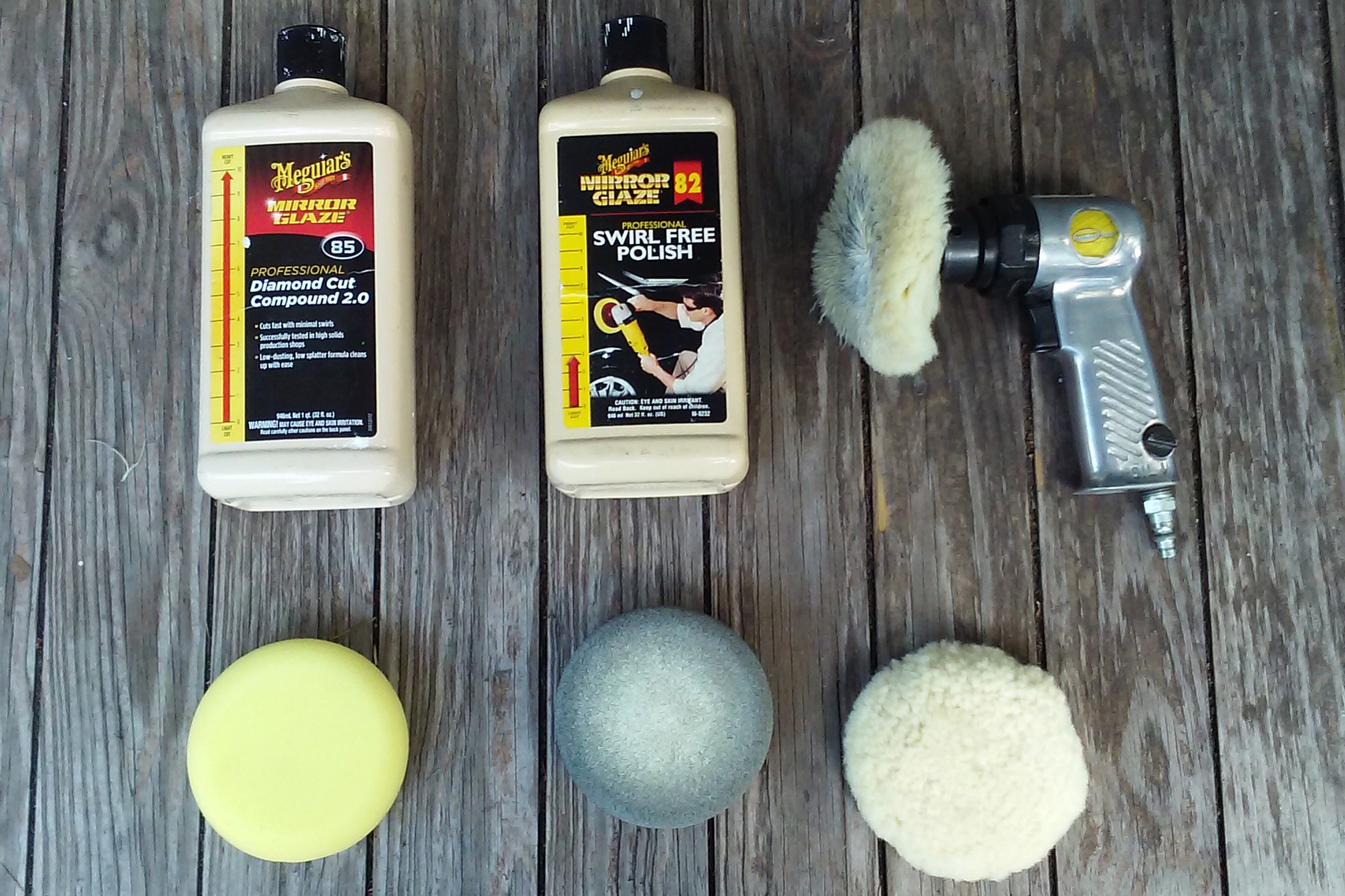

Get a small pistol grip buffer. You can use a big electric one like used on cars, but they are very dangerous for small motorcycle parts!! Buffing wheels can catch instantly on your parts, and fling them over the fence into your neighbors yard before you realize anything has happened! So you have to be careful. There is a lot of good products out there - good ones are usually pretty expensive if you are used to buying car wax. You get what you pay for. A little goes a loooong way. Be careful polishing. The buffer will put considerable heat into your paint, and 2K needs very little so don't stay in one place - get the paint too hot and you will be starting over, but you have to be pretty careless to have this problem - move around and come back, do a small area at a time.
Here is the stuff I use. Only use one pad for one product - don't mix. I use the wool pad with the coarse compound after sanding, and the fine compound (often referred to as "glazing compound") with the foam pads to remove swirls left in dark colors from the wool pad. It takes me probably an hour + to sand and polish a gas tank for example.

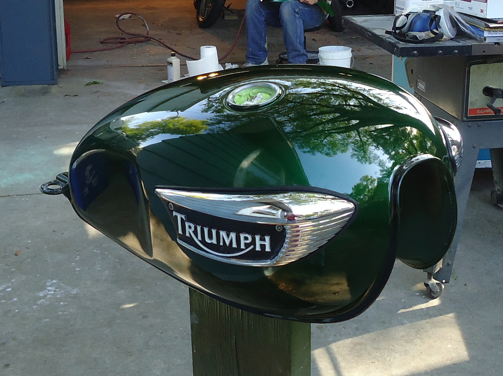

You should have EVERY expectation to get your parts to look as good as this Triumph tank! This one is ready for a first coat of wax!

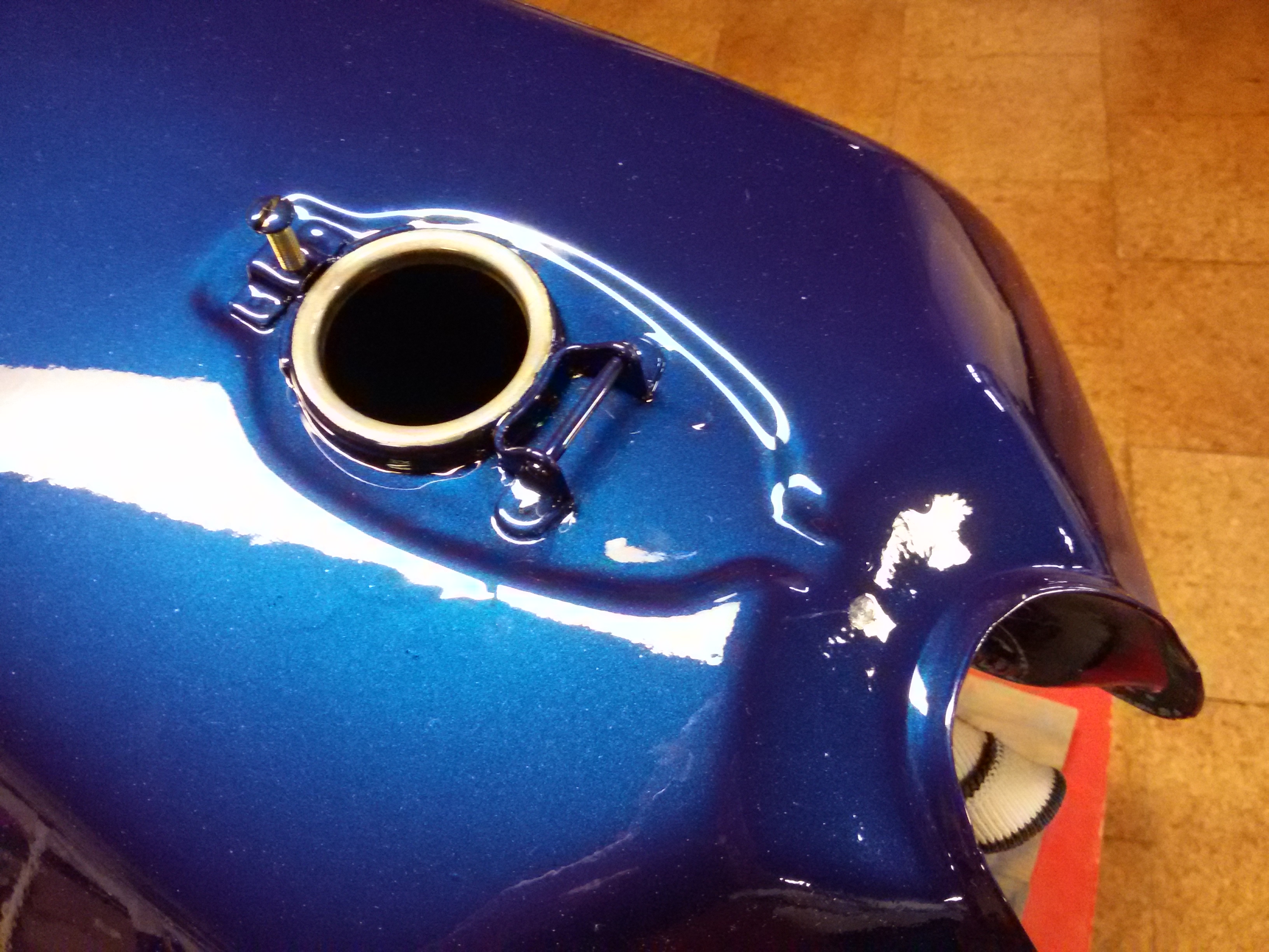

had a mishap on my last 2K coat (oil tank),touched a hanging part with my shoulder (you should have heard me SWEARING >:( ) which resulted in a uneven dimply part of the 2K (still has 2 coats of 2K under it).
what is the best way to refinishing that spot of 2K,i would it it carefully by hand with a 800 grit,then watersand it with 1500 grit till it "polished" out.
question 2: is there normally a cure time for the 2K to be fuel resistent or will it be "fuel proof" when its fully cured?
today i started putting the bike together,it is so beautiful to see stuff coming together which is completely DIY.
i also started putting the pics in order for the process yet to post.
I am no pro but if it were me I would sand that spot flat and shoot a layer of clear over the whole thing. Maybe it's not too deep and you could polish it out but you would have to be very careful and take your time as to not cut through to the color coat. I haven't painted metal in years it's mostly been guitars but the same rules should apply. Let's see a picture of it all together!

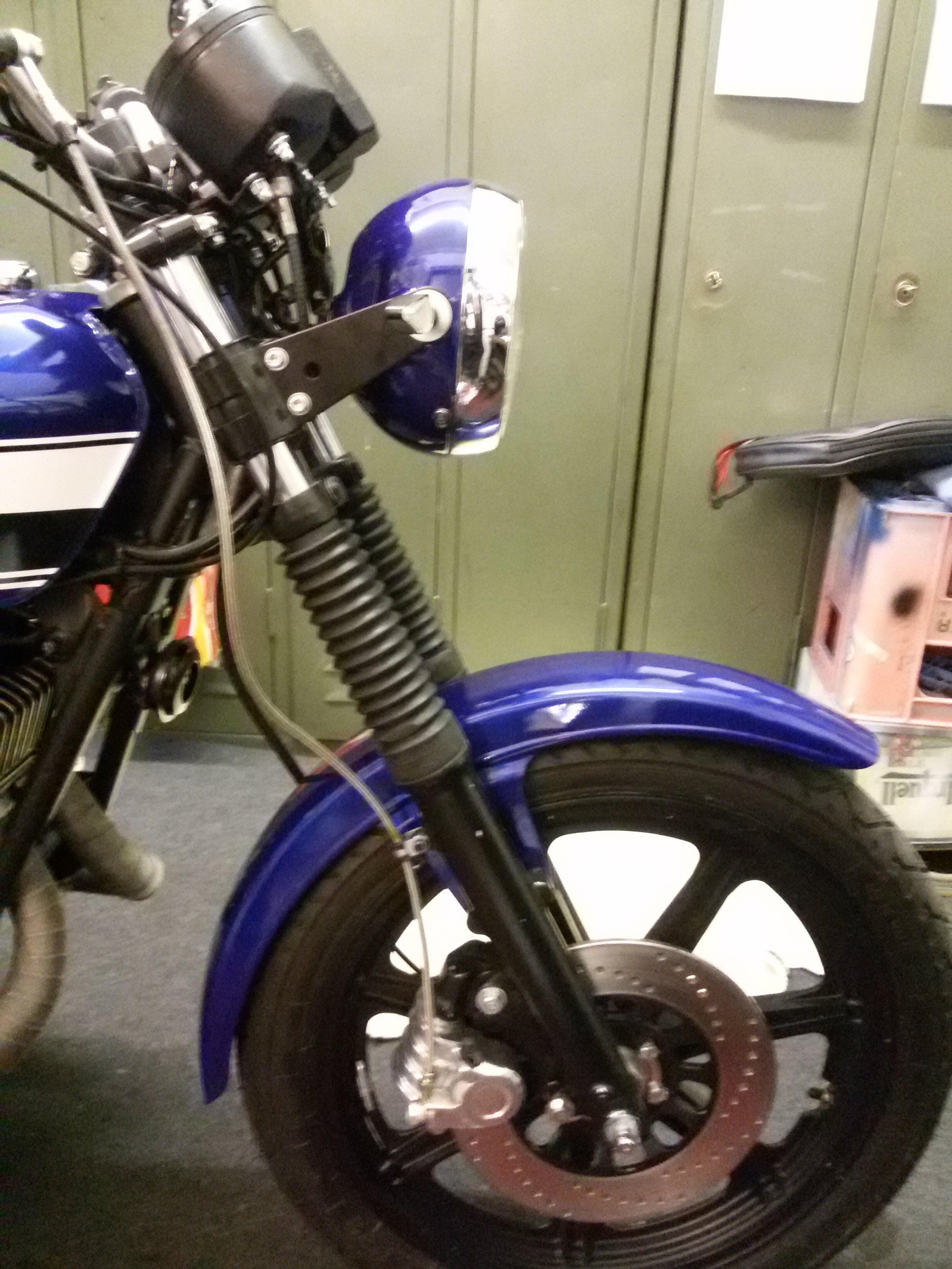

Not totally finished,ill do that tomorrow but here are some pics :-)

You are doing good work and if you can take a pic of the spot we may be able to help with the fix better.
Ryan Stecken said:
........anyways i will still ask you guys the following:
what is the best way to refinishing that spot of 2K.......
Wet sand with 800 and reclear.,

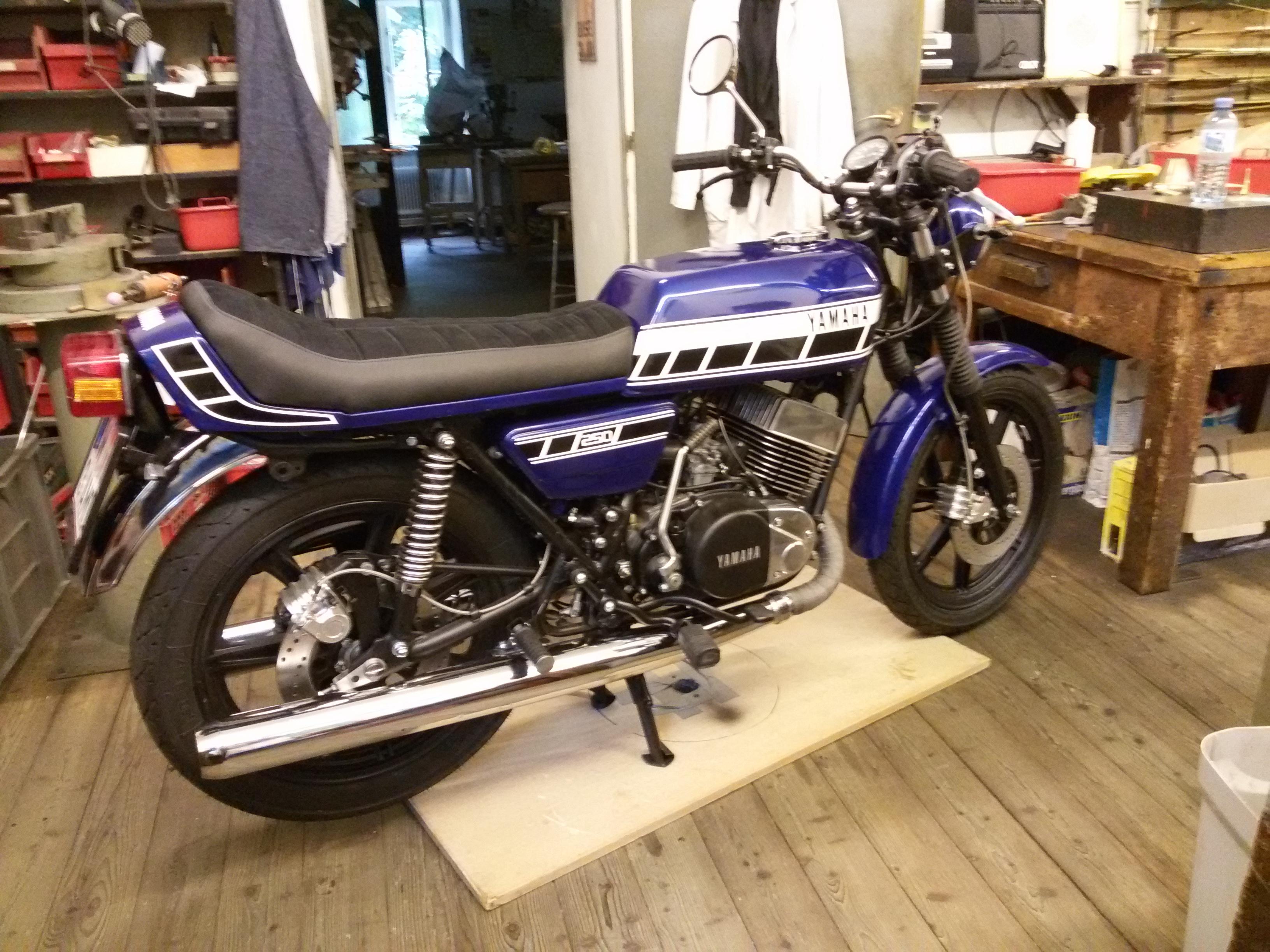

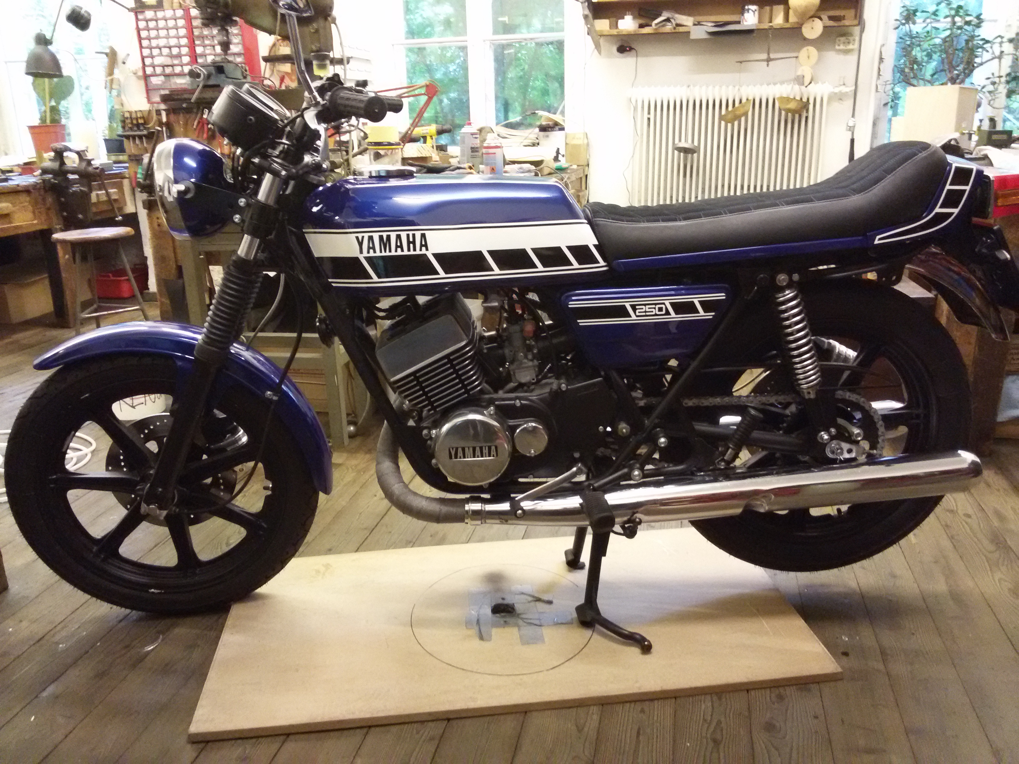

Here are some pics of the RD :-)

thank you guys for your support and help!as promised i will some pics of the progress.

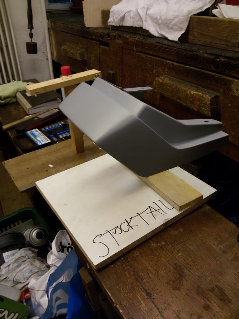

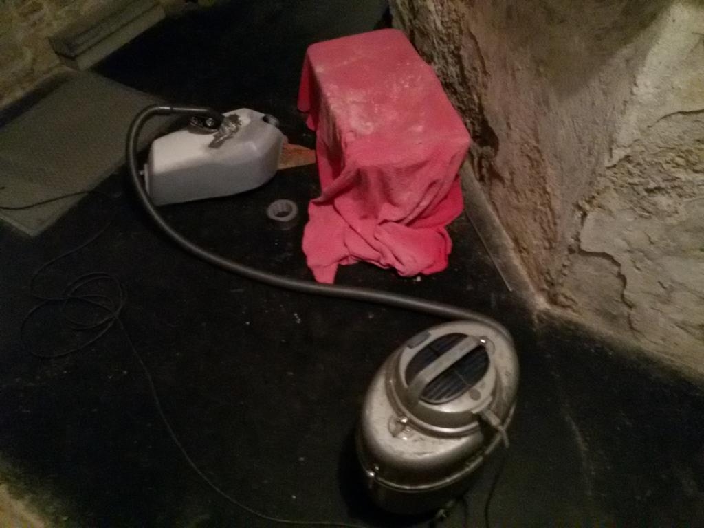

First i started purging the gasoline from my gas tank (prep for sandblasting) removing the paint from my headlight bucket and building stands for my parts out of wood and stuff i had lying around :D

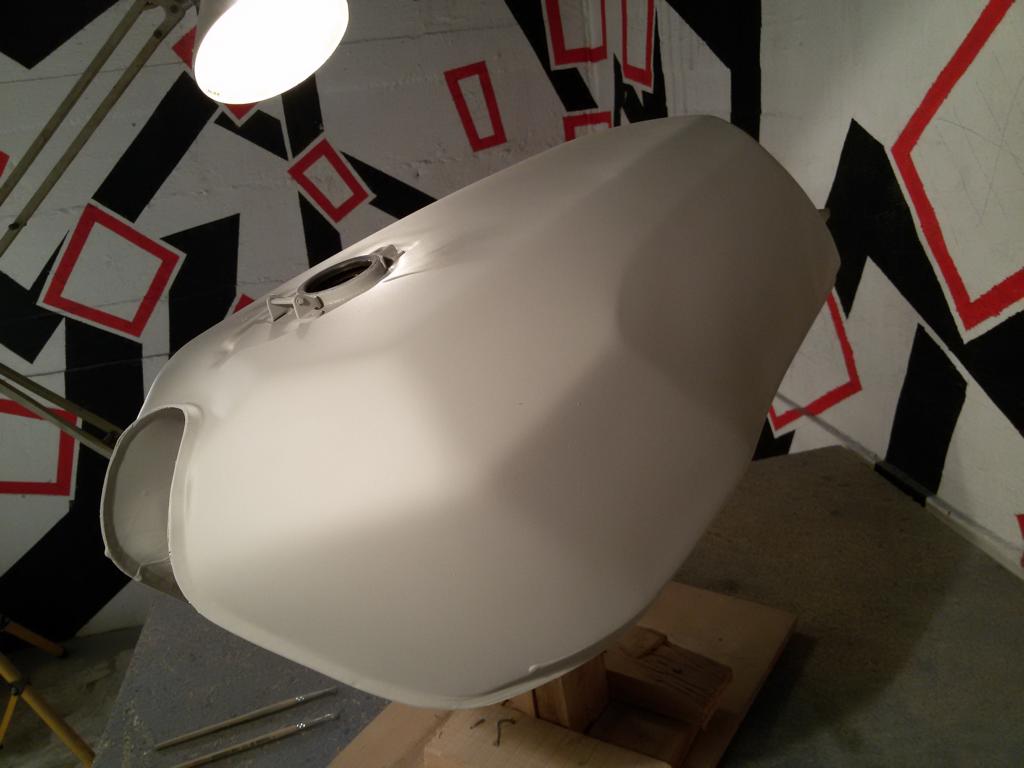

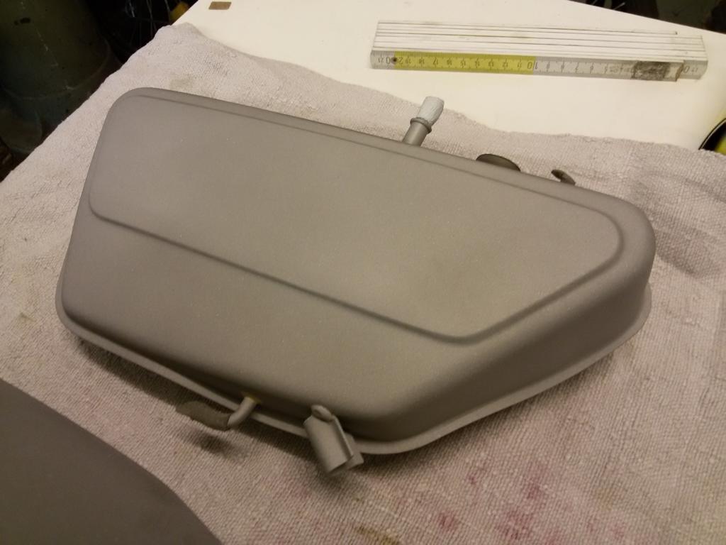

then i got the parts from the sandblaster,luckily there was nearly no putty on the tank and on the oil tank so i could just start rightaway (some hours after i received the parts) to prime them with the epoxy paint.the other parts (plastic parts) were primed before with 1 K rattle can.
the epoxy rattle laid on so super sticky,super thick so i laid on 3-4 thin layers,the most crucial part was to cover all areas since the metal was completely blank.
