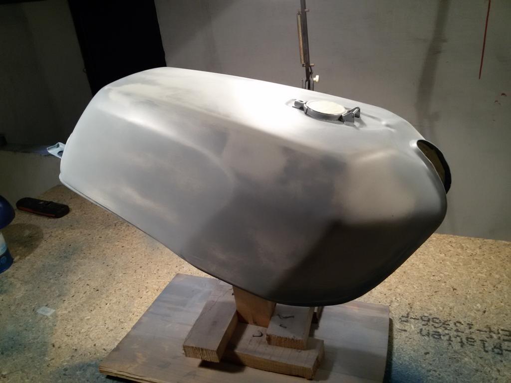

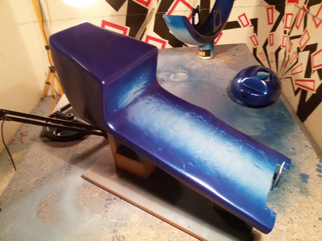

next step was sanding sanding and again sanding....important not to sand trough the epoxy.the epoxy paint was so super nice to sand smooth, no comparison to normal 1 K rattle can primer.i used a marker to mark the areas which still needed some more sanding, i used a lamp to find them holding it against the light.

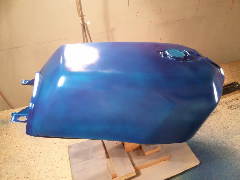

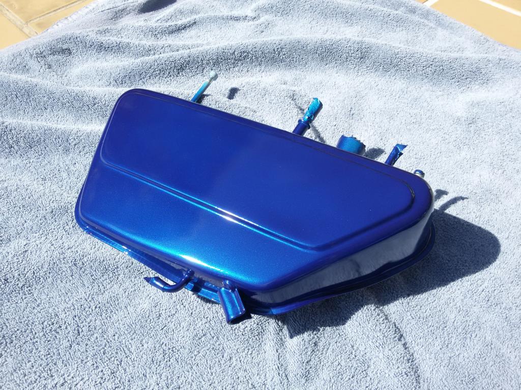

then the first layer of paint came on the parts,this was the biggest batch and man this was a LOT to spray,maybe next time i would split up the batch since one can concentrate more on one part.
the color laid on like "baby" blue and with every layer it added strength and deepness.

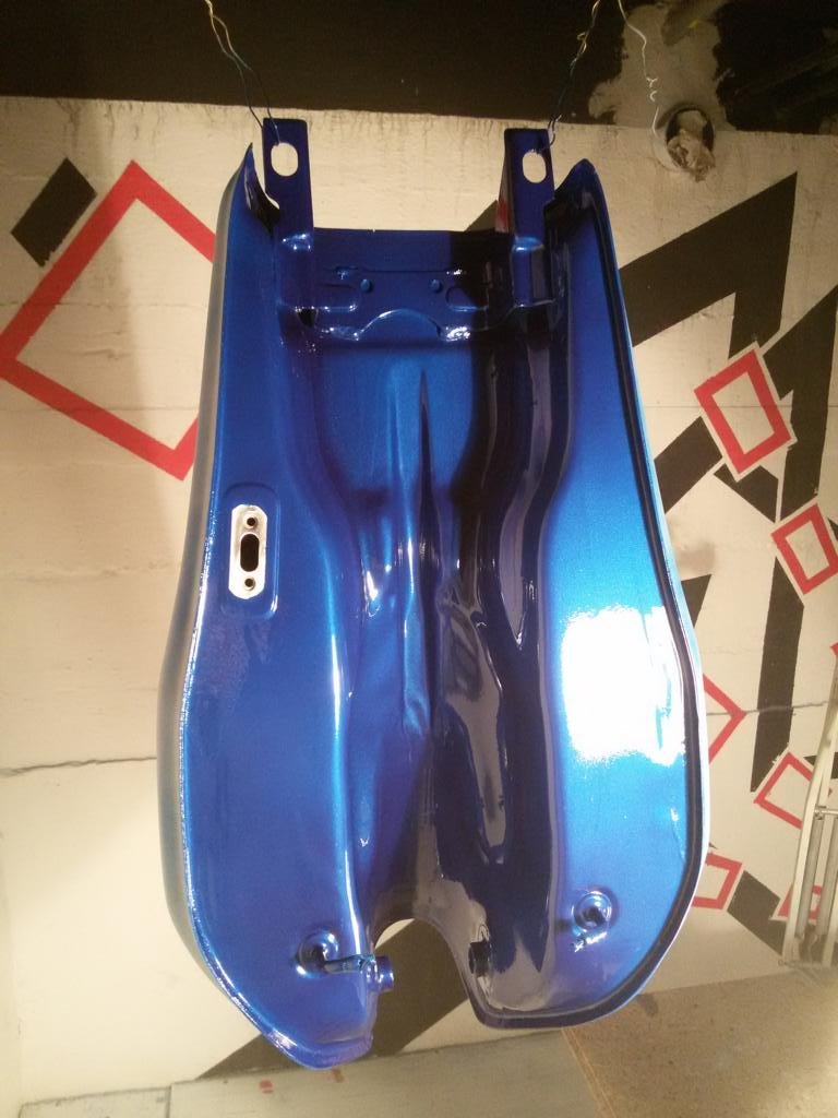

the tank was always treated separately which was a good idea,since it needed extra care,being a big eye catcher,first i sprayed the underside of it hanging.
first i laid on 2-3coats of color

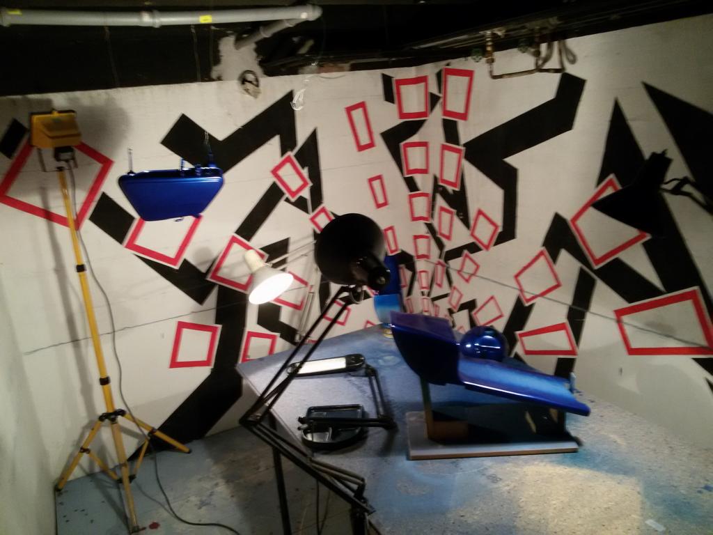

then the big day came, i laid on color on the tank.
i was super super cautious not the have any dust (tack cloth used) or contamination on the part.i used a can of Dupli color silicone deagreaser all the way trough,and had no problems.

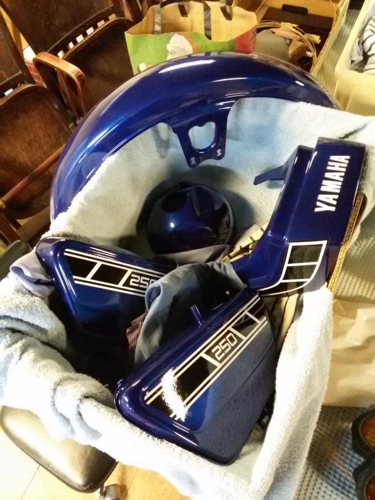

then the process again started all over,after color and 1K clear coat i scuffed the parts,put on the decals,the only ones i didnt not put on where the tank decals (crazy big),i let them do by a specialst who wraps cars because i already narly had heart attacks at the other decals.

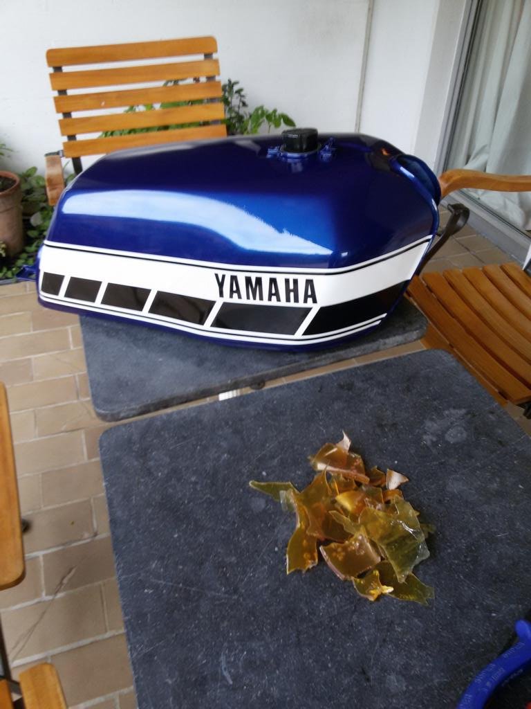

finally everything was done...then i had a bad surprise.i heard a noise out of the tank when i rinsed it with water to get the dust out of it and found a big piece of my liner in it.
so i hope this is just a surplus from lining the tank....
it was a b´´´ to ge tout of the tank.
i filled the tank with some premix and will ride it this way,lets see if it will rust,then i maybe need to redo the lining on the tank....hope i wont need to destroy the paint.... >:(

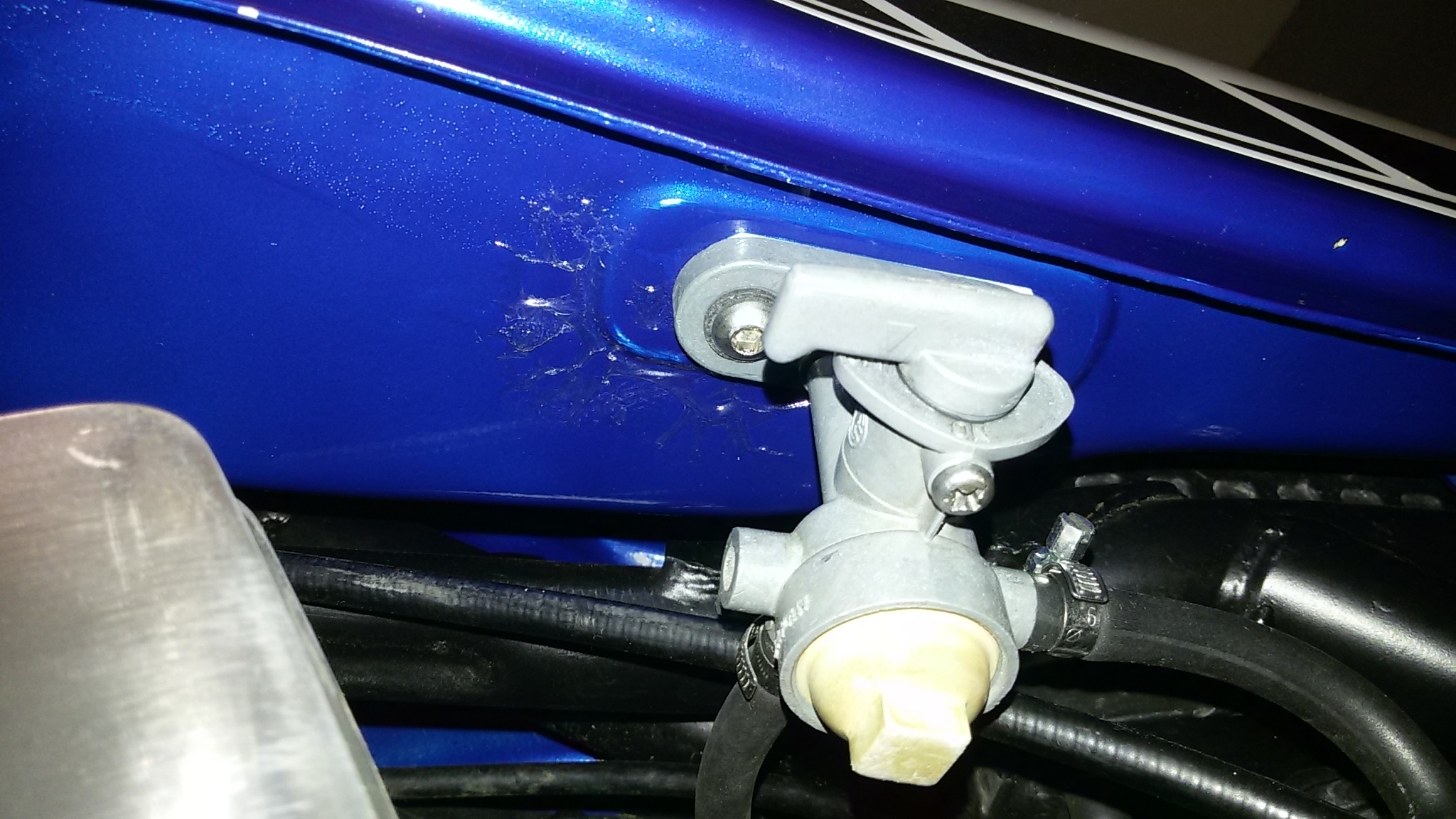

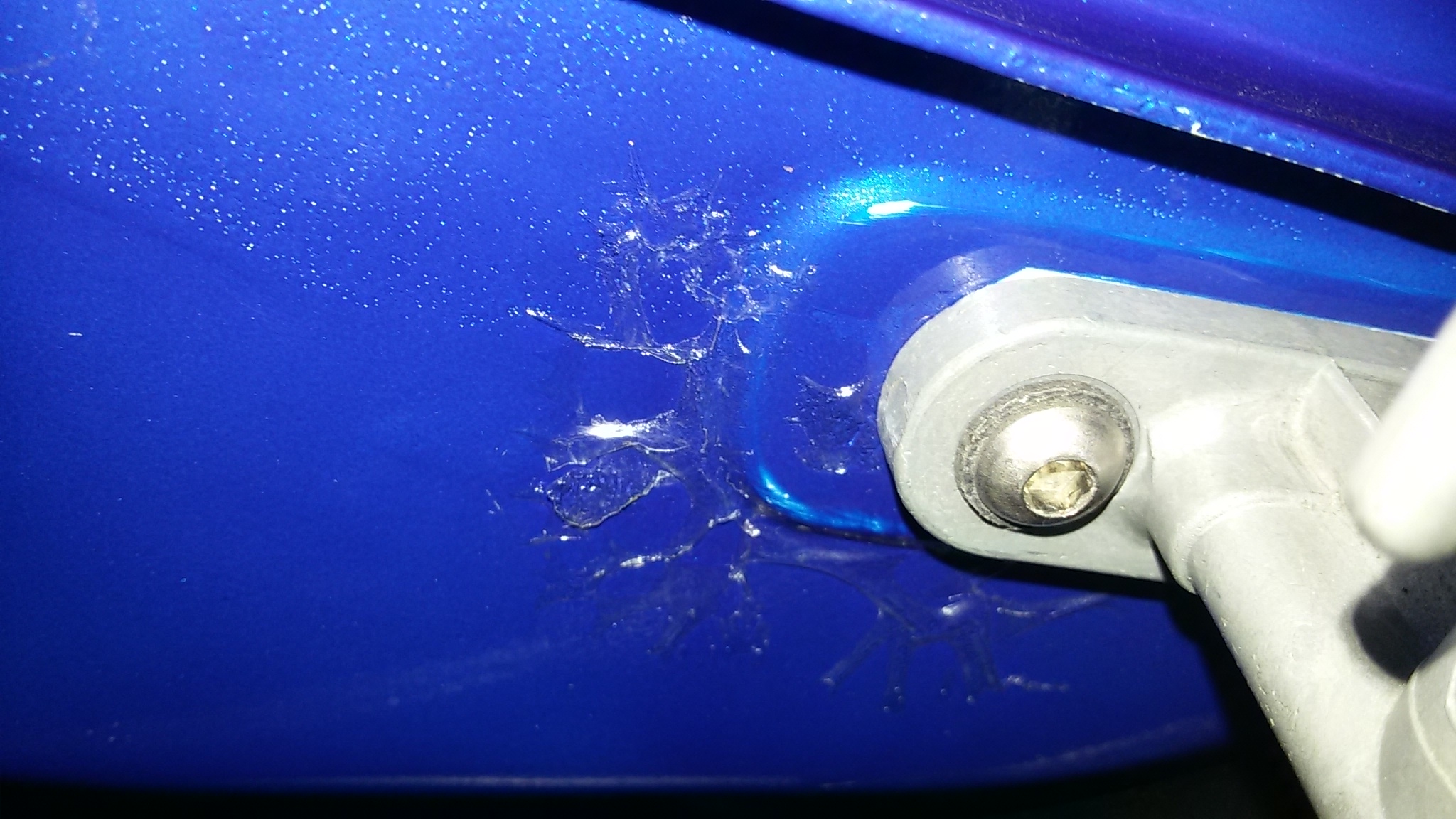

I had a bad surprise yesterday when i looked under my tank.
Seems like i made a mistake and painted to much of the area where the petcock touches the tank.
I tried to make a blank piece of steel where the petcock is fixed...
Gas seem to have 'creeped' under the 2K.....it didnt felt wet when i touched it,the paint is fully intact,the epoxy primer too,so i hope this will hold up this season so i can repair it then...

Very likely you are exactly correct i your assessment. The clear is probably pretty impervious to the fuel, but the blue probably is quite easily dissolved. I usually try to 1) leave a bare steel patch bigger than the o ring seal, and 2) make sure the paint is super thin - even if I have to sand it thin - so the o-ring can sufficiently compress. Otherwise, I mask off the exact footprint of the petcock and then the petcock fits fair down on the steel and doesn't interact at all with the paint.
You may be able to salvage the situation by removing the petcock and sanding the paint off under it. You have to stop the fuel from eating the blue or it will continue to do damage.
You can have this same situation around the fuel cap as well, so maybe inspect it and sand all the paint of the sealing area if present. Otherwise fuel will wick into the blue and ruin a much more obvious place.
Thanks mobius!
So i guess i have to:
Take the petcock off
Get the fuel out of the tank before :-)
Sand the whole tank with 1000
Sand the area around petcock flat
Tape down bigger area around petcock
Degrease
Shoot 1 can of 2K over the whole tank
Before i waste half a bottle of 2K i can lay down another coat on the rest of the tank...however these cans are just 200ml...what you think?
Or i lay it down thicker on the bottom of the tank and tape off the top.

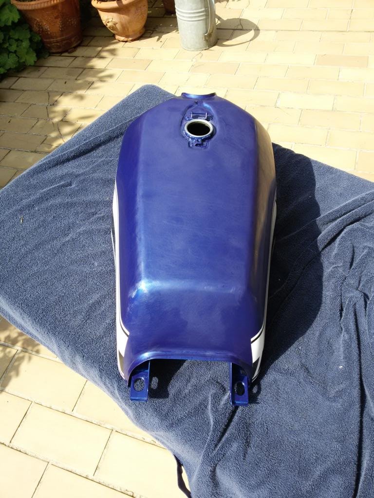

My clear coat has mostly a shiny finish, some parts have some orange peel and some a slight dull appearance (top of the tank).Will I be able to polish that out just by hand with this product?Any experiences?

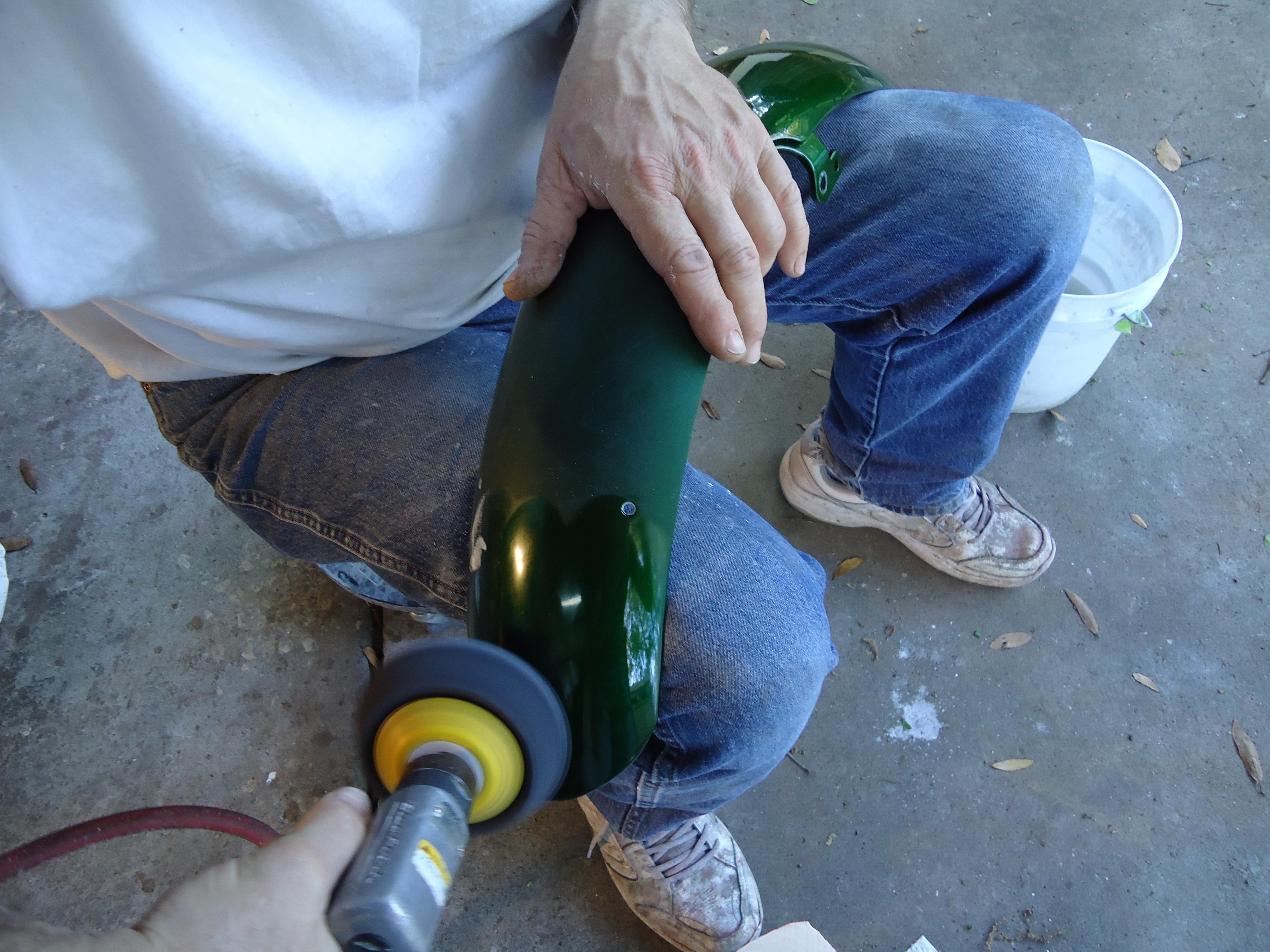

Without seeing it in person and based on your description, I would say no, probably not. However, you should be able to polish it to a VERY high level of shine. The process is simple enough, but does take a little practice and care as paint is fairly easy to damage. It also requires that you have sufficient clear to allow you to sand it flat without cutting into the color under it. This is not difficult to avoid if you are careful. The goal is to sand the paint so that the surface is perfectly smooth with no orange peel in it. On bike parts, you can focus on the large areas and not fuss too much over the edges as they are extremely easy to damage and only have a very small impact on the overall appearance. When I paint, I focus on the edges and make sure the paint goes on very wet there so it flows out well and I don't have to fuss at polishing them. You want to use very fine #1500 - #2000 grit paper very wet, and take great pains to not contaminate the paper and introduce scratches that are bigger than those left by the paper. You should use a semi-flexible rubber pad to keep the surface as "flat" as possible. It is helpful to have a soft rubber squeegee handy to strike off the water so you can see if all the peel is gone. Once the surface is perfectly flat and uniformly dull you are done sanding. If you have enough clear you can sand the edges of the decals perfectly flat so no ridge exists, but I would suspect you do not have that much clear on your parts as it takes quite a lot for thick decals like you have. So be very careful when sanding the edges there as well as it is easy to cut through. Once you are done sanding it is time to polish. In theory this could be done by hand on the materials you used as heat generated by machine polishing is not required, but you really need a machine. I use a little air driven 90 degree grinder/polisher/sander with a 4" wool pad on it to start. You will need some compound to go with it. This is basically just another sanding operation, except now the grit size is so small that the scratches are pretty much invisible to the naked eye and the result is shiny. You have to be careful when machine polishing to avoid the sharp corners and edges as you can cut through them fairly easily. I protect suspect edges and such with some masking tape at first, and when done, remove the tape and very carefully polish those areas as a separate task. After polishing with compound you can switch to a foam pad on your buffer and use some finer glazing compound (swirl remover) to improve the surface even further. At this point you should be well beyond what a new car is sold with and should be very happy. I like Meguiar's products, but there are many others. Here is what I use, a picture of a sanded fender getting polished with coarse compound (you can see the opposite end has already been done - I'm using a foam pad here for some reason but normally would be using a wool bonnet), and an example of results you should easily be able to achieve yourself.
