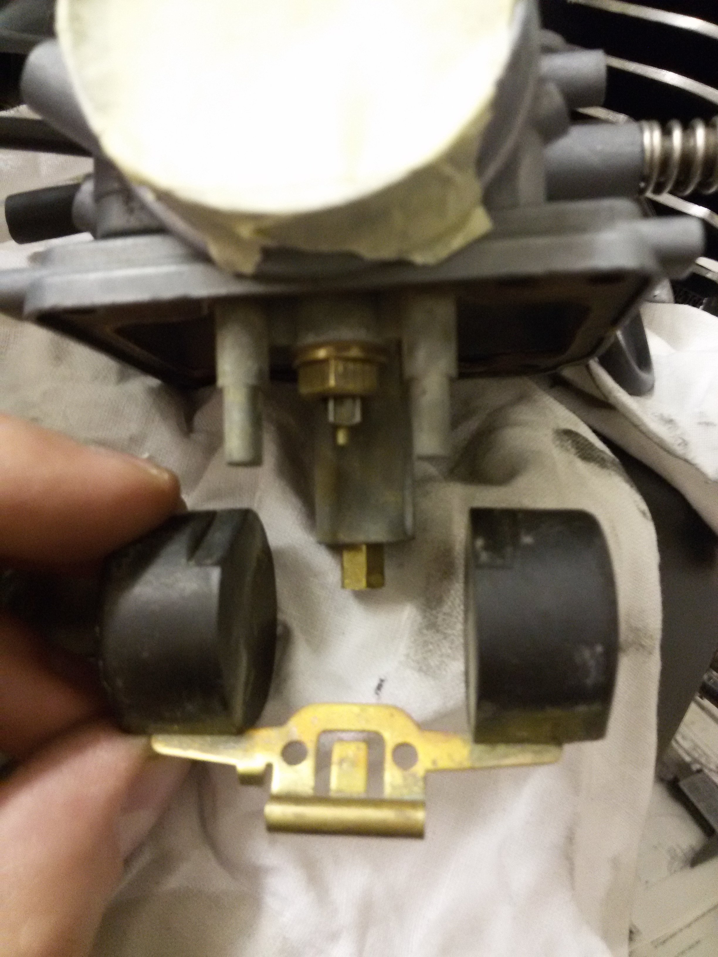

I also checked the slides....the angled part was mounted backwards as you can see in the pics.
Does one slide come in a certain carb or is it possible to out them in any of them?
I checked the manual and tried to check the markings of the slides trough the side maintenance holes closed with the screws.
As you can see in the pic the marking is only a tiny bit showing in the drilling so is this ok or should i move both slides up a bit?
Pics show left and right carb
And
Position of carb markings

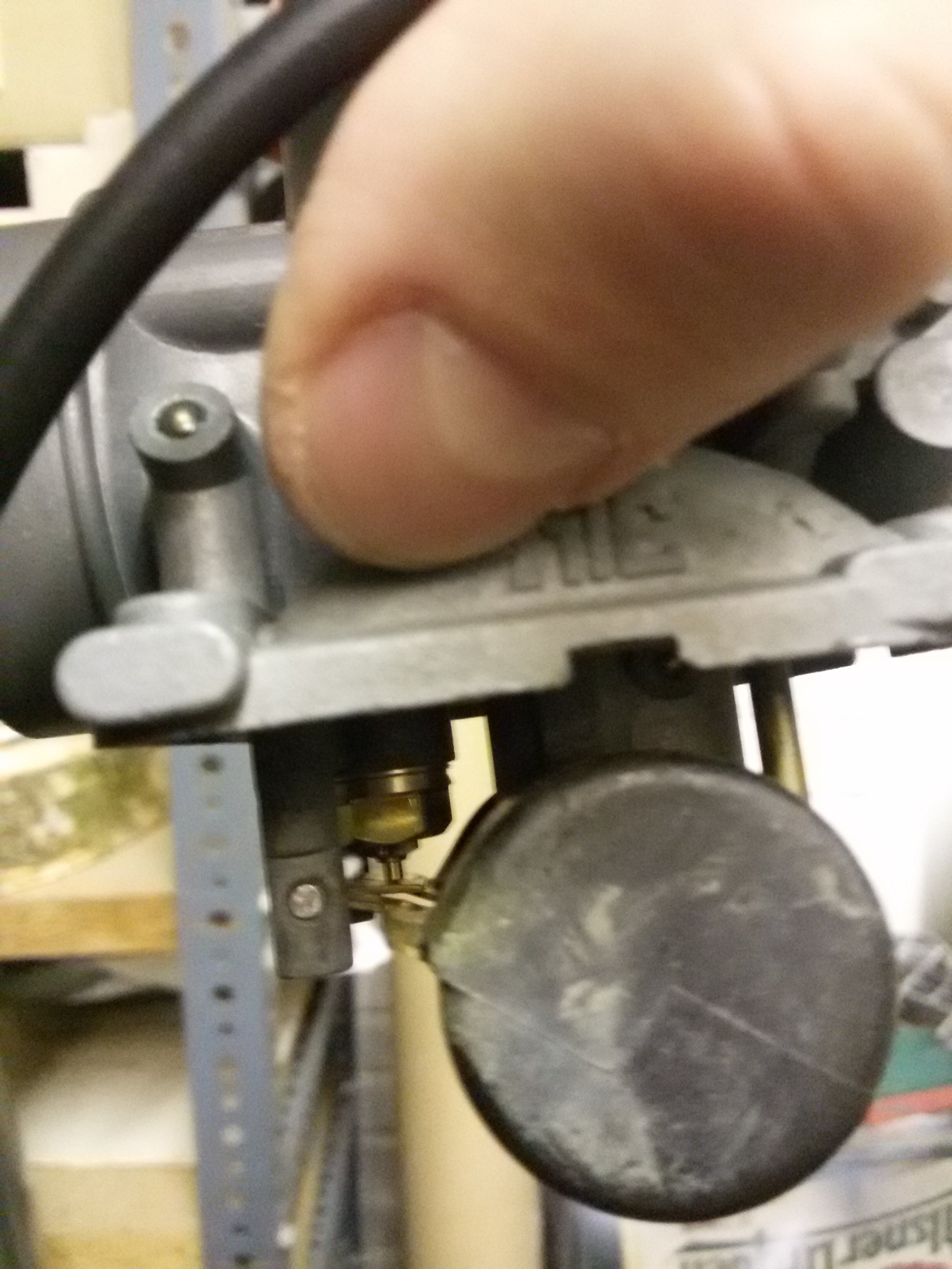

As i was disassembling the carb bowls i checked on the float levels.
The left float lvl is around 29MM.
The right one is 31-32 MM.
Are the floats mounted right with the 'angled' part up,as shown in the pic?
I tried to adjust to right one to 29MM but i wont work.i bent the the tiny flag in order to adjust it but even with the hardest bent it wont go up or down....so my guess is that the tiny needle with the brass pin is old and worn out.
Is that possible that it keeps the float lvl from readjusting.
I tried to 'engage' the float mechanism by pushing up the float and realised that the needle with the pin moves out and back in of its seat way more than the one of the left side.
Should the needle stay in place or move up and down with the float flag moving?
Plz watch the tiny vid to see what i mean
Made a pic of the bent flag of the float
Guess i'll need a new needle or the seat is worn....

The slides are correctly oriented in the pics. The cutaway which is visible on the left (first pic, right side carb) faces the inlet side. The number stamped into the slides indicates the size of the cutaway, so if you are setting up carbs for an unknown application, you can exchange the slides you have with slides that have a different cutaway, similar to changing jets, or needles to tune the carb. On your RD, the slides are identical except for the right/left handedness, which is done so the idle set screws are outboard on both carbs. Otherwise, you would have to reach between the carbs to get to the idle screw on the right side carb. as far as I know, the "maintenance" bolts are only there to see the relative location of the slides for setting he idle speed. When you set up the carbs, unscrew the idle stop screws ( the big knurled hand turned screws on the outboard side of each carb) so the slides are resting on the bottom of their bores. You may have to adjust the throttle cable at the grip to get enough slack. If needed, you can get more slack at the carb tops with the cable adjusters there. Once both slides are completely closed, adjust them so they start to rise exactly at the same time when you twist the throttle grip with the carb top cable adjusters. Make sure the carb tops themselves are screwed down all the way and just snug against their rubber gaskets first. If you can't look directly into the bores, you may be able to stick one finger into both carbs at the same time and feel when the slides just start to lift. Adjust the cable adjusters until both start lifting at the same instant. This ensures that the slides are synchronized. Next are the pilot air screws. Those are the small slot head brass needles with the spring under them that thread into the left side of each carb body just above the bowls. The tapered end of the needle fits into a tapered passageway, and when screwed in all the way seals off air going into that passageway. Screw the needles all the way in, but not too tight as the needles are brass and the carb body is aluminum and both mushroom out pretty easily, and you are only looking for the reference point of fully closed. Unscrew the needles 1-1/4 turns out and leave them there. When you do this, you are setting how much air is allowed to mix with the pilot fuel system at idle. You can fine tune this setting later, but as long as the carbs are clean, just set it and forget it for now. That is all you need to do to have the carbs ready to get the motor started with one caveat; Since the Idle stop screws are out all the way, your engine will not start and run unless you twist the throttle grip a little. Otherwise the throttles will be completely closed. An alternative is to screw the idle stop screws in a bit to guess at an idle, but if you go too far, your engine may start and run at a very high speed until you re-adjust. So look into the carb intakes with the throttle closed. Start screwing in one of the idle stop screws, and when it contacts the slide, you will see the slide start to lift. Screw it in until the slide is open a millimeter or so above fully closed. Look through the maintenance hole and screw the other carbs idle screw in until it looks the same, or simple look into the carb intake and repeat for that carb. Once you have the engine started and warmed up, you can set the idle speed by adjusting the idle screws. If you start it and the idle is way too fast, just back out the idle stop screws accordingly so you can get it warmed up. Looking into the maintenance holes, with the bike idling, adjust the idle screws so the indicator in each carb is in the same place with the idle at 1200 rpm or so. Older carbs do not have this maintenance port, so you simply place you hand close to each exhaust outlet to feel the exhaust pulse and adjust until they feel the same at the idle speed you like. Once done you will probably have quite a bit of slack in the throttle cable at the grip, so adjust it out at the single adjuster at the grip. If you need more slack removed, you can get it by adjusting at the carb tops, but you will have to re-synchronize the slides if you do so unless you are super careful to make the exact number of turns on each adjuster.
As far as the float level goes, I can not tell you the correct spec for your floats as the US RDs have separate dual floats, not like yours. But, it is important to understand the valve first in order to be able to set the float once you have the spec. A lot of people seem to be confused by the float needle. The needles you have are made with a tiny spring loaded pin that contacts the float arm. This spring loaded pin does not interact in any way with the flow of fuel through the needle and seat assembly, it is just a mechanical shock absorber and pressure regulator for the force of the float mechanism on the needle. Usually when you are adjusting the float height, the pin should be completely uncompressed. On some carbs, holding the assembly upside down will slightly compress the spring loaded pin due to the weight of the floats. If you set the level this way, the operating fuel level in the bowl will be too low unless the measurement is supposed to be done this way and the weight is taken into account. So you need the specification and the method used to make the measurement. As far as the spring loaded pin goes, you only need to be concerned that it works freely. Submerge the needle in some gasoline and stroke the pin a few times. It should be totally smooth with zero resistance or binding aside from the spring pressure. If not, submerge it in carb cleaner until it is, then repeat with gasoline. Otherwise replace the needle and seat assembly. I can not see in your pictures how the float goes, but you can invariably see how by the wear mark the spring loaded pin on the needle makes on the float arm tang.

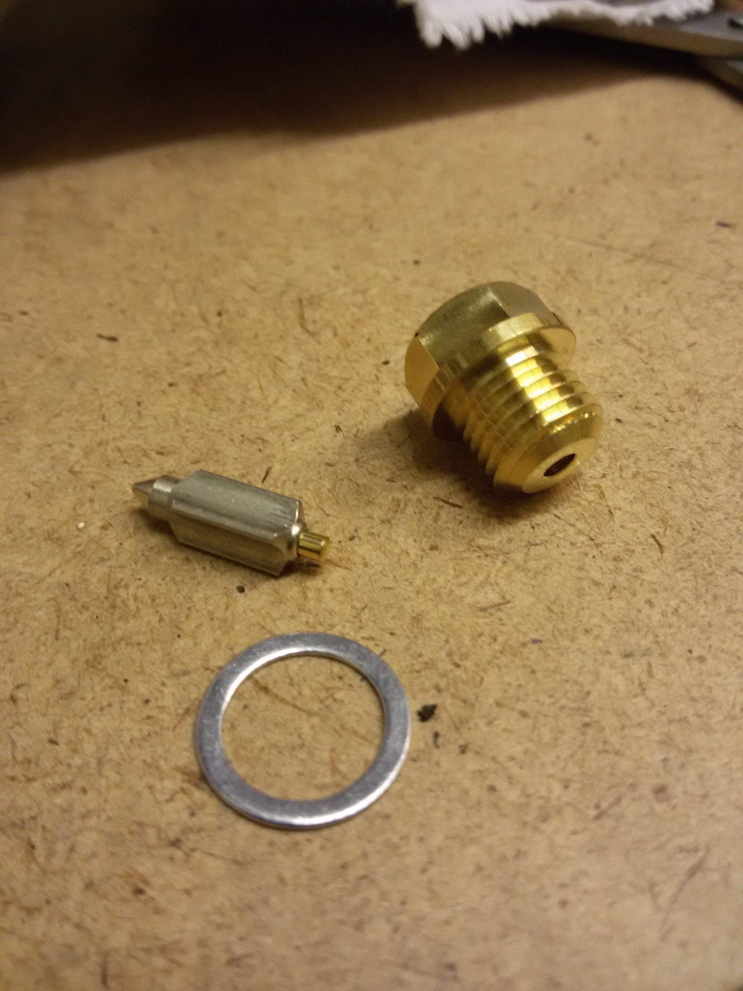

I will replace both seats and needles.
Altough i adjusted the tang the needle on the right side did escape and blockef the float open when i turned the carb back after adjusting to the 'upright' position.

I never replace needles and seats unless there is a problem. Yes, checking is simple. Install them (or bench check with an overhead tank) and see if they overflow. They somewhat commonly stick after a fresh carb rebuild, but tapping the bowl with a screwdriver handle should shake it loose. I always install drain hoses on the bowl overflows too 'cause once in a while the needles will stick for no evident reason especially if you forget to turn off the petcock.

I replaced the old seats and needles on both carbs...the seats seemes fine but i just wanted to sort out that these could cause trouble...
And then i found what you calles 'tang'...:-) i ' m a douche and now the float is nearly at the same lvl upside down and the other way around....
All the time i thoughy that the 'tongue' that touches the needle is solely responsible for the carb float lvl...i guess this is how i learn stuff....^^
