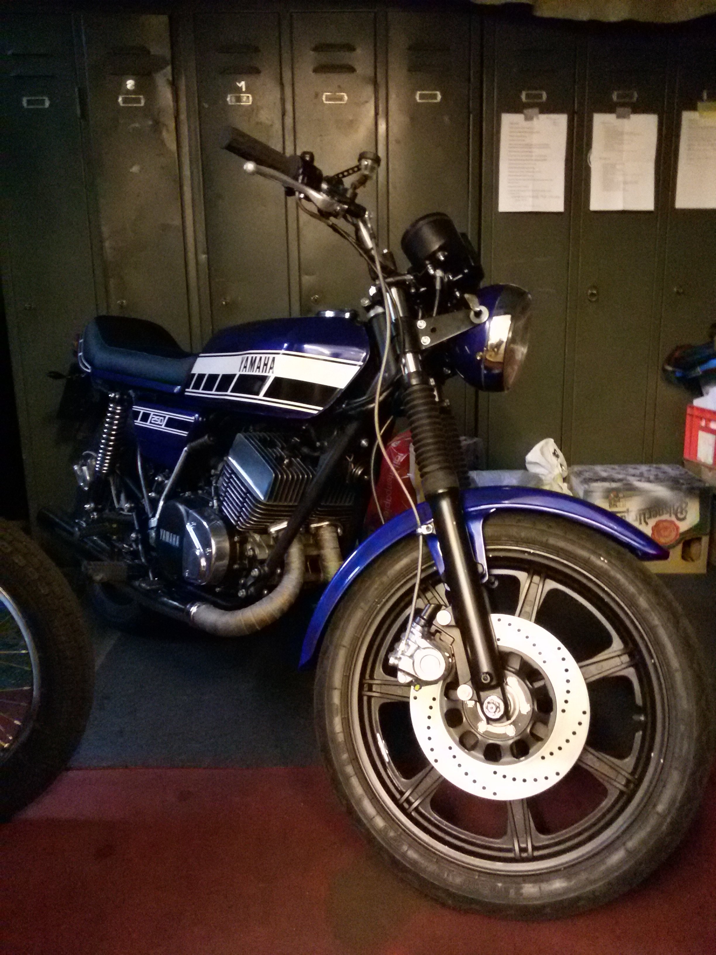

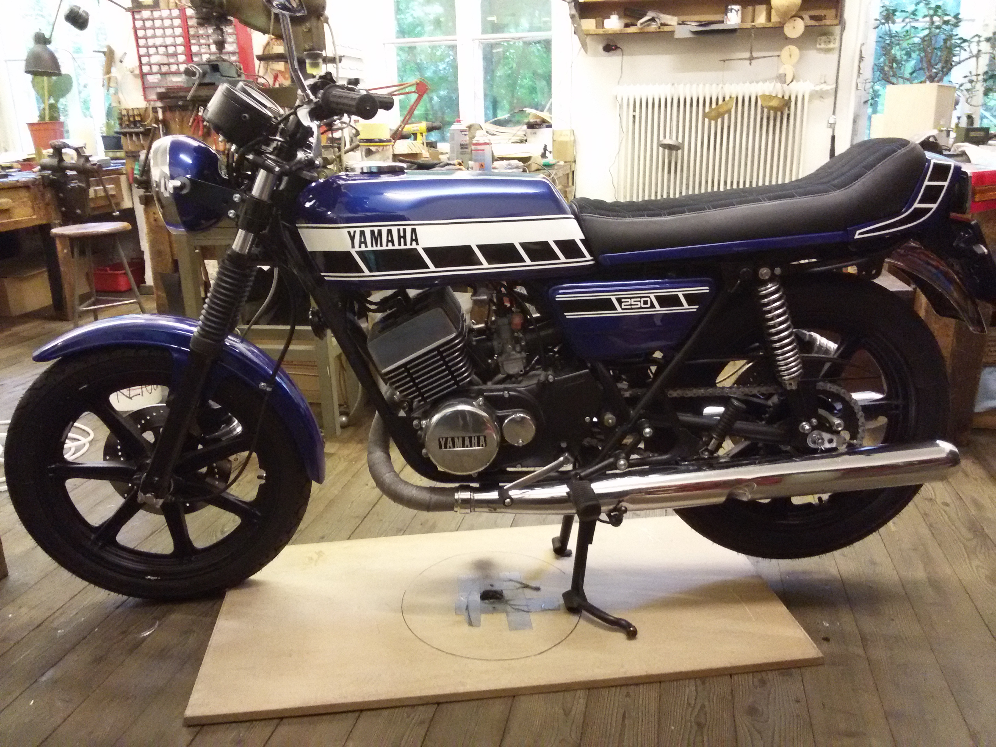

I'm so happy :-)

my bikes up for BOTM :-) yiiihaaa!

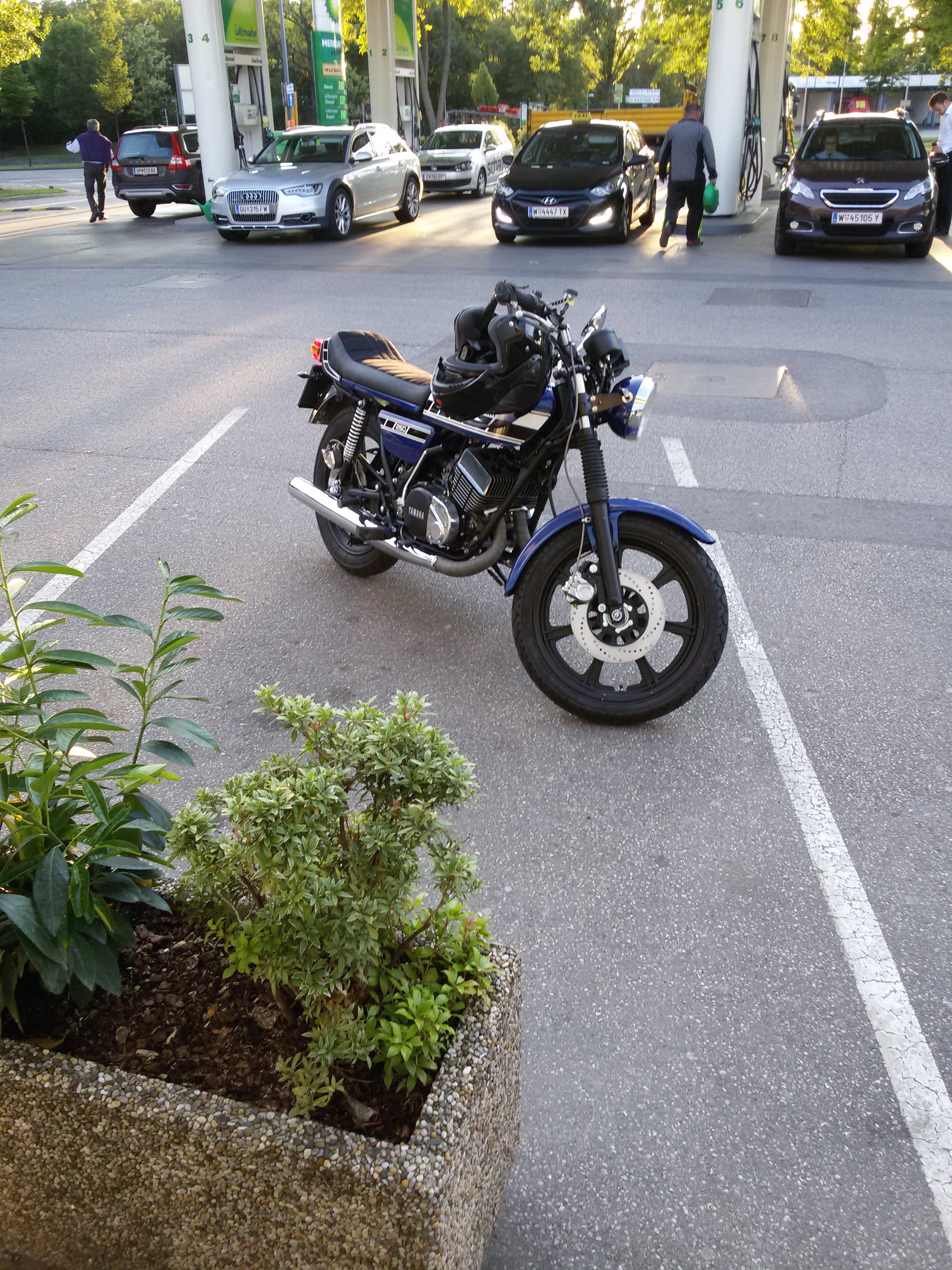

So i spooled a lot of kilometres the last weeks and started adjusting my carbs.
Firstly i raised the needle (dropping the clip from 2nd to 3rd from top position) in order to let it run a bit richer,cuz it surged a little at decelatering.
Now i have the problem that it trough this adjustement when i approach a traffic light and brake the motor sometimes just dies.
My guess is that running rich,turning the air screw out a bit would help with the problem.
I turned both it about 1/4 out,helped a bit,but this issue is still there mostly when the motor is hot.
Should i turn the air screw more out cuz i still lack air in the mixture?
